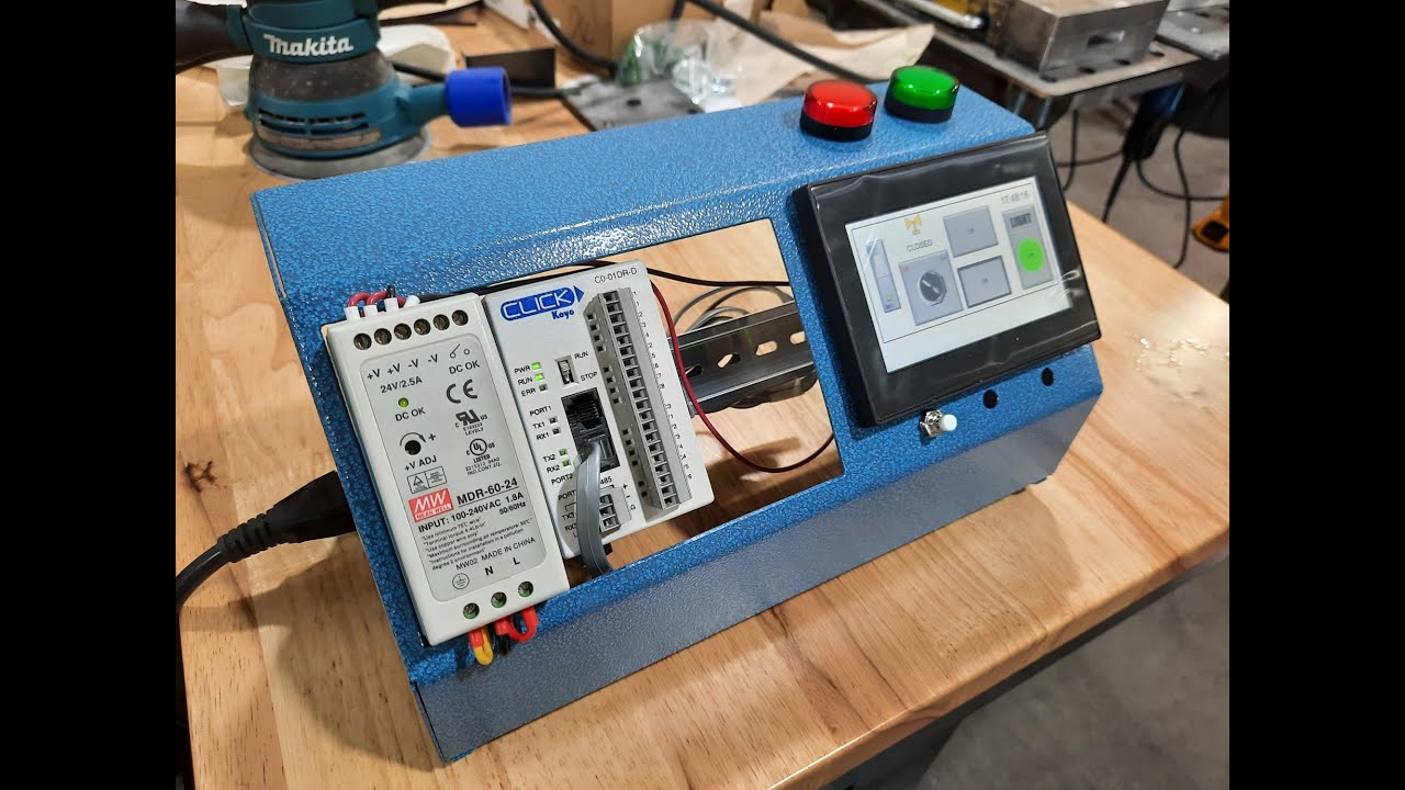

2 Minute PLC Enclosure Build
@holla2040 Thanks allot for taking the time to make the video. It’s great.

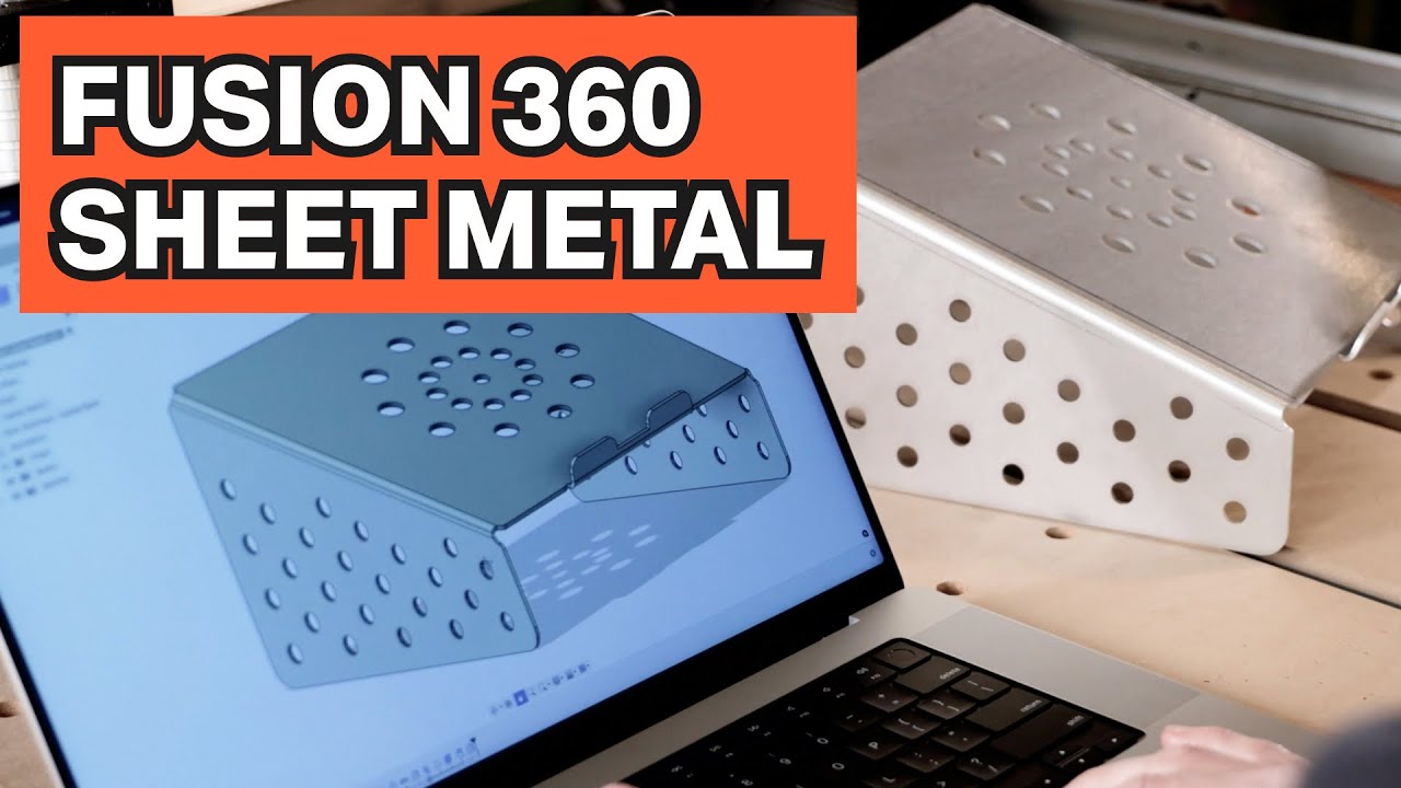

@DonP @TinWhisperer I’ve watched several Fusion sheet metal videos and found this one to be a direct match to what I needed (slanted front). It showed me to think about the first face selection.

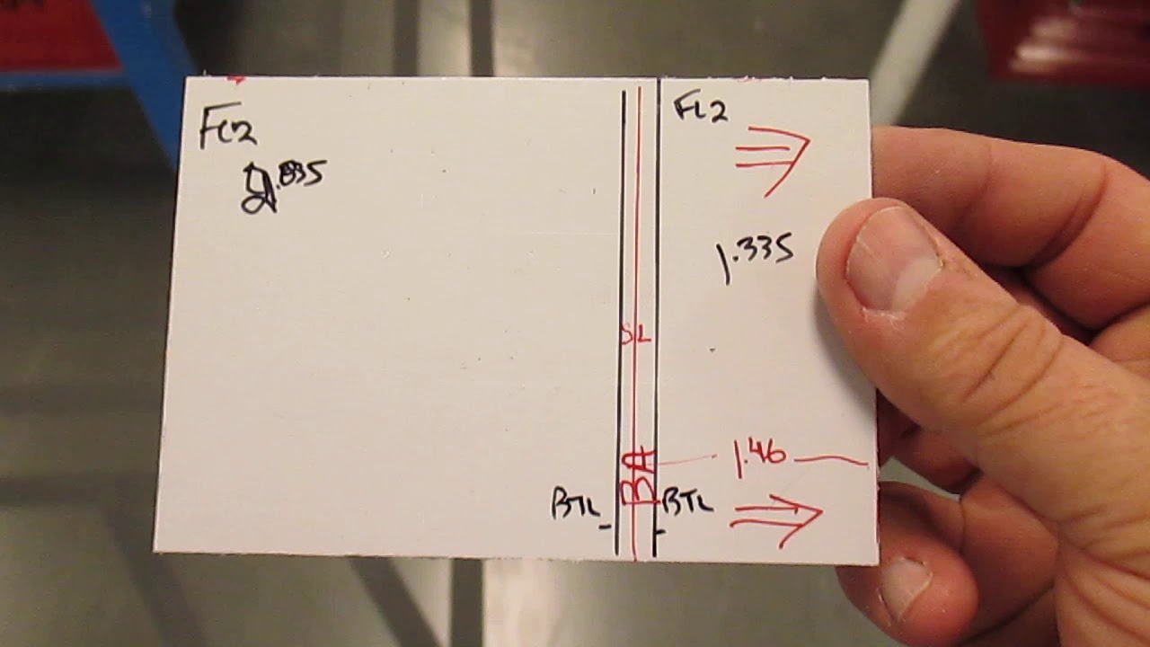

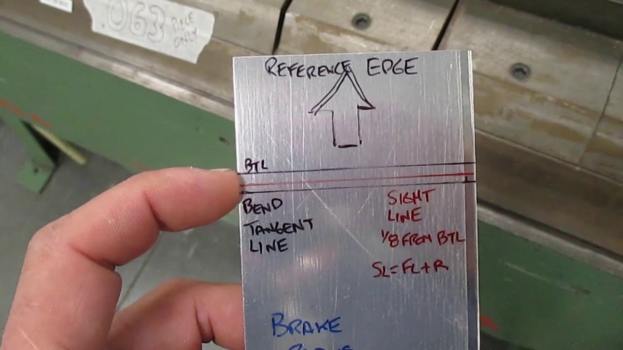

Here is great way to get your k factor…
Calculate K factor, bend allowance and Y factor for sheet metal bending | Gasparini Industries
I suspect those k factor calculators assume that set back is ideal. If you have a large setback you get a larger radius. I might have that backwards.

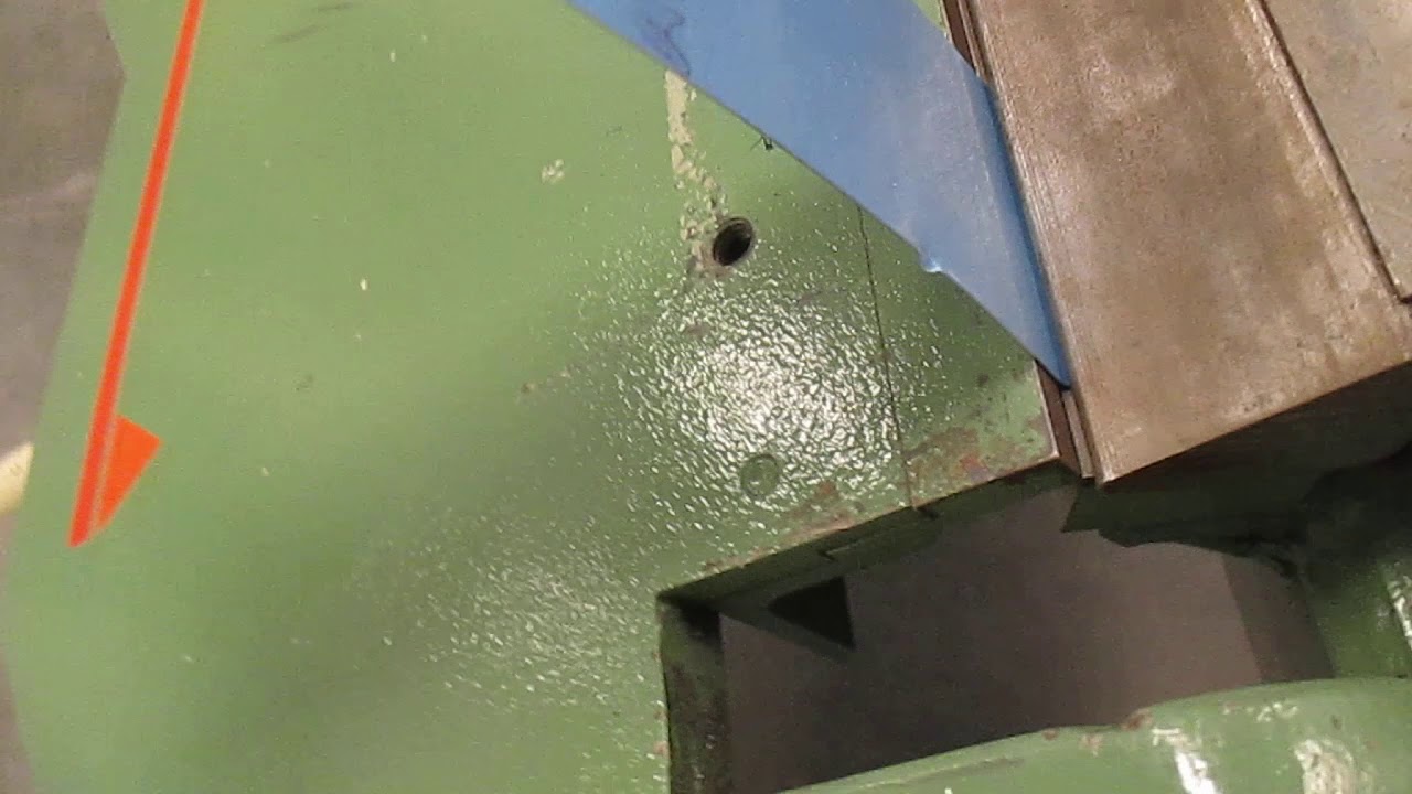

I just had to look up how to set my fingers on brake and the general rule sounds to be 2 thickness of the material your bending.
This video has a bunch of good information…
That’s what my brake manual says as well.
  1. Definitely you’ll want to set your setback according to the manual and the clamping pressure is also important which should be listed in your manual.
  2. 3.This is exactly the right question to be asking with a leaf break. On thinner material I do try to line up with the center line but depending on which part of the material is inside or outside of the break it’s going to bend that line slightly different. A leaf brake is not a press brake which is what all these bending allowances charts are designed for. A piece of metal does not deform the same way in a leaf brake as it does in a press brake.
When bending a pan uniformly on a leaf brake using the same line to break from you would either have to go around the whole pan and break all the flanges facing into the brake or brake the whole pan with the flanges facing out of the brake to have a result that’s uniform. If you’ve been some of the flanges with the body inside the brake and some of the flanges with the body outside of the brake the flanges would not come out to the same height.
  1. Again while you can get a bend allowance from a leaf brake it deforms the metal not uniformly like a press brake does. Cut a 4 inch long piece of metal bend it right at the 2 inch mark and then measure how long the flanges are. Once you know the flange length you’ll know how much material you gained when the metal stretched during braking.
The math for figuring out the k factor using the material difference while it bend test.

@holla2040 that product design online video you linked is really good. Product design online is probably one of the best resources for learning Fusion 360.

I watched this video and I feel like it was one of the most fact-filled videos I’ve seen on F360, as well as a lot of great tips on metal cutting.
