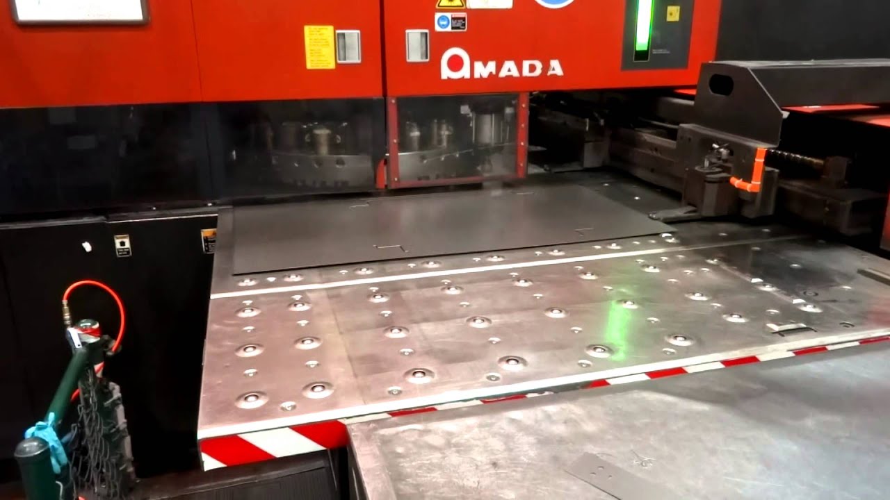

I agree, not plasma cut. My last startup had these in the shop.
Back then, I wasn’t into fab other than I knew what they were and what did in our production line. My job was system architecture, circuit design and software development.

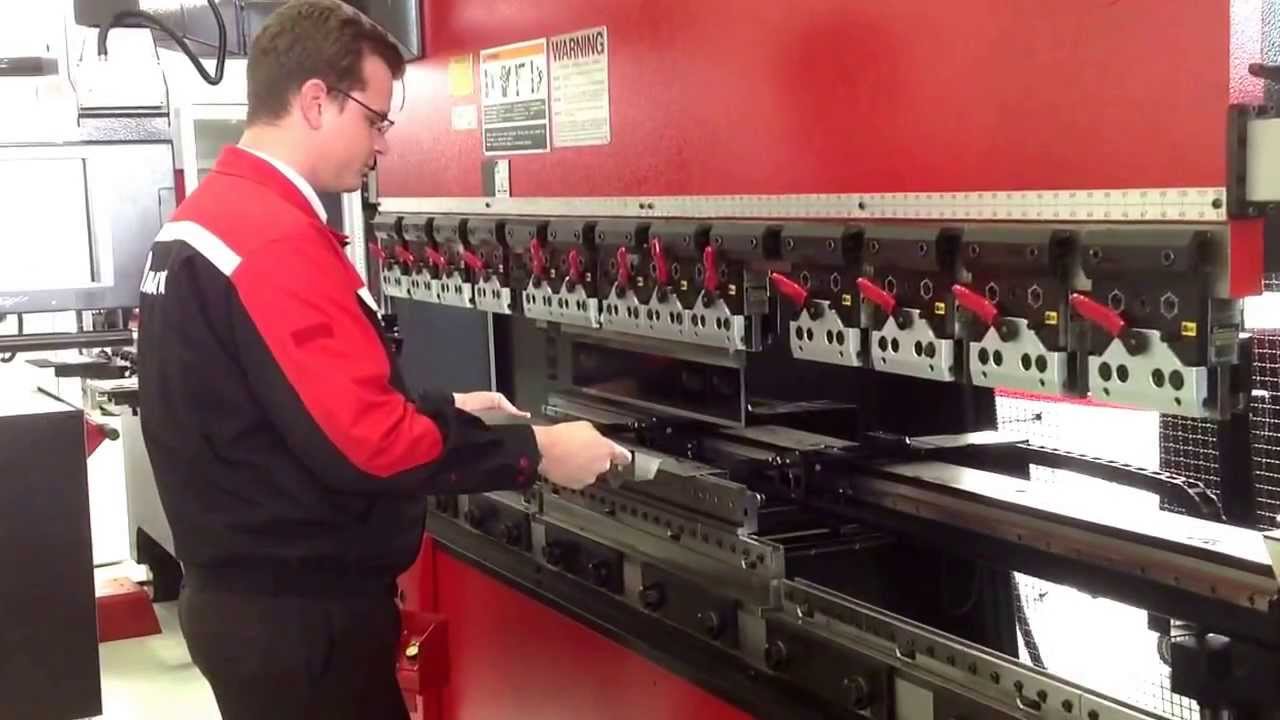

Maybe someday another 60 ton press brake will fall into your lap.
@72Pony & @toolboy -
Hypertherm 45xp with fine cut @ 40amps. 16ga book settings low speed 150ipm
cow roping - saw blade.dxf (339.8 KB)
I am looking at one on eBay but it’s a 70 ton 8’ and weighs 8,000.
The cost to move would probably be half of what they want for it.
It also got me thinking if my floor would hold it and then thought they also have to bring it in.
So now we have the 8,000 plus what ever the fork truck weighs. Not sure I want to take that gamble.

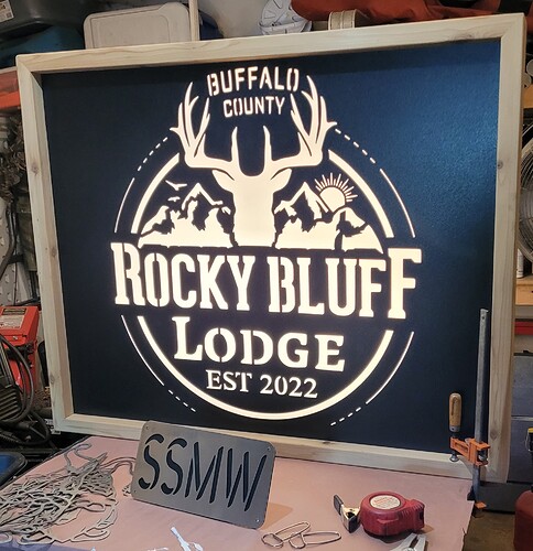

Delivered this one yesterday AM… This is intended to be backlit at some point with solar LED’s… The 16ga metal panel got 2 coats of bedliner… Starting to like that stuff for outdoor use!
I hadn’t thought about using bedliner on any of my signs…that sounds cool.
Hides a ton of sins too!! :rofl:

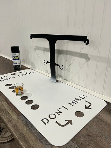

New backyard game for football season…
https://www.langmuirsystems.com/fireshare/ring-toss-game-shots
Lookin’ like a great way to share some delicious fall season apple cider!! :wink:
