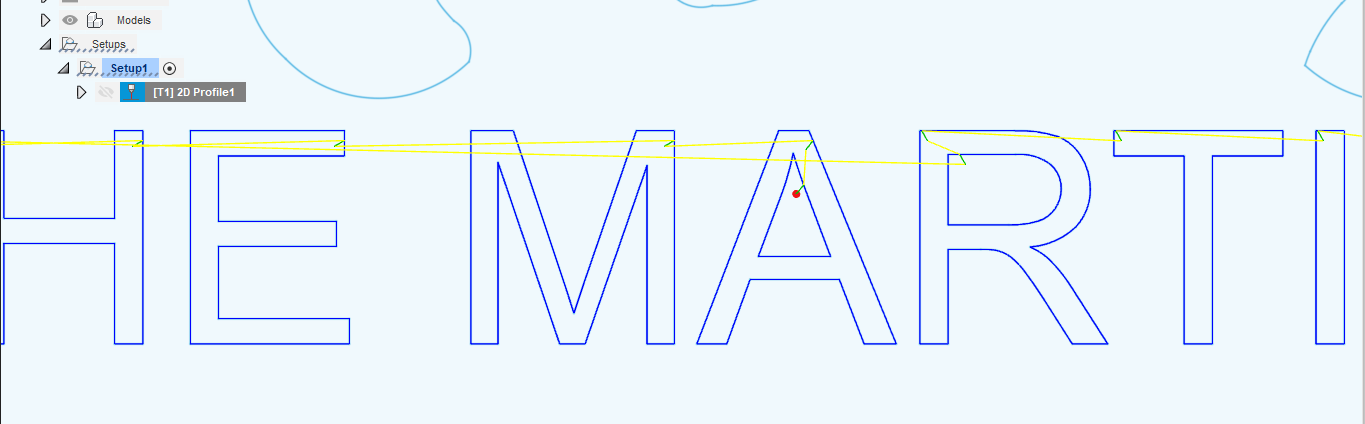

when i zoom in close there is no cut path to part of the letters? did I do something wrong to caused this?
You wont be able to cut those from inside.

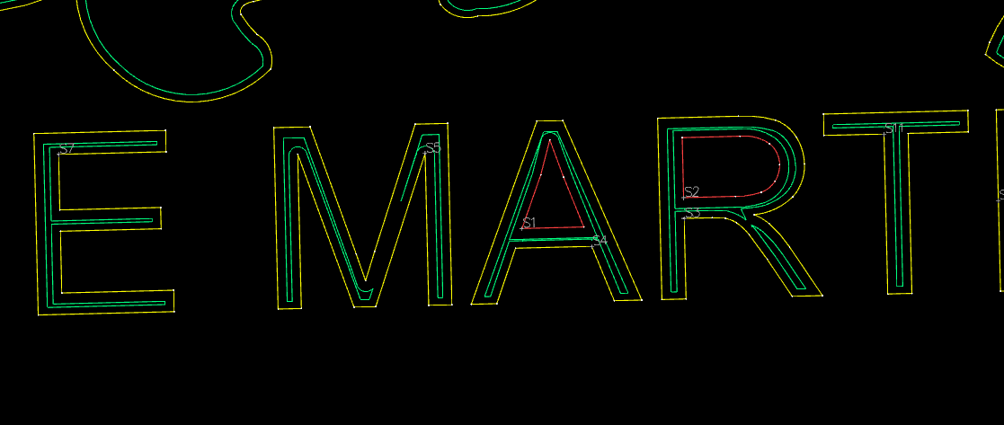

Here’s a screenshot of your file in sheetcam.

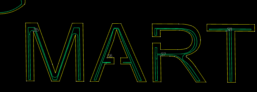

Here’s a screen shot with that M and R fixed.

And here’s the fixed file that will work with sheetcam or fusion.

I just opened the file in fusion and made the leg of the M the same width as the other side that it would cut and the R just got rid of that sharp turn in the leg.
