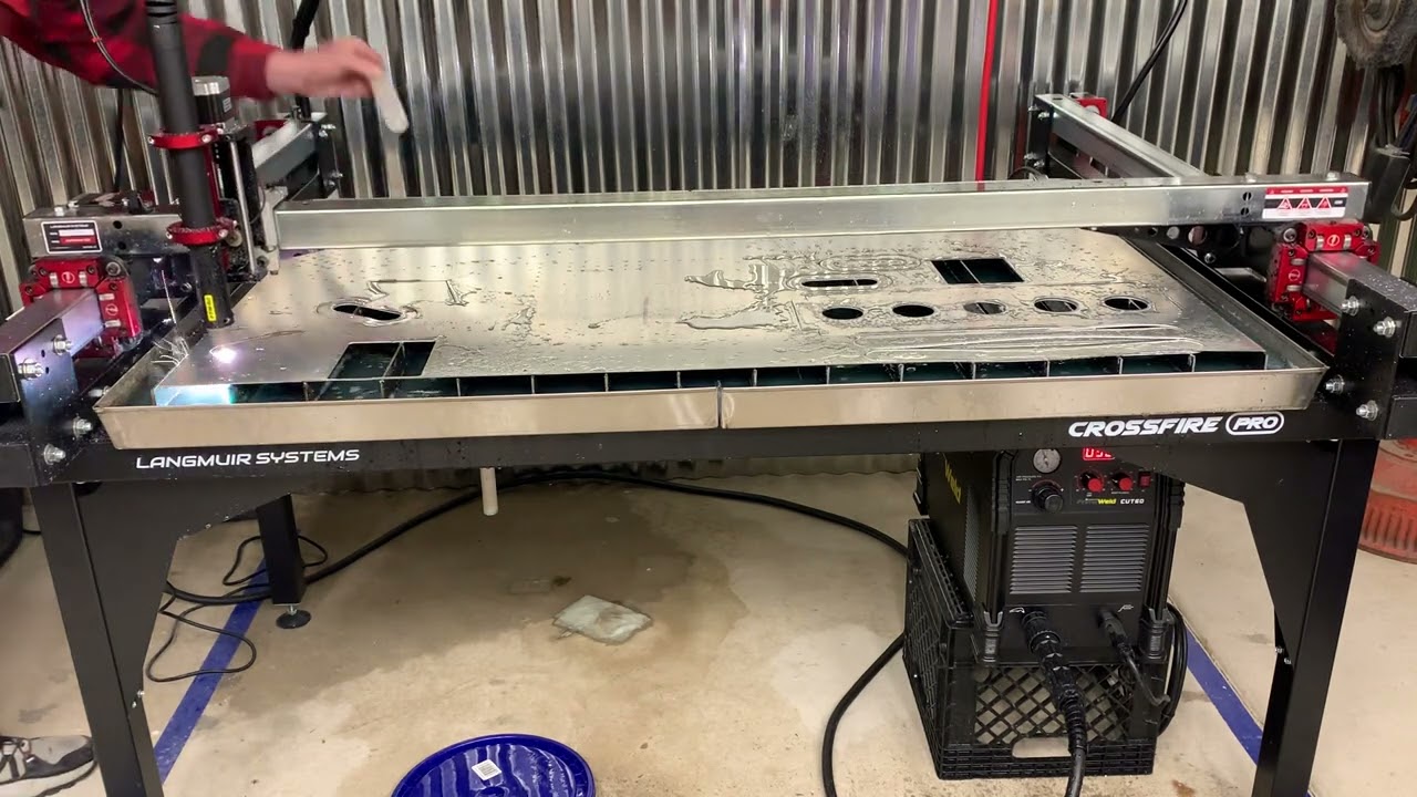

Here is a link to that last cut. The program finished, and then Fire Control completely freaked out and had to be restarted. :rofl:
I should probably just celebrate the victory that it is, but instead I feel like it’s a fluke.

@Phillipw, technically I’m on the second plasma cutter from Primeweld, now, and really, things are kind of behaving the same as they have been. Intermittent issues, and the THC has been plaguing me from the start, but under smart voltage it had been raising in the middle of cuts. Now that I’m trying to use nominal voltage, it’s not randomly raising on me, but this time it lowered randomly. And I didn’t even think about the IHS switch; it should have triggered immediately, right!? But FireControl was actively trying to drive the Z even further into the work even after I had shut everything down.
Did you see the screenshot? This was 10 minutes after I had shut everything down, and FireControl is still reading 102.4V “live” with THC active and moving down, but I was able to manually raise the Z and home the machine. It’s like it’s frozen, but not frozen.
And, I hadn’t realized this before, but I noticed during my line tests that the live voltage reading would freeze, but the program would continue, piercing and cutting; the live voltage reading just stays the same. And that means that the THC is NOT functioning anymore.
So, I’m not sure if this means that I’ve got an EMI issue that I’ve had all along, or if there’s something else going on, but I’m starting to think the common denominator is somewhere in FireControl or the THC.

Here are some observations that seem more and more relevant to my issues (some things I wrote off previously being unfamiliar with this system, and something I am still unsure of whether or not the are normal), and I have only recently started watching the computer and the cut at the same time.
RELEVANT OBSERVATIONS
  1. Often times after a program finishes I will still show live voltage and THC active lights, and those stay on screen until I turn off Fire Control.
  2. A couple of times I have watched live voltage stop fluctuating in the middle of a cut and it will “freeze” and continue to read the exact same xxx.x volts through the rest of the cut and after the program finishes.
  3. If I manually jog my torch up and down far enough, it will crash (either into its own bracket or the work) and the IHS doesn’t interrupt the travel. I haven’t sat there and held the button down, but I have definitely had an “oops” moment, because it does not behave the same as under “initial height sensing”.
  4. If I restart fire control without homing my machine it will allow me to jog into a hard stop. It seems to lose its position if it is not homed when FireControl opens.
  5. Once, during a rapid move, FireControl had an error that it lost its position, but I think that may have been because a motor coupler slipped.
  6. I am on my second plasma cutter that has had the live voltage freezing error and issues with THC behaving strangely. Both have been wired via CNC (CPC?) port to divided voltage.* The VIM box is mounted via Velcro tape to the bottom of the back rail of the plasma table, and the wires are zip-tied to the rail in the same vicinity as the far Y-axis motor’s wires.
  7. My laptop is a brand new Asus (cheap) unit from Best Buy. I have only had it charging while running FireControl one time and I had a massive crash, but these other issues have happened when not charging. It is always connected to the internet.
  8. Typically the only things I have running during plasma are lights (led and fluorescent), my compressor, and I have a bank of Dewalt batteries on chargers that are always plugged in. The service panel, and ground rod are about 30 feet from the electronics enclosure.
*I am not a great solderer, and have wondered if I did a good enough job soldering those tiny little wires for the divided voltage to the CNC (CPC?) plug provided by Primeweld. It was definitely connected, but just a bit more globby than I would have like it to have been, but I did use a shrink tubing to isolate the connection. I’m probably introducing too much doubt with this comment, and I have run the THC setup process multiple times, and Fire Control was happy with all of the readings during the setup procedure.
Did I miss anything?

ONE MORE THING!! Huge revelation (I think).
The voltage spike was not an error!
Where my voltage spiked (that started the crash cycle) was where I had a 60% feed optimization factor programmed into my cut. And I have torch speed cutoff set at 85%. So the fact that voltage went from 87 to 102.4 was to be expected, but the THC should have been locked out due to the speed cutoff.
And come to think of it, every time the torch has raised suddenly on me when using smart voltage has been on inside geometry, and I’ve been using 60% feed optimization and 85% torch speed cutoff since the second cut, so THC is doing things when it should be disabled.
This definitely points more to a FireControl or THC issue than the plasma cutter.
The freezing of FireControl screams electro magnetic interference.
