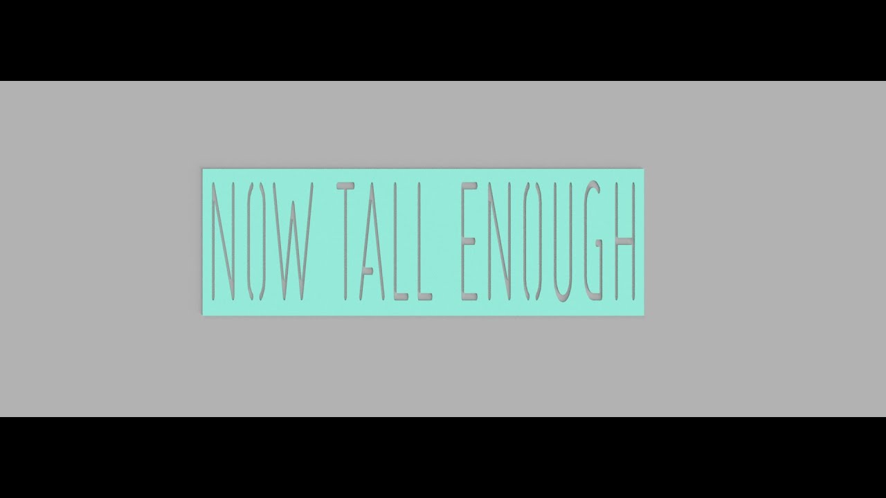

Autodesk Fusion Non-Uniform scaling tool as used with plasma cut sign text
I made a short video that I think may address this topic from @Kingranch1977
Using fusion 360 im having trouble getting the text taller but not wider
see if you find it helpful
TALL TEXT TOPIC FORUM v1.f3d (1016.4 KB)
attached is also the Fusion file from the video

Like BigDaddy said, you are a natural teacher. I really liked how you showed where scaling won’t work in the sketch but once it is a body, it behaves differently. Then you performed magic by using time-travel to change the words.
Once again, I learned something that I didn’t expect to learn.
