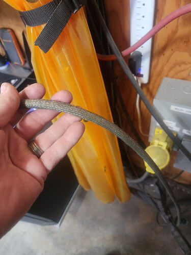

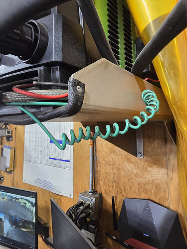

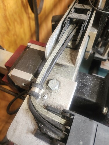

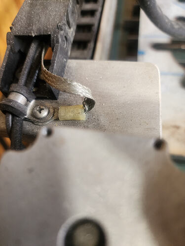

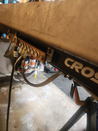

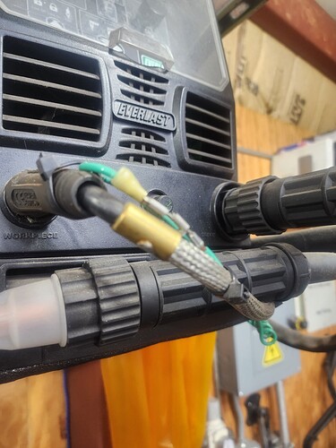

EMI:
This guy really made quite the system to get rid of his EMI:
I did buy the “bullet-proof” device @Bigdaddy2166 recommends:
I can’t say if the device worked, but it didn’t hurt. I feel like it added another 0.05 seconds required with my pierce delay…but that is anecdotal…not confirmed.
I’m not fully sold on $58 consumables yet. You may try hooking up an isolated ground to the plasma cutter case. I would create a makeshift Faraday cage. My Everlast has a grounding screw on the rear to stop EMI. I’m sure you have checked the table frame to the control box. I have an elaborate isolated ground on my machines. They all operate without any issues.
