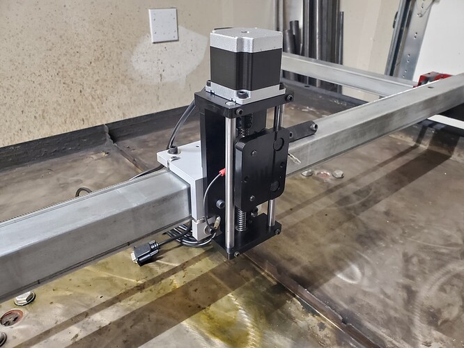

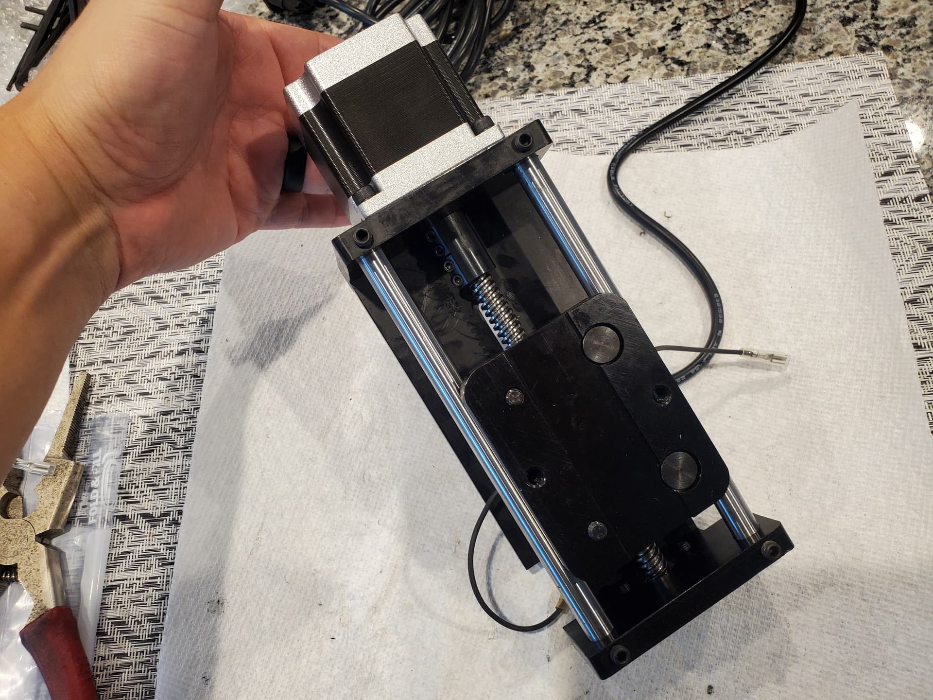

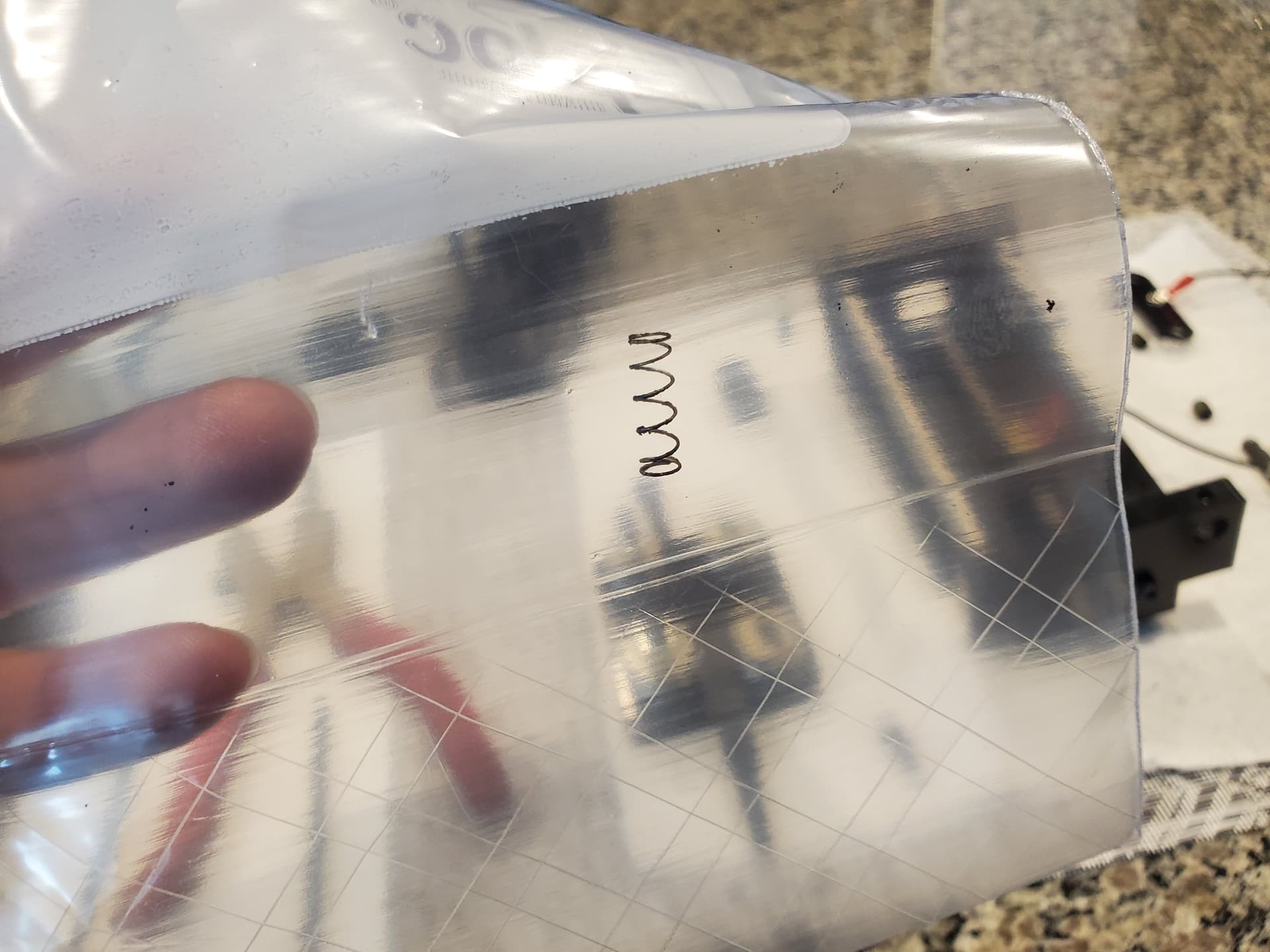

I’m coming here to seek the “best” route to disassemble and reassemble my Z axis assembly.
Should I remove the adjustable eccentric bearings to remove the mount from the assembly, or remove the set screws holding the guide rods and take things apart that way?
The assembly is super simple, and I’m mechanically inclined, just asking in case one method is better than the other.
I’ll be placing it inside a zip lock bag so I capture my spring.
If you’re wondering “why am I doing this?”

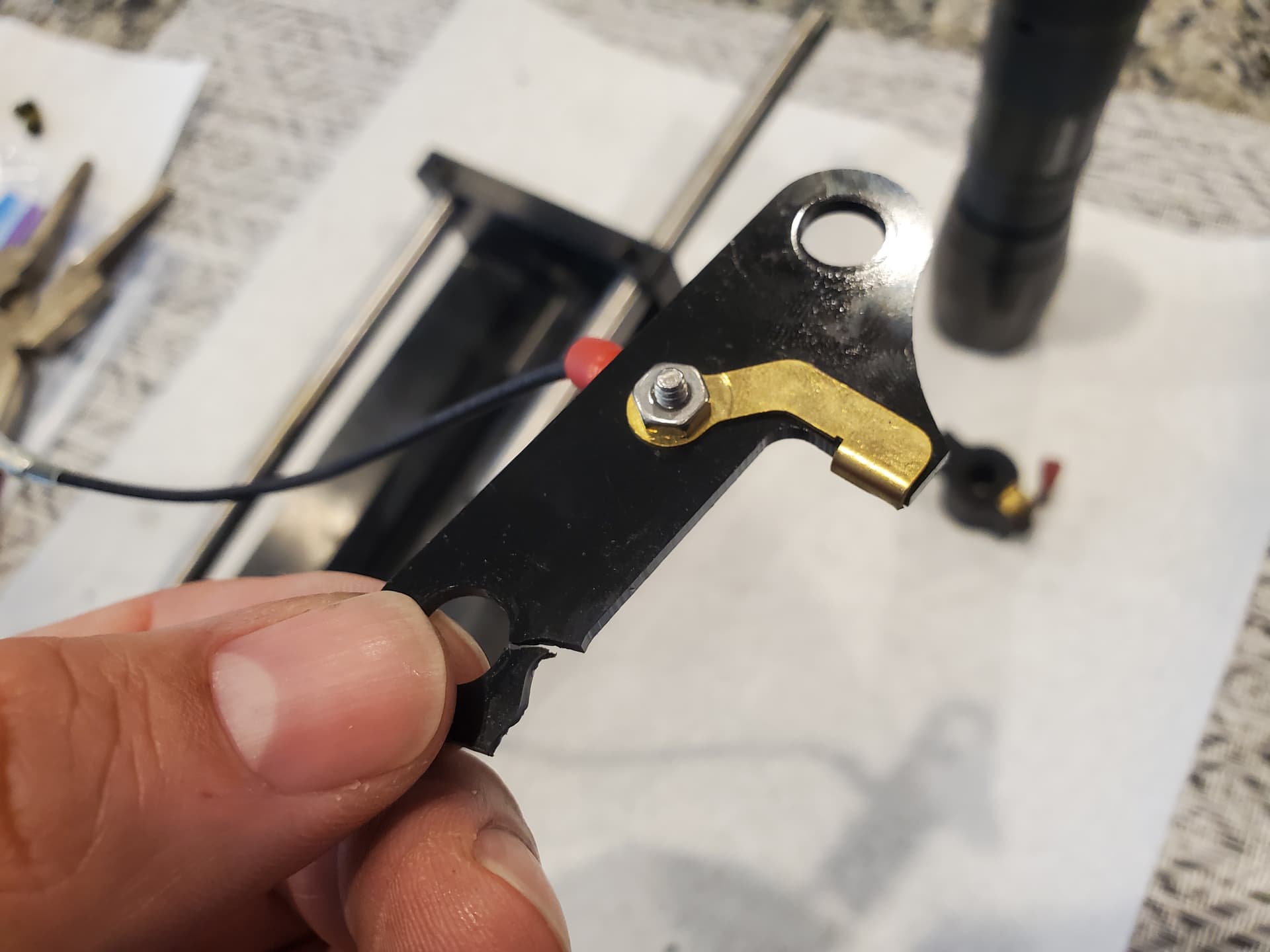

I reached out to support to request a parts invoice for any parts needed to rebuild my “z axis assembly”. It was sort of sticking, and no it’s not a lead screw issue or coupler. So they opted to send a new one.
Problem is, the plastic tab holding the IHS spring broke. I got the “go ahead” yesterday to disassemble it and swap parts over as needed.
Support is and always has been crazy helpful.
They’re also sending a replacement, and not leaving me stuck with a broken one. Huge credit to Johnny for going above and beyond to help rectify this ordeal.
I even reached back to offer to cover shipping or any other costs and he said “they got it”.

I would follow the guide and remove the rods, then you have complete access.

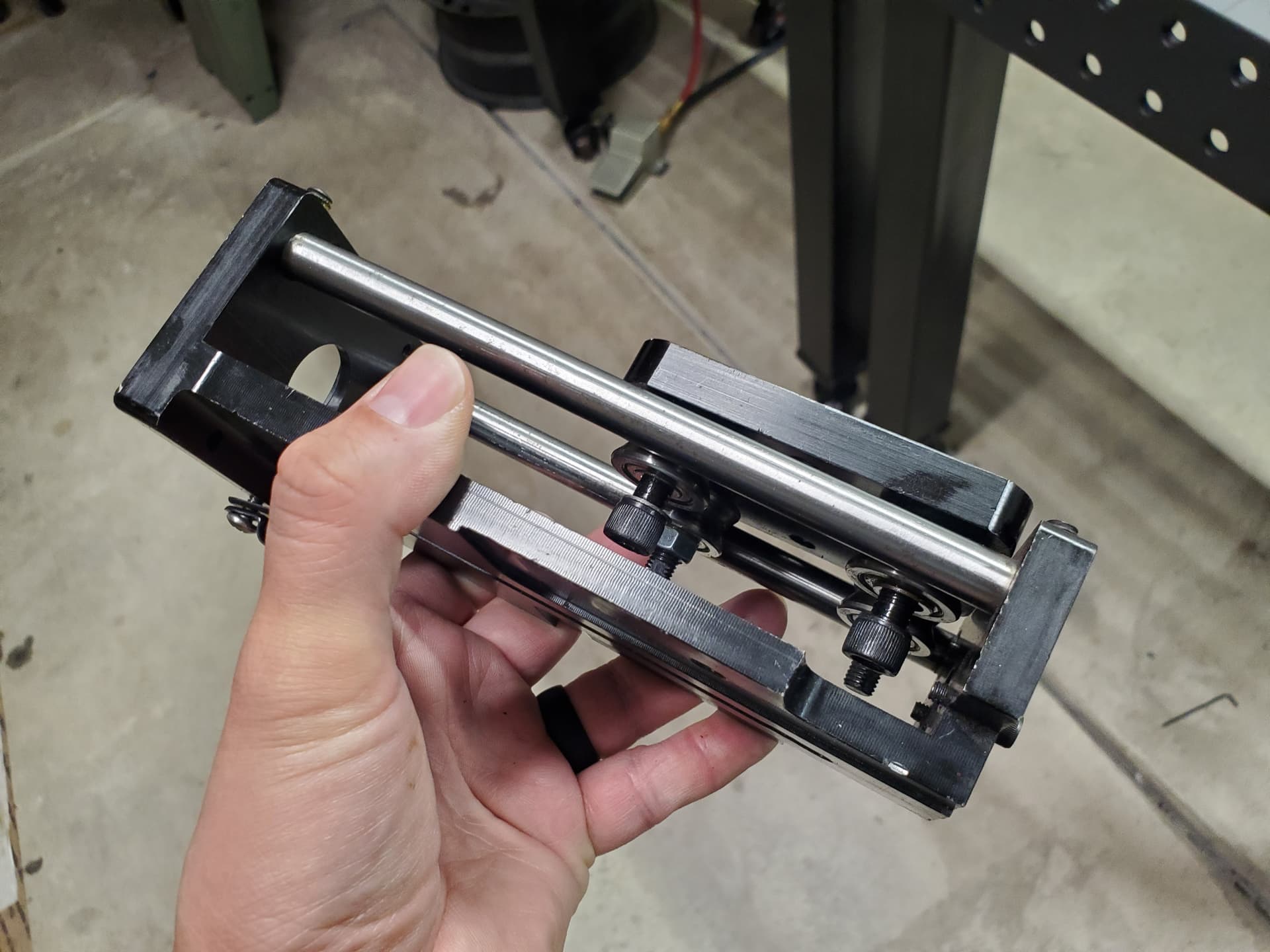

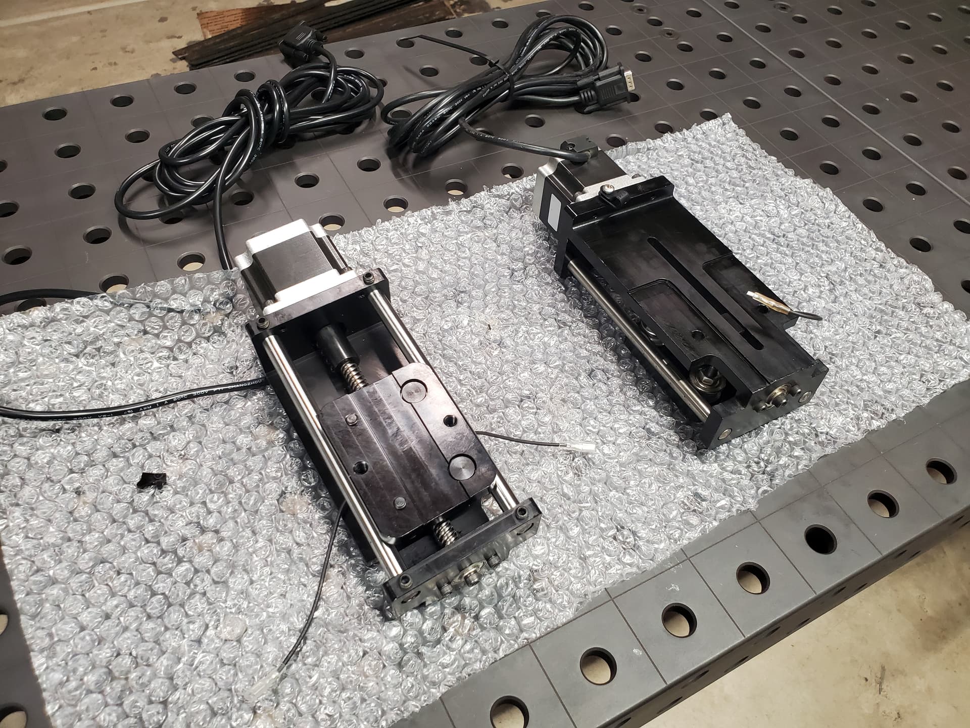

The broken part from the new assembly; removing the fully intact piece from my old assembly.
I’ve rebuilt a lot of vehicle parts, and one thing about manual hubs is you’ve got a ball and detent spring on many hub dials.
Anytime I would disassemble them, I placed them in a zip lock bag before taking them apart. Doing this for my Z axis assembly helped me to catch my spring.
Just blows my mind how so many people lose this spring, but then again I can’t assume others have experience taking shit apart either.
That was not shenanigans, that was an organ transplant.
Autopsy is complete disassembly to see how it works and all the parts.
Shenanigans is mix and match random unrelated things from your shop to make it work.
Was super quick and simple.
Installed.

The old setup.

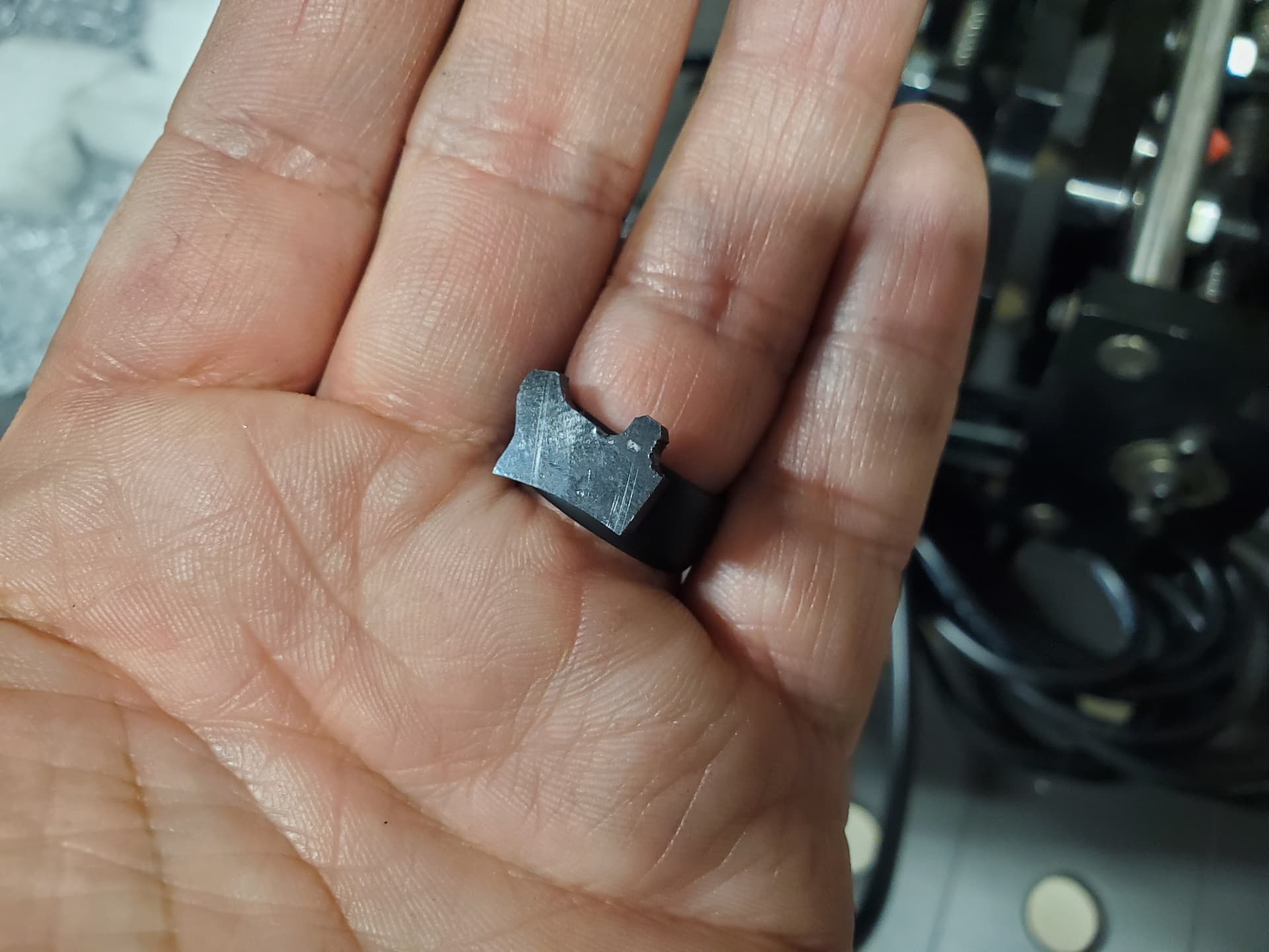

I noticed some crud in this threaded part.
A tiny bit of it looked like plastic as if the threads were slightly stripped.
I made it a point to never crash my Z axis, or any axis for that matter as I just cringe whenever I see/hear others do it.
So I was surprised to see it like that on my own setup.
Put a flat on the lead screw and drill and tap the coupler for a set screw to bite down on flat.
The smart me would’ve done that.
I never went to college so I skipped doing that :rofl:
Shoot, I may just have to do that later.

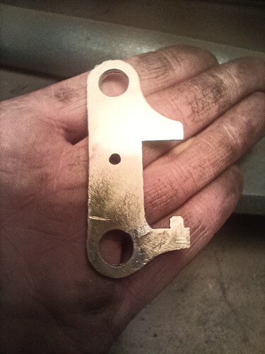

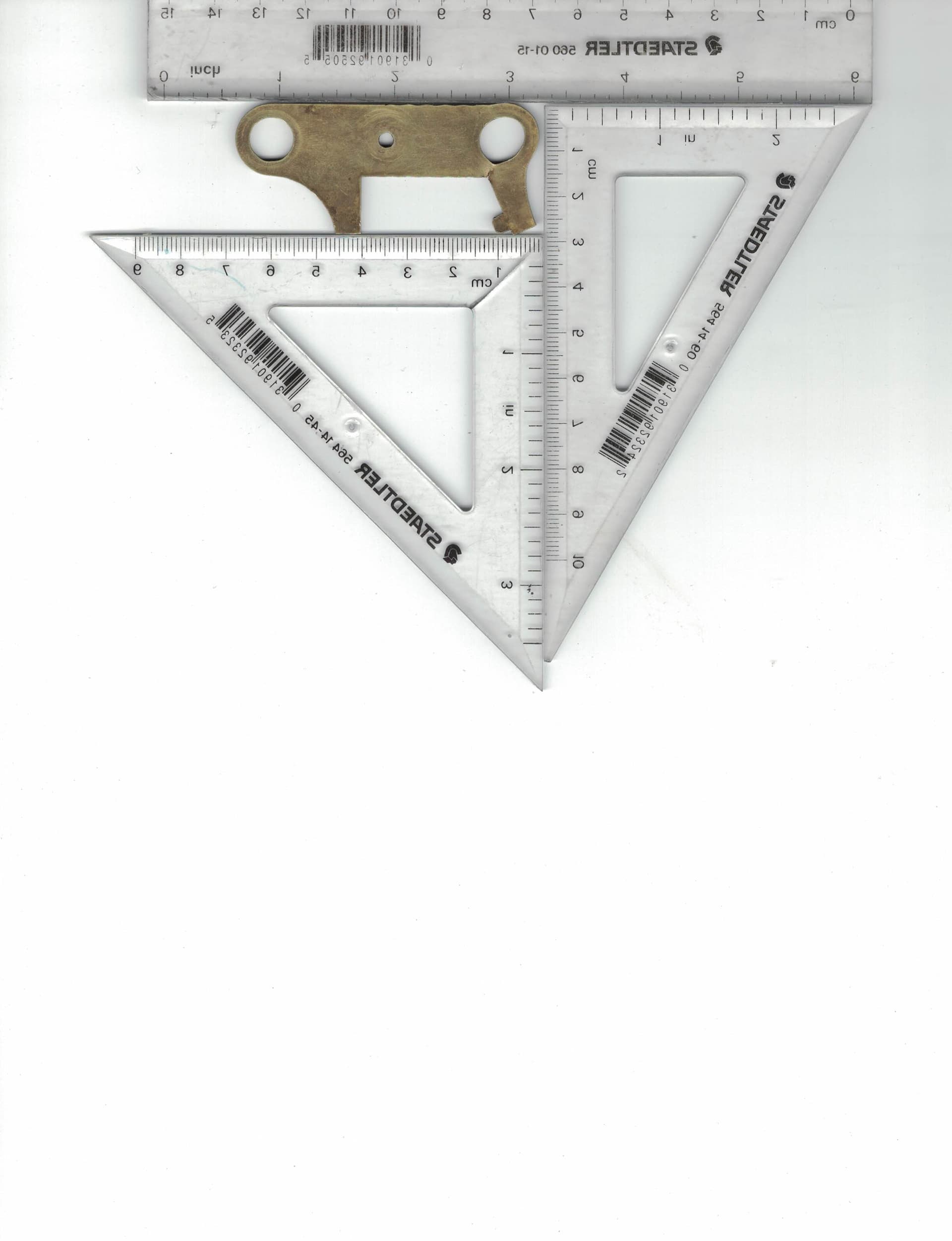

Looks like they’ve changed this assembly since the beginning.

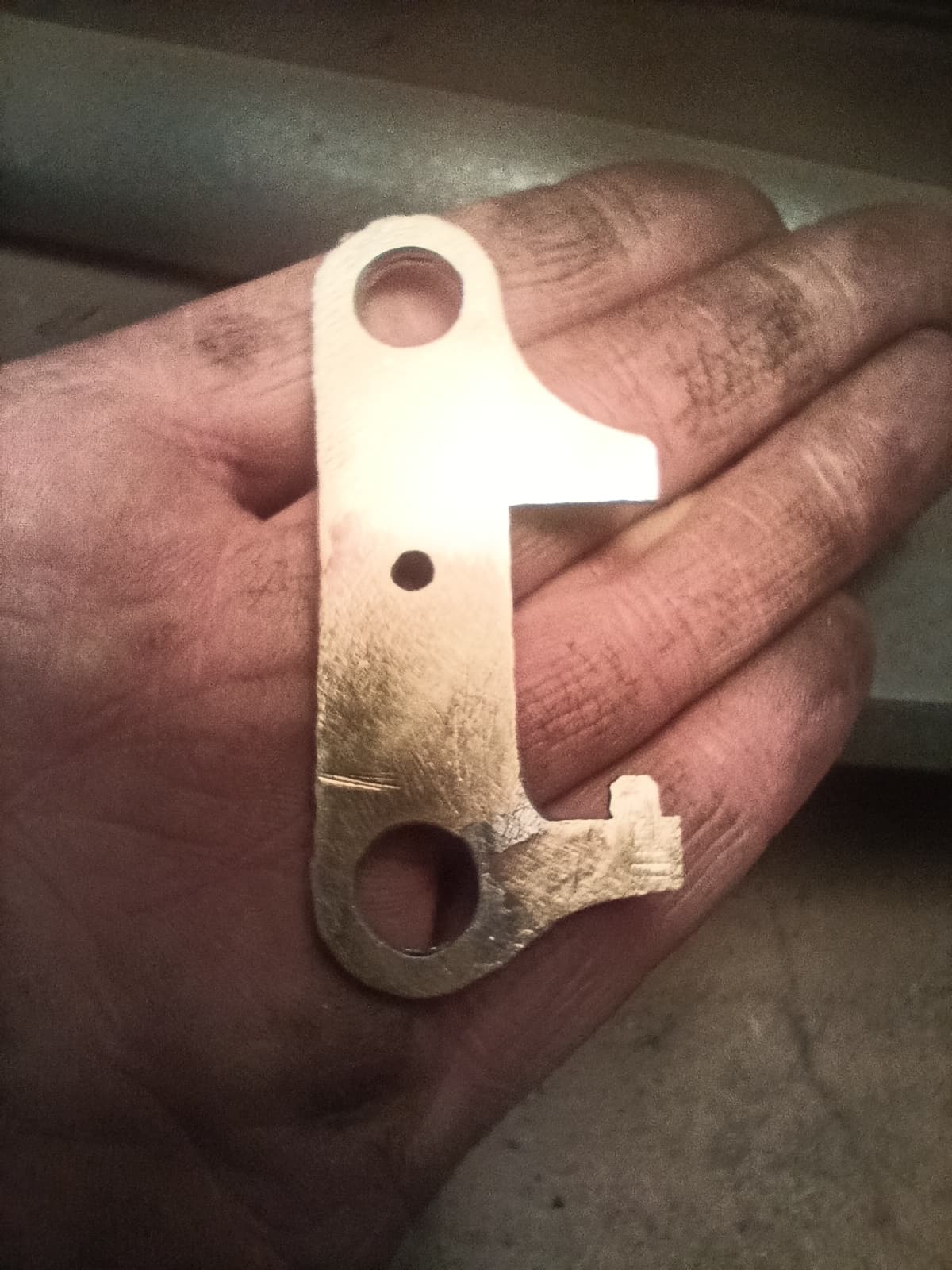

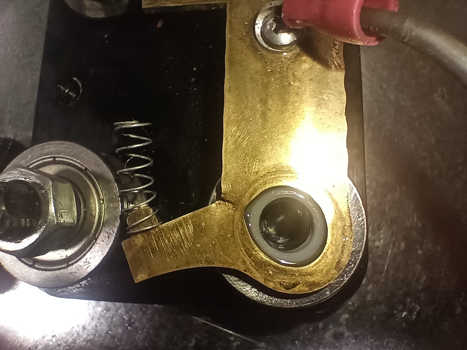

I had a similar problem back in March of 2021 with my z-axis assembly.

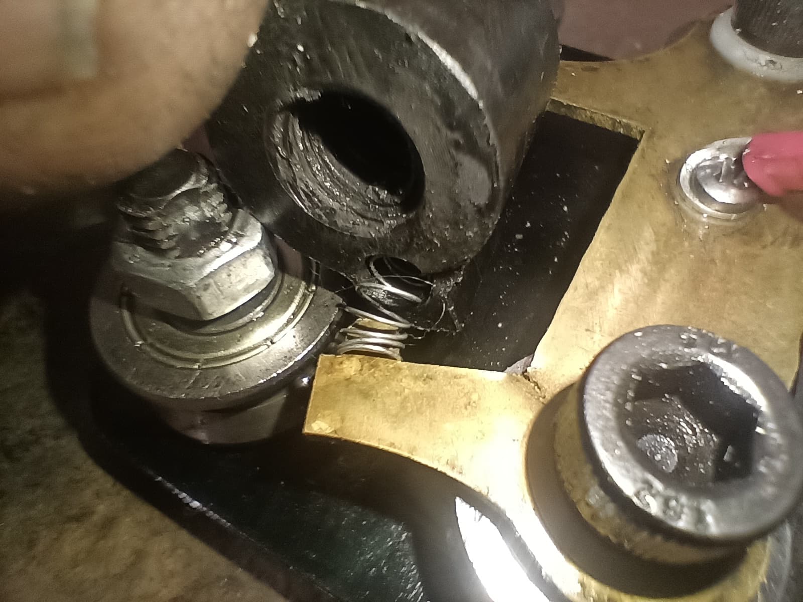

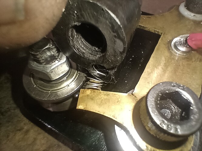

Back then though that piece was copper. I beat it back into place silver soldered it up and waited for my replacement from Langmuir .

I noticed that in the PDF @ChelanJim provided!
Mine’s plastic hence why it was broken; well not why it was broken, but the reason why it was possible for it to break.
