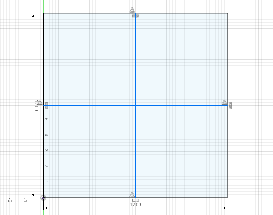

Not sure where you want me to start but lets just do a mock up. I first make a 12 x 12 square. Then I place two lines at the midpoint and cross in the center. All of the holes will live somewhere on those lines:
I want the center lines to be construction so I select one, then hold [CTRL] and select the other:
Both lines are selected so I hit “x”. The “x” will switch the line from construction to/from regular:
Now I make the center hole 1.5 inches, easy enough. For the 3/8" holes I will make one hole in the top and then make a “circular pattern” of 4 to make the other 3.
Extrude the body and then go to Manufacturing in Fusion 360 or just use the sketch for SheetCAM.
Once you get to the table, import your gcode file and set whatever will be your program origin.
Now put the torch on table that will correspond to the location on the metal in which you want the corner of the sketch to be represented.
That’s it.
