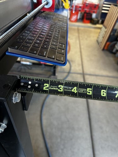

Keyboard and mouse tray complete. Need to drill new holes to lower it 0.5" to have the transmission clear the keyboard. Oopsy.
69533092-CA9B-44F6-B8F0-3F43513BC794_4_5005_c
https://www.langmuirsystems.com/fireshare/apple-keyboard-mouse-tray-for-cfp-v2-razorweld-cut-45-11ga
