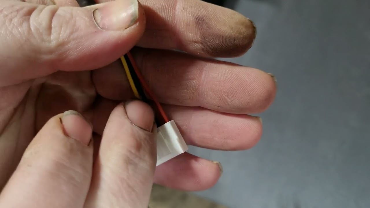

Just adding in here for reference, i posted the videos on Facebook earlier. Im running the RW45, resistor mod done, and table runs fine on dry run. Once the torch fires, it throws a hard limit alarm during the first or second pierce. Blade connectors are tight, and firmware was installed last night around 4pm.

I have an older hypertherm powermax 30 same deal as RRyerson., but I have not reinstaled firmware since Saturday night, mine fires once then quits. Worked fine on dry run.

Just published the latest version of the firmware. Please update machine firmware from the FireControl Help menu and give this another run.

Will try tomorrow to cold tonight. UPDATE UPDATE updated firmware today and everything is working great. Thanks to everyone for fixing this quickly, this is why I bought, and would reccomend Langmuirsystems, also this forum is a great asset. Thank you all again. Merry Christmas.
@langmuirsystems the new firmware update solved all the issues, thank you for working so hard on it guys.
Another successful test!! Thanks for the prompt update guys!!
