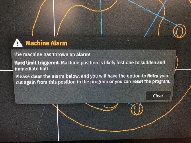

Now I have been having issues with FireControl freezing after it does the initial height touch on the material. Doesn’t seem to happen if I disable the limit switches
Im having the same problem with program stopping right after it moves to pierce hieght, almost like it wont reconize the M3 code to fire the torch. I am also having a problem of the software puting a soft limit on my z axis(where ever my z is located when i turn on the machine that is the highest it will let the z travel). All problems stop if i disable the limit switches. I have updated the machine firmware and I am running version 21.1.5

Updating the Machine Firmware from the Help Menu once more will resolve the issue with the Z-Axis Soft limits. There is no need to ‘Reset Defaults’ again if your Homing is working as expected.

@langmuirsystems I did a test cut after reinstalling the machine firmware and it did fix the issue with the z axis limit but I’m still am running into the problem of the machine stopping on the M3 at the begining of my programs. Below have attached the error code that comes up when the machine stops
We are looking into this- It may take us until tomorrow to get back to you. Sorry for the trouble!

We’ve been looking at and test this issue all day and are able to successfully cut and run our test Crossfire and Pro machines with limits. That said we are releasing one more minor update to the firmware in case this is causing your issues. Please update your Machine Firmware one more time to receive it (there is no new version number).
In addition, we have noticed that with some strain the blade connectors of the limits can pull out of their connectors but not from the plastic sleeve. This can cause no issues if there is enough connection to keep the circuit closed but can cause phantom limit triggers. Please make sure they look like the below.
As a potential last option, can you provide some more information about the state of the plasma cutter at the time the limit switch is being triggered. Does the same trigger occur with the plasma cutter powered off (and THC)?

@langmuirsystems I reinstalled the firmware and checked my limit switch connectors as you stated in the last message but i am still have the same problem. It seems the m3 code is working as it should(the relay is clicking in the controller) but the torch wont fire with the limit switches enabled. I did a test with the plasma powered off and the program started like normal even with the limit switches enabled. As you can see on the pictures below i did recieve a error message i didnt get yesterday. Possibly the thc or plasma affecting the limit switches?
(The code was recieved when the plasma was powered on)
I am using a prime weld cut 60 by the way
Just confirming: this limit hit (and subsequent alarm state) only occurs with the plasma on? This points to noise in the system causing these triggers. Is your Primeweld one of the newer style Cut 60s?
