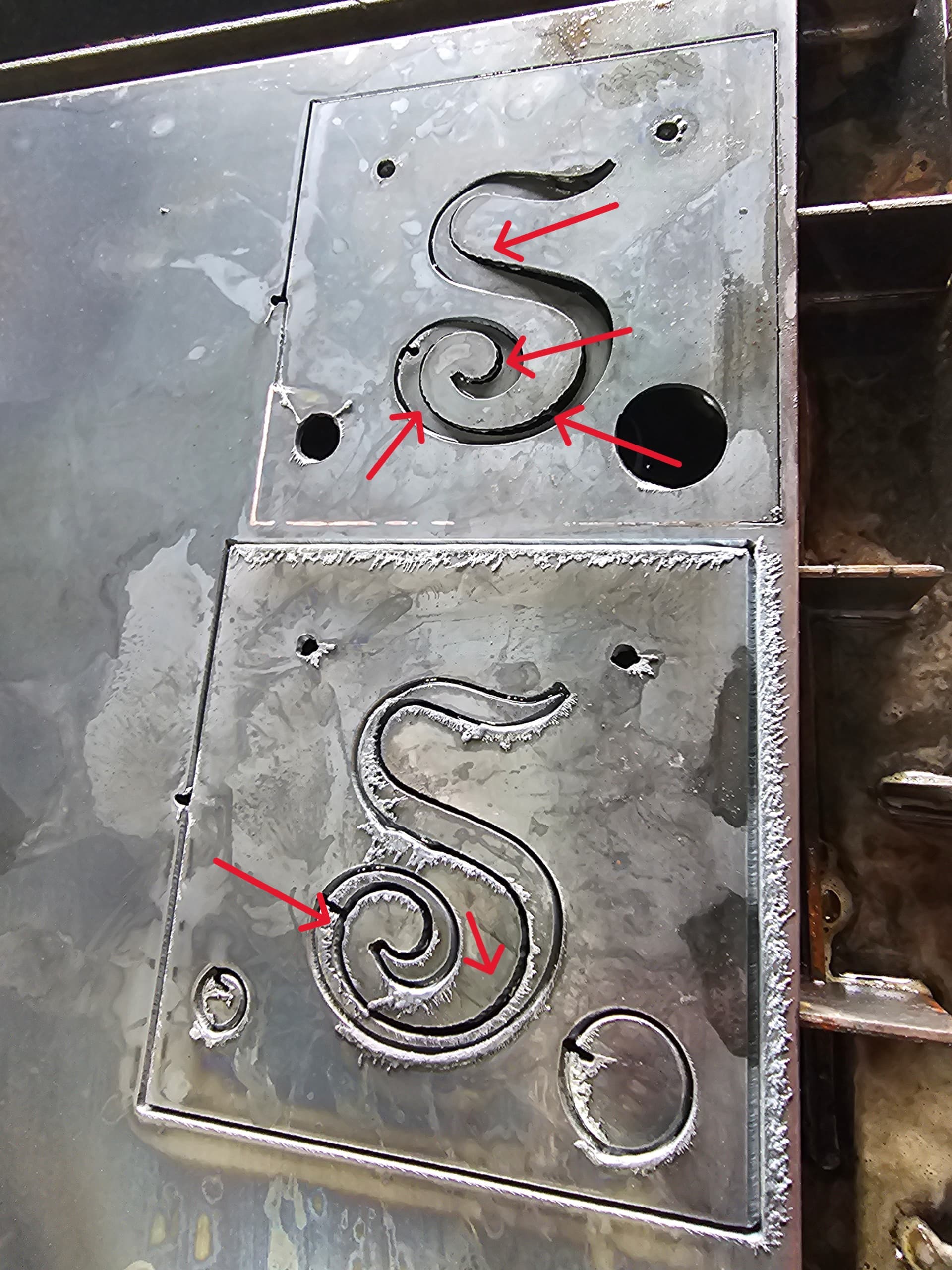

@TinWhisperer i see what you mean, but you’d have to see the cut we made with my test file to see why I’m looking at it the way I am. When I said earlier it cut ok; there was just one spot that maybe needed the dross knocked off to see if it was smooth. There was no saw tooth anywhere, and the whole thing cut.

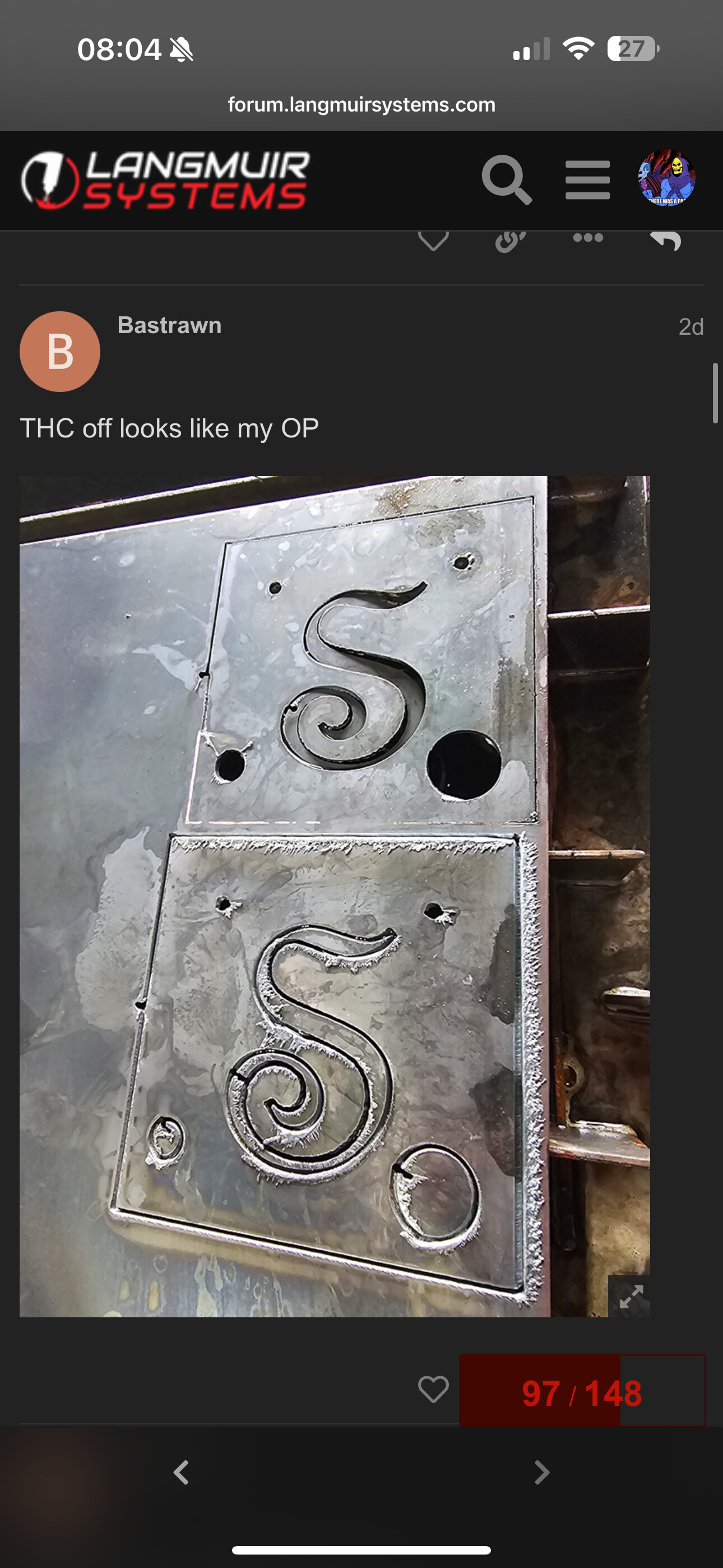

My point was with the THC off, was to remove the table from adjusting the cut height. To me, all those fine cuts look like it’s too high, whereas non fine cut nozzles will finish the cut with better results if still to high.
I have had the THC on smart voltage drive the height up and maintain at half an inch or more.

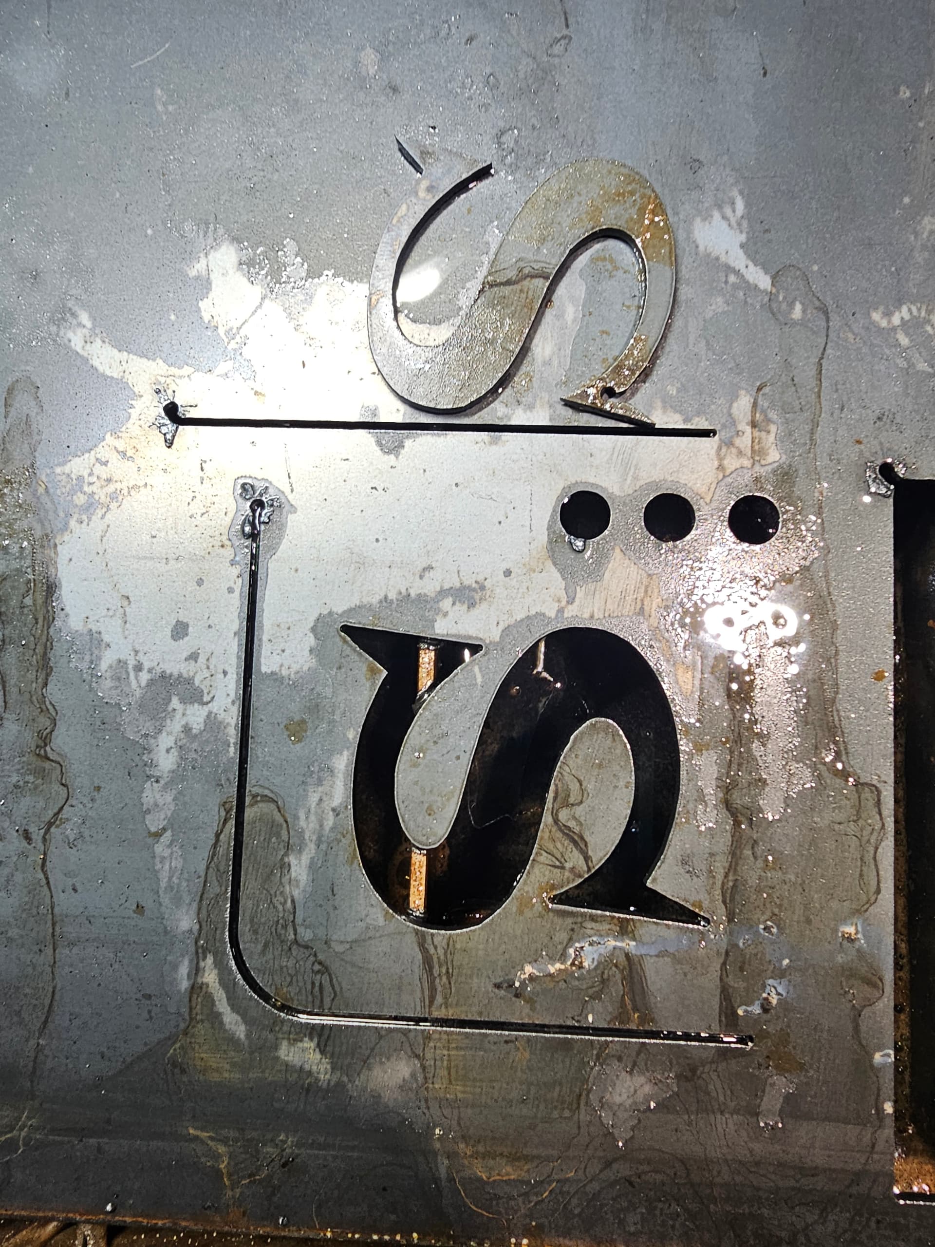

I’m going to cut the test file that @brownfox sent me and monitor the voltage during the cut. I will stop the cut on one of the lines and measure the torch height.
Voltage during tge rest cut was around 78. Cut height at the paused location was approx
.090.
