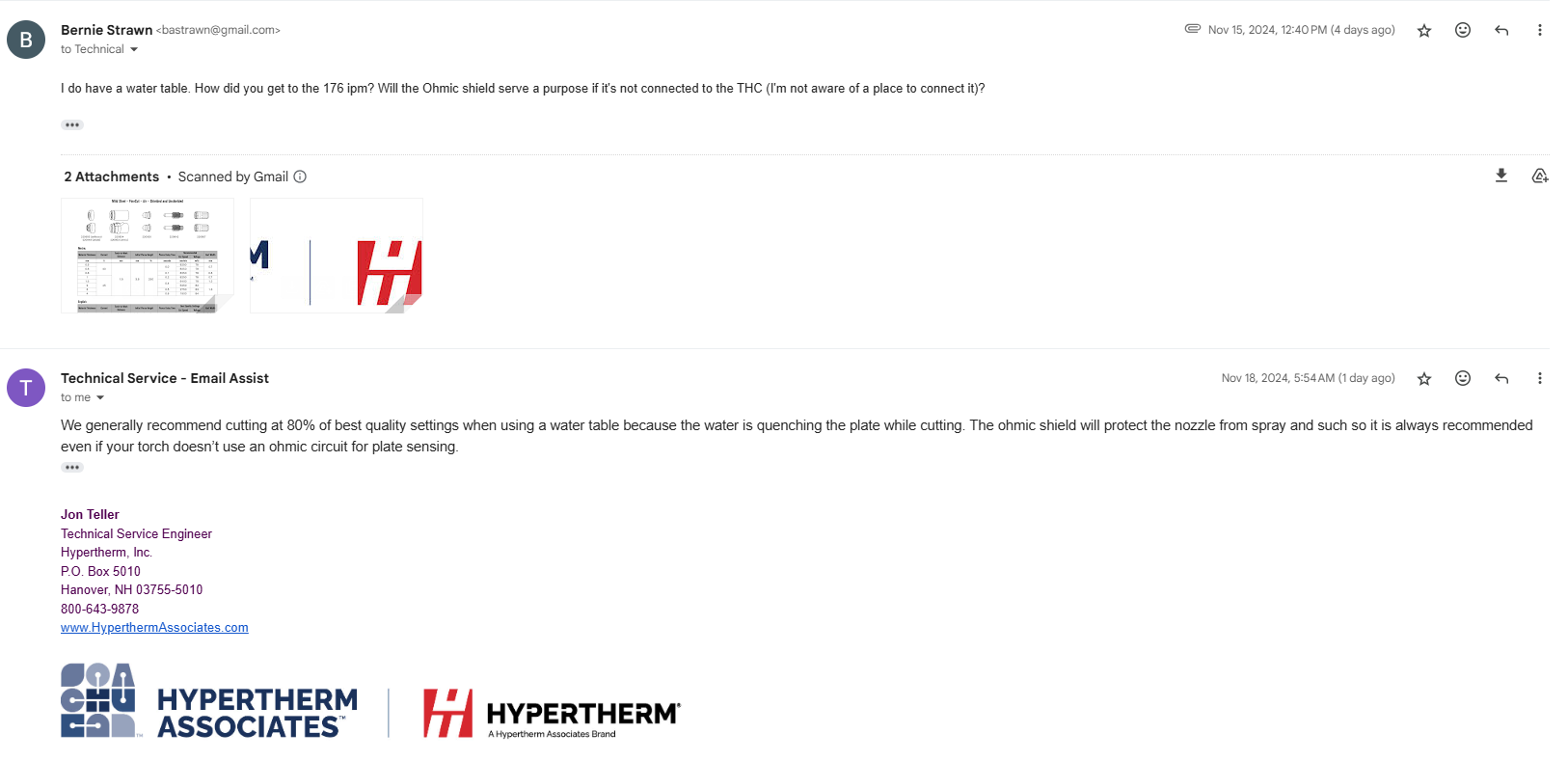

My brain is done with this. One interesting note, Hypertherm told @Bastrawn that the cut charts they publish are intended for downdraft tables not water tables, and to cut at 80 percent of the published speeds if you’re on a water table. A quick couple of google searches and I can’t find any references to this. Anyone have thoughts on that?
I can add a little bit to this (although not as specific to what you were told).
During my whole issue in my other thread, and my interacting with Hypertherm, having spoken to 4-5 different people (including an engineer), I did share the specifics of what I ran IE table manufacturer, use of water bed, and THC installed.
Every single one specifically stated more than an inch (or more) of room from the water to the underside of the metal being cut. I didn’t ask why, but it was something they all emphasized.
In fact, I remember sharing this info with Johnny at Langmuir after having spoke to Hypertherm but we both didn’t really think much of it.

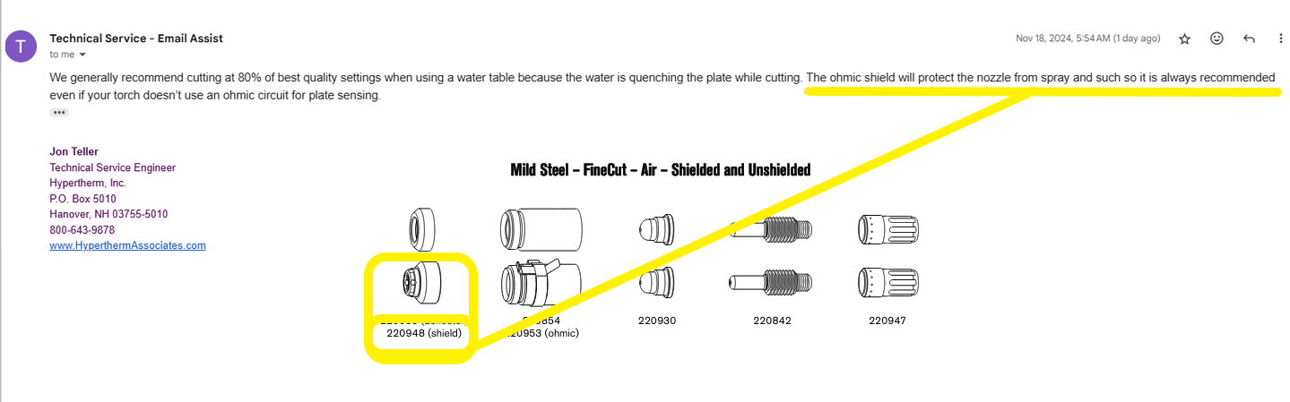

This is the exchange with the Hypertherm rep. The guy I spoke to on the phone said that the cut charts are based off of performance on a down draft table. Does the comment re ohmic shield make sense to you all? Do any of you use one?
Shielded is always recommended.
It works on either retaining cap whether it’s the plain one you have or the ohmic variant.
“ohmic shield” means the THC works off of a positive signal, not voltage.
Is there a benefit if the ohmic shield isn’t connected to the table vs the normal shield?
This appears to be what the Hypertherm engineer is suggesting:
Yep. Cause it’s shielded.
