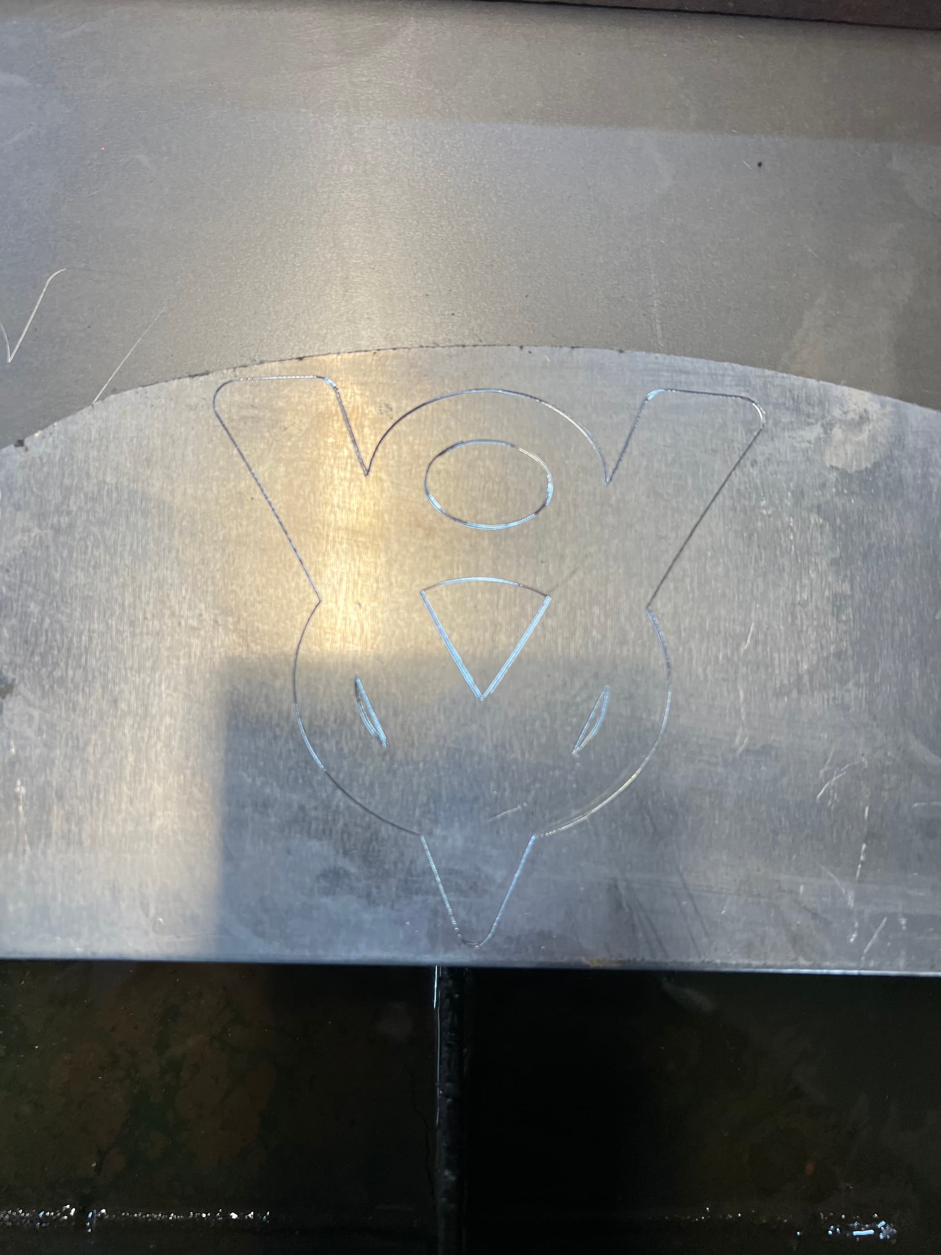

Very light etching and hit or miss I will put a picture on tomorrow I’m not at the shop now… Thanks

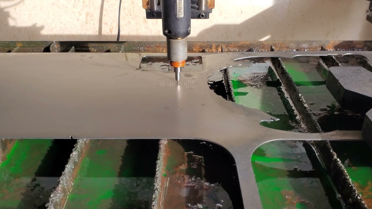

The above piece was 16 gauge mild steel, with 1 pass at 100ipm and a cut height of -0.2".
I know some people do more than one pass as the etching is very light in general.
Well it’s working now I think maybe it didn’t like the -.100 in the tool setup it’s set at -.300 now and this is how it looks…but it doesn’t have as much Z axis travel as in the above video.
