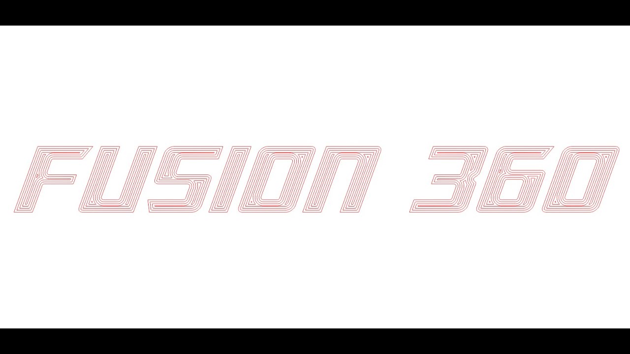

I posted on how to do hatch lines and setup a milling tool in fusion a couple months ago. It’s cool to use with sharpie. Really good YouTube video on it.
I’ll have to do a video on creating hatch lines because it’s a little tricky the first time you do it. I did it few months ago and found myself looking back at previous design scratching my head wondering how I did it for few minutes. If someone else wants to do a video please feel free to share. With all the recent sharpie talk I know it’s something others might like to tryout.

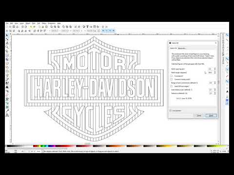

I know some of you like to do everything in Fusion, but Inkscape has a hatch fill function. There should be some YouTube videos on how to do it.
Hatching in Fusion 360
Hatching in Inkscape

I just watched Inkscape video and that’s much easier. Thanks
