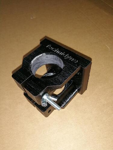

A friend printed me a spare Machine Torch Holder in PET-G. I really like this design, it fits and works well for me (STL file below, just delete the .dxf extension). Will be purchasing some PET-G as I’ve never tried printing with it before. He said the only machine change he made was to bump the hot-end temp up to 240* …the print took five hours.
M Torch Holder.STL.dxf (262.2 KB)
FWIW, that will fit on your resin printer and take about the same amount of time…

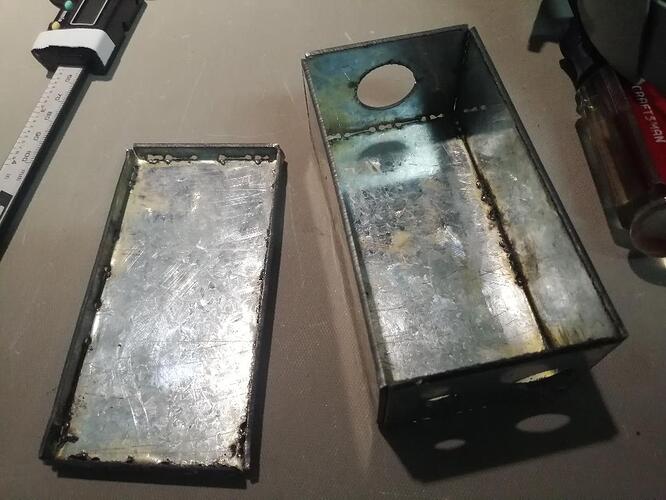

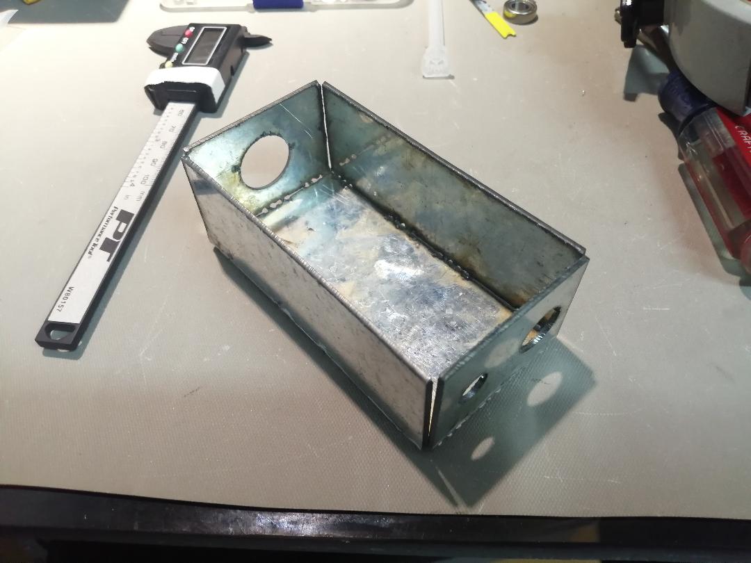

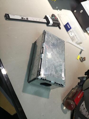

A little 3 dimensional experiment in 16g Galv Steel, just cut n fold on my bench-vise
The enclosure turned out quite well I think. Turns on the exhaust fan when the stack-light goes green. Built it as an interface that goes in series with the stack-light 4-pin connector. Uses a solid-state relay to switch the fan AC (it’s the one I had on-hand).
