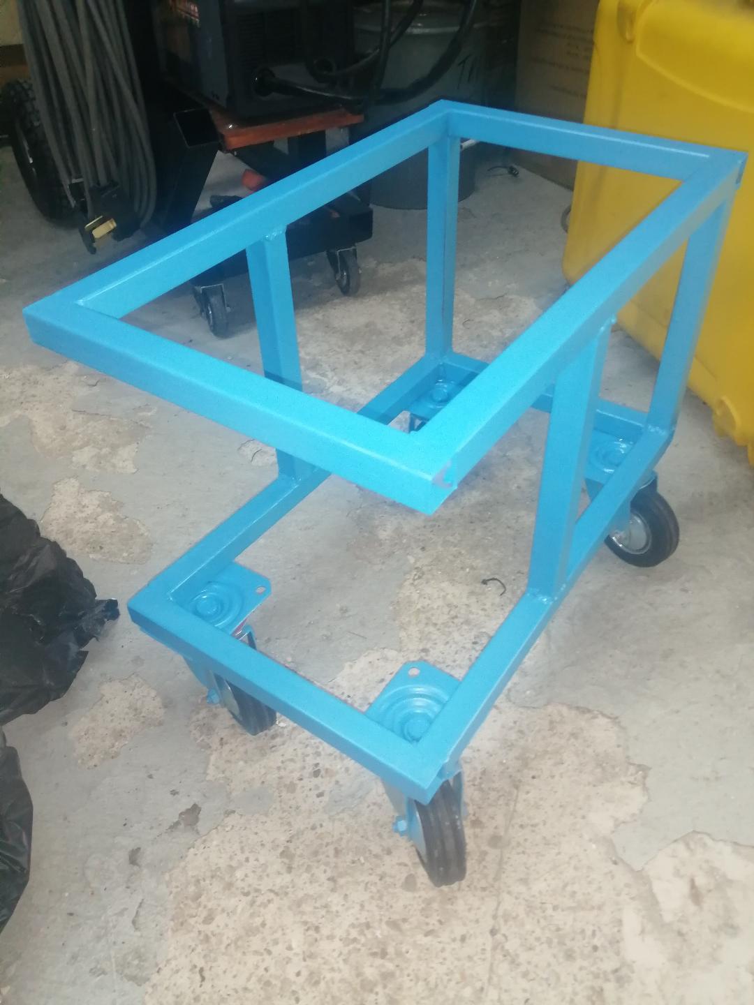

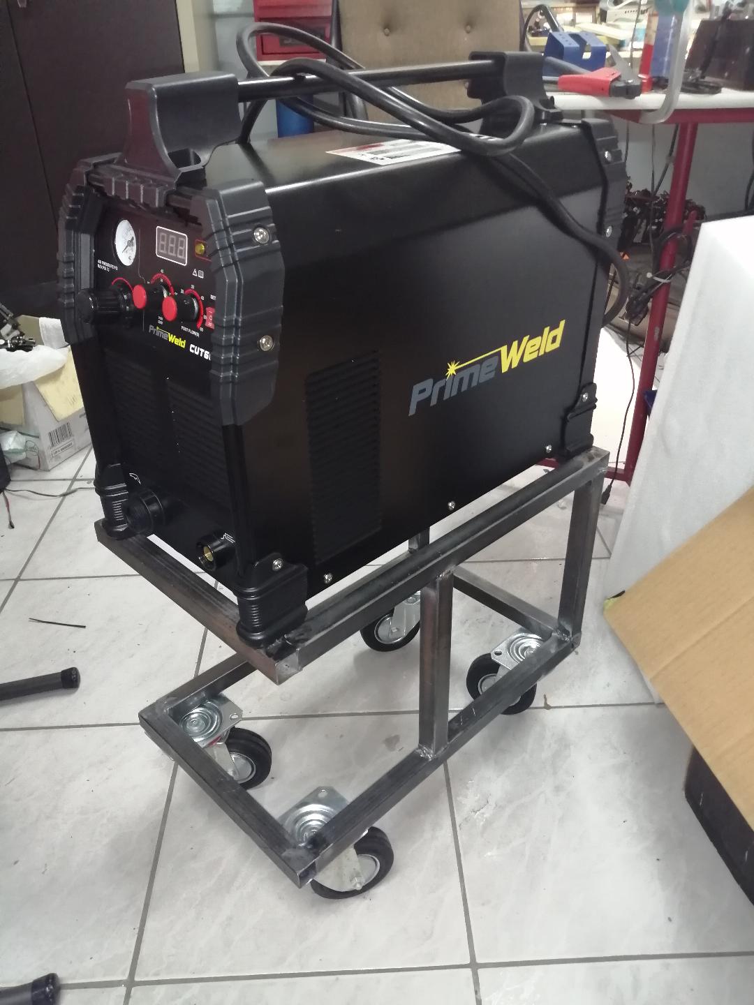

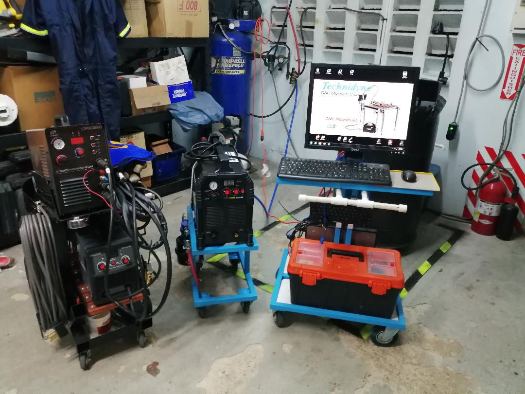

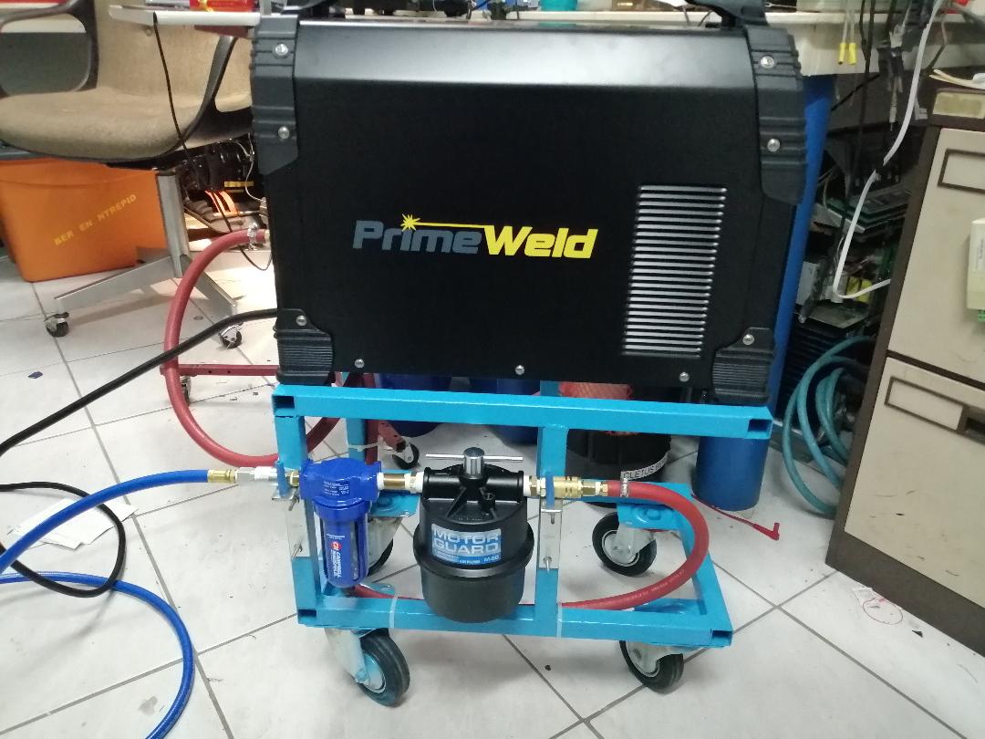

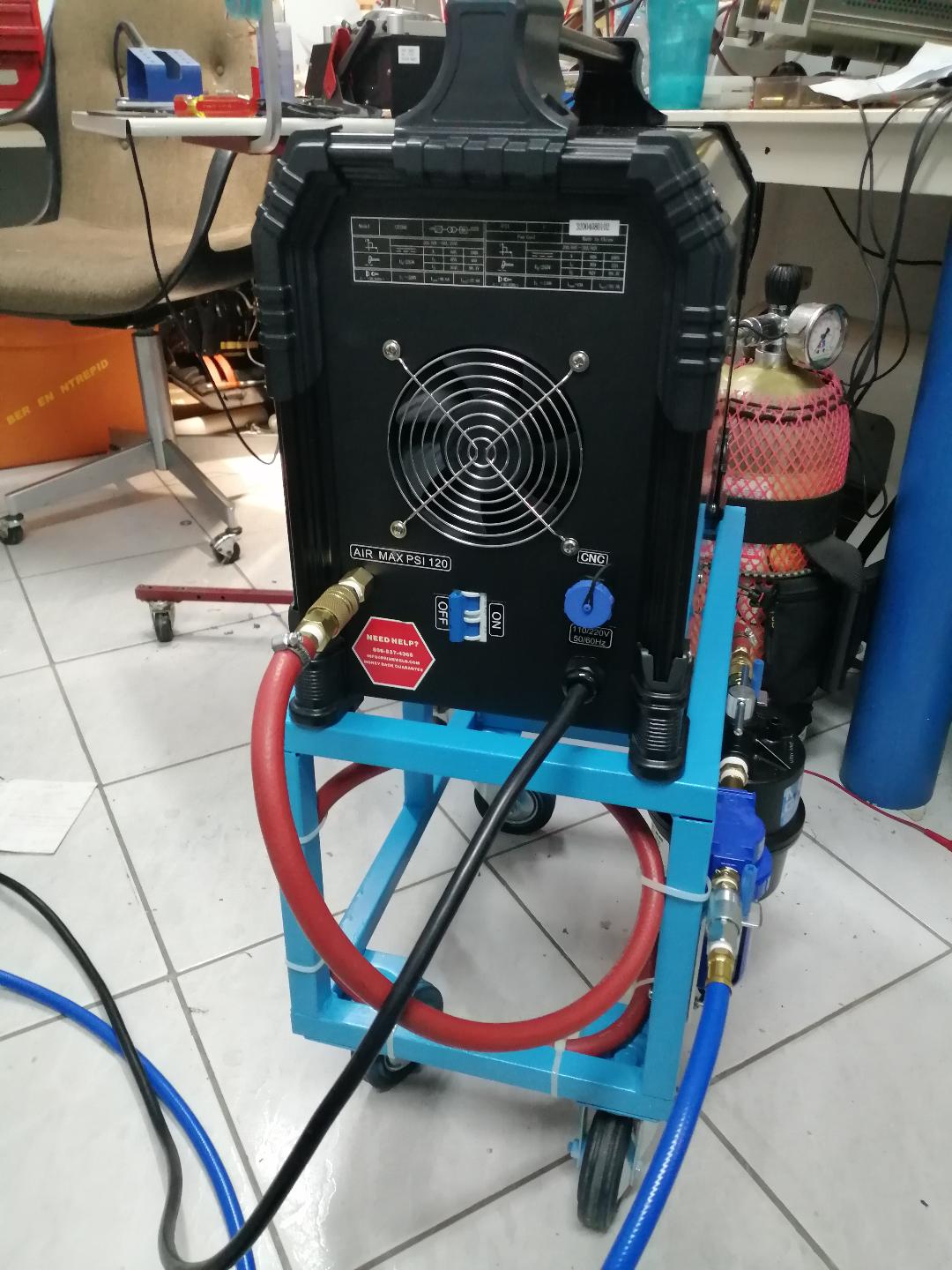

Whipped-up this little trolley for the CUT60 this morning (love the smell of flux-core in the morning) I’m thinking will mount the Motor Guard filter on the backside and my intended THC box in the front right under the CUT60 panel.
Plan is to get all the THC, Z-axis stuff and XL Kit in advance. Get the basic Crossfire up and running, cut some projects, gain some experience, then add the XL, limit switches, etc. and decide how I want to setup my Z and THC hardware based on my workflow and the physical constraints.

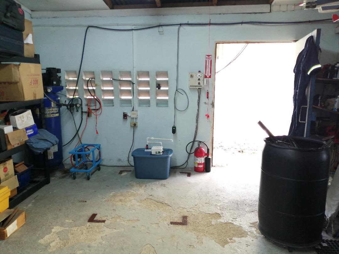

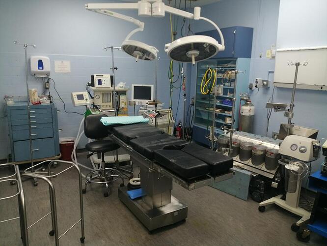

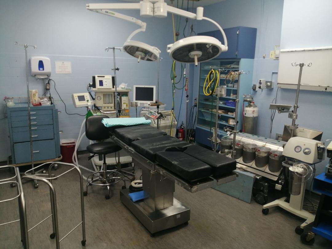

So, got up early and did some cleaning in the workshop and created the floor space I need for the crossfire (including the XL mod.)
Space! …the final frontier!
Seems something’s missing… what could it be???
Damned right! LOL! :rofl:
It’ll get there soon. Just keep playing with the software. The table pretty much runs itself with a click.:+1:
Looks like an operating room without a patient! (or a bed for one!)
I actually spent most of the weekend servicing equipment in an OR :rofl:
Better that then that room servicing you!

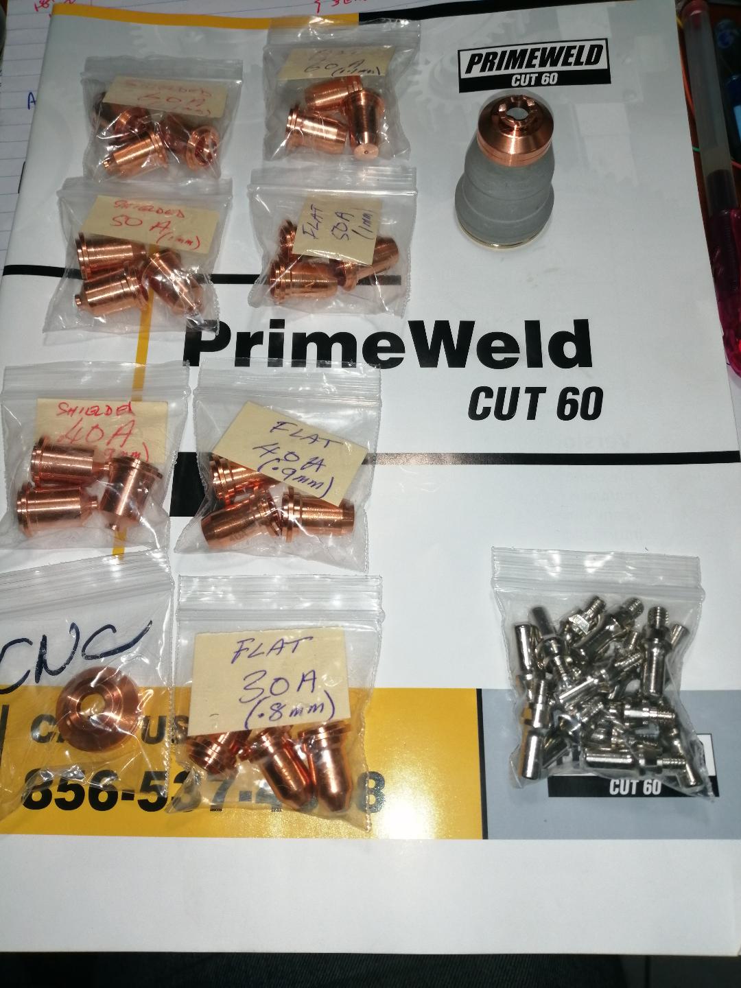

A range of consumables for the IPT60 torch, came in from George and cleared customs today. Now to figure out when to use what LOL!
Still shopping and acquiring stuff for my eventual Z-axis / THC modification, quite a bit of stuff in-hand already.
Let’s see… at a tip a day, I count that you should last maybe two weeks with that stuff! Good job! :grin:

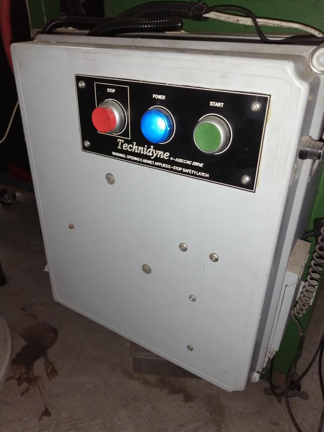

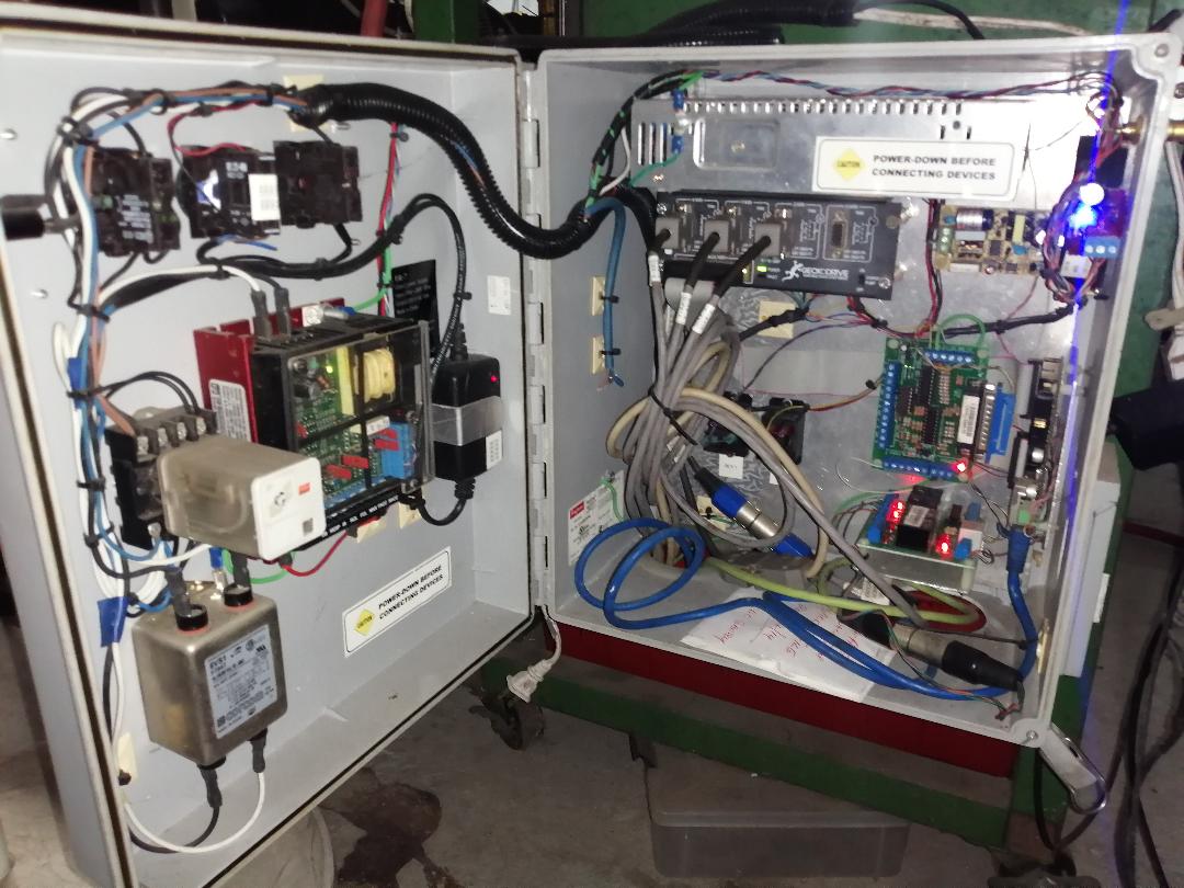

Well along with my Z-axis / THC mod, I’ve decided to build myself a completely new control box and leave the OEM control box unaffected. So I ordered all the goodies, power supplies(36V, 24V/5V), Red Board, Stepper Driver units (I have already), Relays, connectors, the THC3T- 02 step/dir, etc. Looking at a polymer or fiberglass enclosure with hinged door and latches big enough to house everything, but thinking a metal enclosure (though pricey) may be better from a electrical noise mitigation perspective.

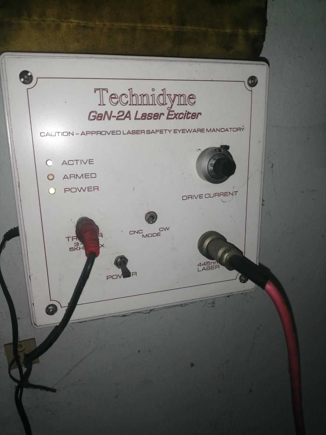

This is a Hoffman fiberglass control box I outfitted some years a go when I turned my Grizzly Mini-Mill into a 4-axis VMC.
Panel lettering was done with my homebrew CNC 3W Laser / Rotary engraver.
Feel free to checkout my other exploits on YouTube (9z4clb)
What was your process for ‘burning’ the lettering, especially with a 3W laser?

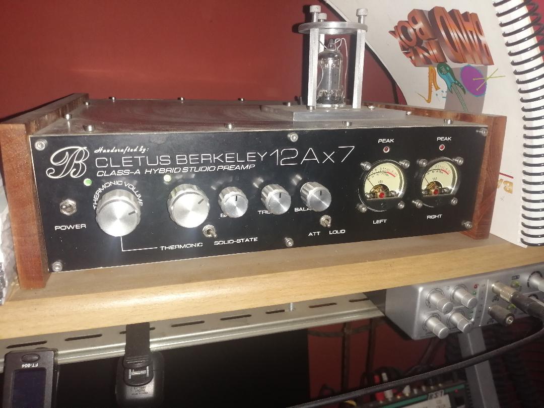

Black laminated plastic sheet (the top lamination is extremely thin) used for rotary engraving nameplates. CamBam to draw and generate gcode. Ultrasonic cleaner bath after burning. I use it for a lot of custom stuff for the hospitals.
Here are a couple other pieces (excuse the dust)

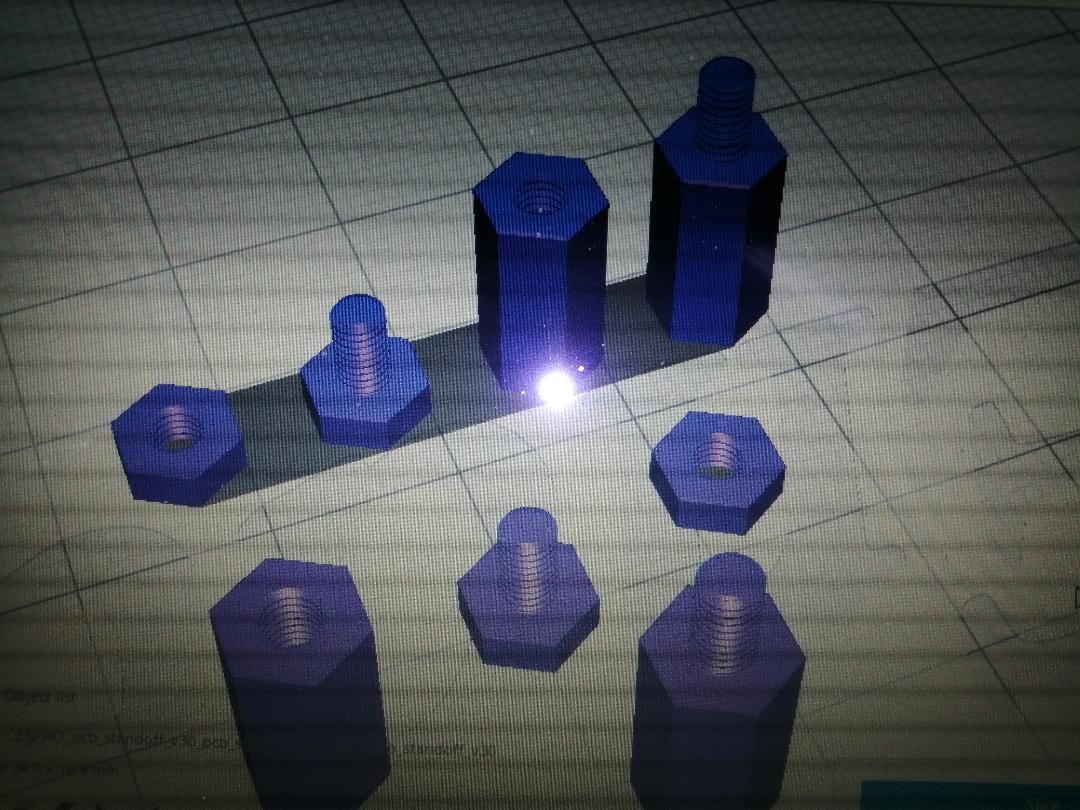

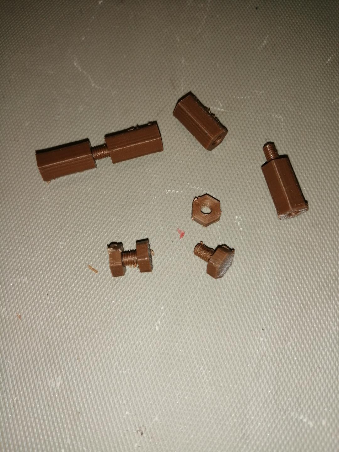

…and, here I go printing my own 3mm PCB standoffs :grinning:
