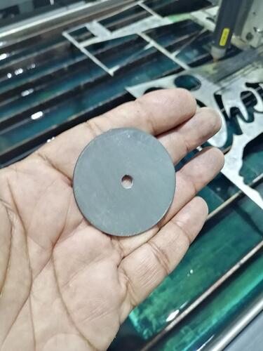

So, this is probably the coolest machine in the shop right now. Needed a couple fender washers today 2"od x 0.25"id for a hospital project I’m working on, was much easier to just make them than to get dressed and drive out to the hardware store! …now, if that’s not cool, what is? :rofl:
Yes it is nice and the good thing is you can make them any size you want.
And isn’t it something you always wanted to do in your jammies?!
Well, now that you mention it… :rofl:

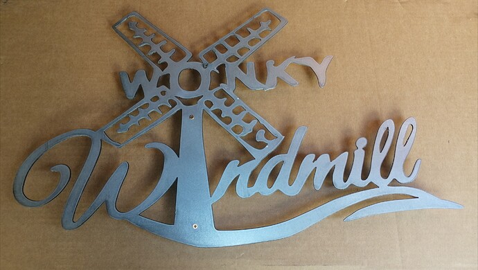

Just cut a small sign for a restaurant and bar in Tobago out of 16g

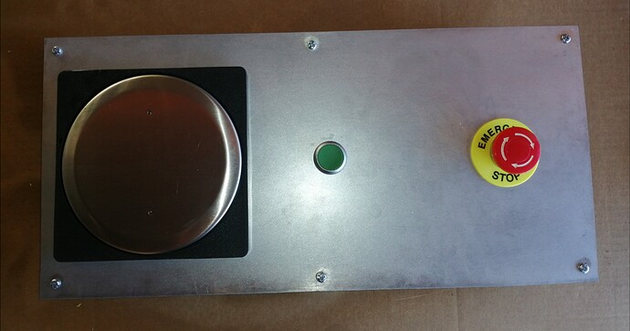

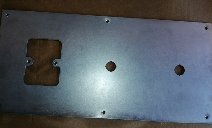

Just did some electrical panel work using the same 16g galv steel. This time I notice the torch dives hard into the sheet after every cut before going to the safe height and rapiding to the next cut location. There’s nothing in the gcode to cause this, hell I even did a dry run and it did not happen. It therefore must be coming from the THC. Any recommendations / ideas on this?
Yeah, tighten your window (‘A’ value) so that the THC doesn’t respond to the large voltage excursion when the piece falls free. I have mine set to 20 and could probably reduce it to 10 without any problem.
Great, Thanks Tom.
That was really scary, it like dove really hard into the work piece every time. Nearly ruined the piece! :grimacing:
Not to mention your torch… and your Z axis…
Don’t even wanna think about that!:crazy_face:
