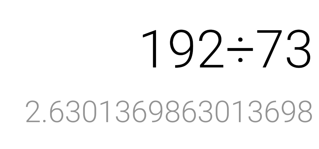

Been all though this previously with more knowable people on the forum , and Langmuir’s support and I still can’t get this damn thing to fire when the THC is turned on. and when I turn THC off It will not cut the first part of the piece, but it will cut the second half.
Check list :
raw voltage test 192v , 3volts out of the vim to the box
Cut height .060 Pierce height .110 Pierce delay 0.9
Ground clamp to the plate. No continuity between the box and table, lap top unplugged.
Reseated the module and relay, check voltages in the wires and board , poked and wiggled all the connections. Air and consumables good.
Got a new lap top and running windows 11 and the latest updates. Program runs a lot smoother and faster. But still same old problems NO FIRE except for manual torch fire. I can strip plate all day long but can’t run a cut file.
Turn on the THC and hit start, live voltage square on the screen reads 2-3volts for the moment the torch fires then goes dead. Windows pops up torch move before voltage was …

I am plugged into the PV port. and I am getting about 3 volt signal when I dry fire the torch.

Are you going to hook up the 65 for raw voltage or divided voltage(if it has a CPC port)?
