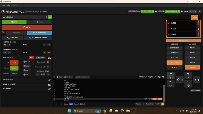

Unless Z-axis moves in a stepped down increment?
By using the increment jogging, if I move up 1/4" (.25), it physically moves up 1/16" (.0625).
Move it up 4 steps which would mean 1" (1.0), it physically moves up to 1/4" (.25)
What Firecontrol says -
Where it actually measures -
Actual movements are a quarter of programmed jogging.
Now we’re getting somewhere. That would also correspond to your cut height of .02" (A setting of .06" + .02" backlash= .08") Exactly 1/4 of the programmed distance.
