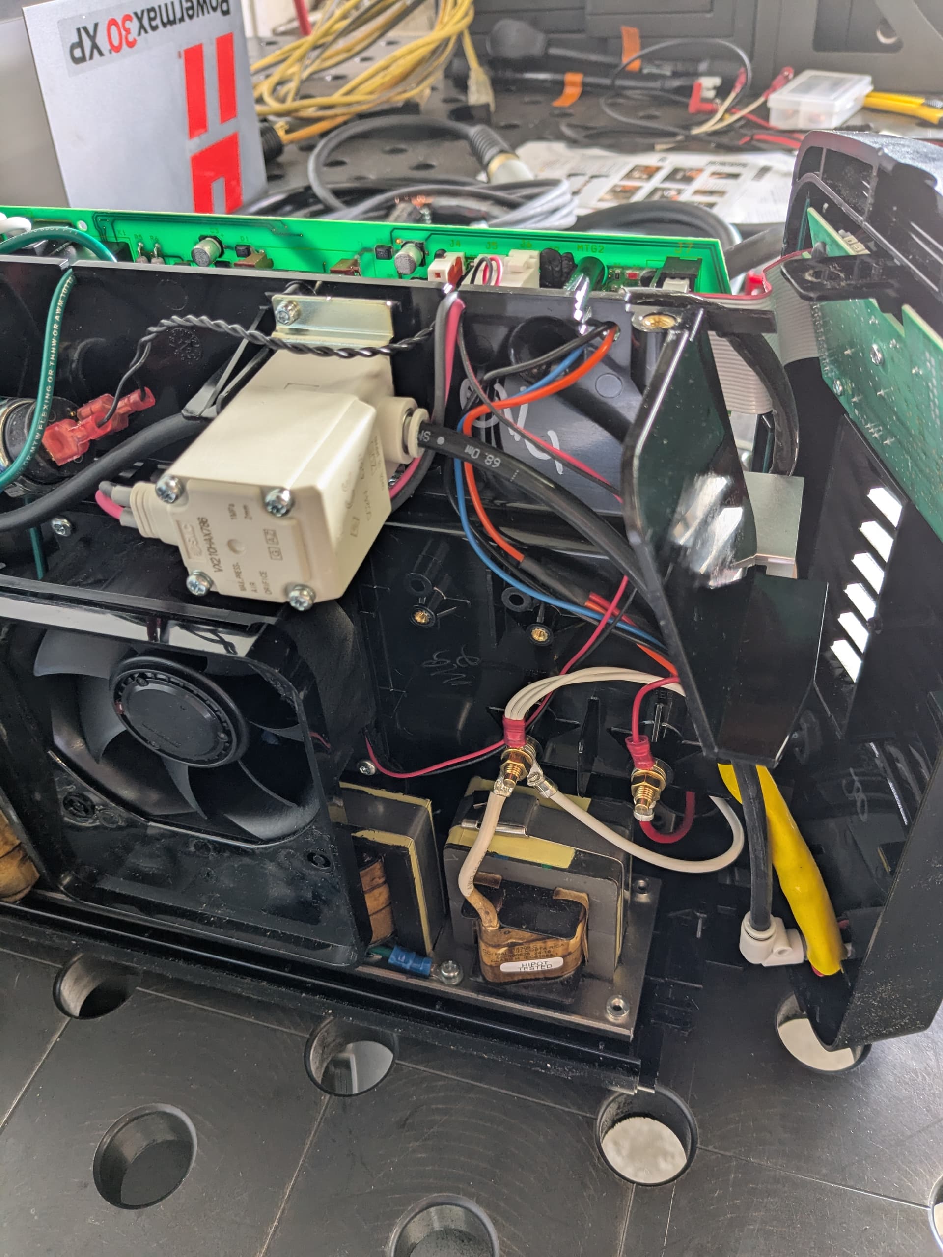

Hi I tried to follow an old thread but it looks like my wiring colors have changed with updates possible.
I also ordered the unit with a Machine torch pre installed, maybe that’s the difference?
Here’s the old thread of where to tie my vim box into

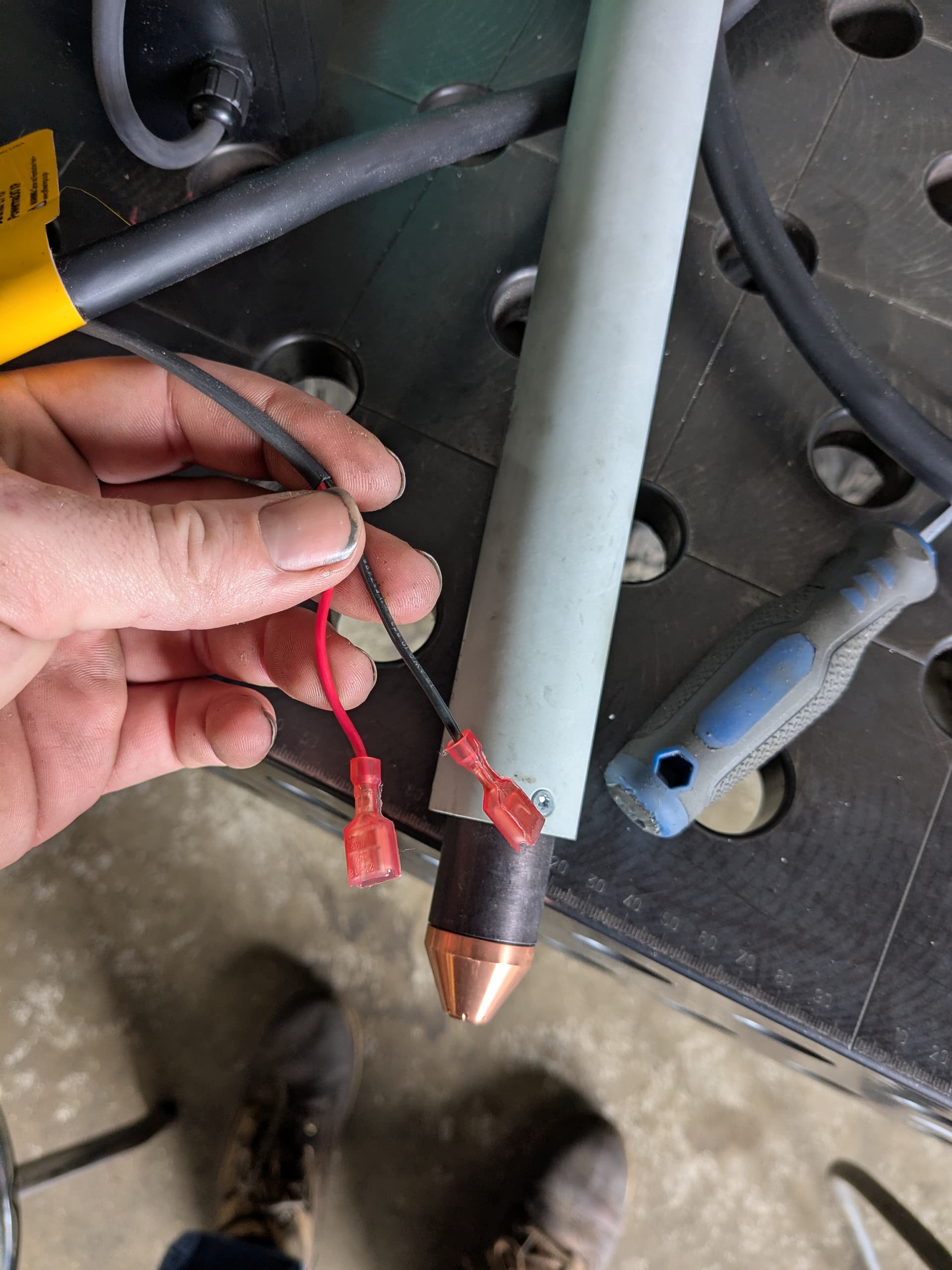

Here is the wiring from the factory off the torch lead, and I’m not quite sure where it goes in reference to the table computer.
Red and white if I had to guess.
White is definitely going to the torch, red looks like it might be going over to where your work clamp cable runs in. And that would be correct. The cutter will be negative voltage, the work clamp will be positive.
