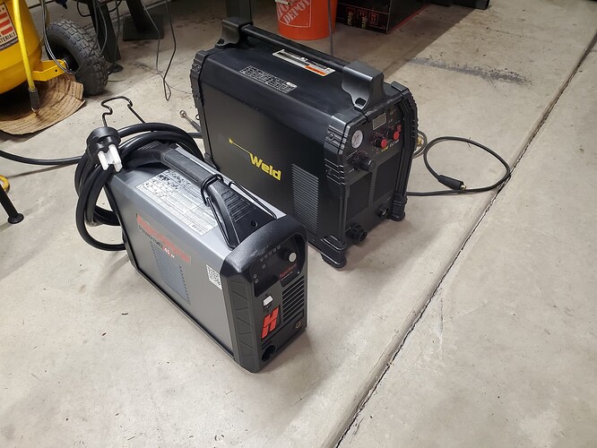

My first Hypertherm, and I’m coming from a PTM-60 which was unshielded so height was measured from the nozzle. Then switched to a UPM-105 when that released.
Machine torch, just arriving a few hours ago
The old next to the new
And the CUT60 getting retired

Your up grading from a Hyundai to a Ferrari. Things are going to change a little.
