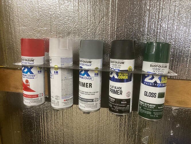

i walked out to my attached garage and seen i have spray paint cans in a big bin so figured i would design easy paint can holder. I’m going to make a few lengths and i’ll post in little bit. if others need cheap simple wall paint can holder
