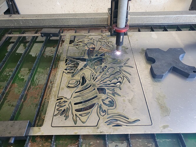

Got lazy, used the wrong nozzle (65 amp instead of 45 amp)
First time running the air dryer at least
Oh well, I like it
Just a little 22" x 13" piece to go above our aquarium
That’s nice. That starfish has some really thin areas. You’re really getting the best out of your equipment.

Someone in the PrimeWeld group wanted one so being the kind of person I am, I took a bit more care in cutting it out
It’s also 5% larger than the one I made for myself
You’ll notice a bit more detail was retained, specifically the shell on the right
Just have to wipe it with acetone
Then package it up
