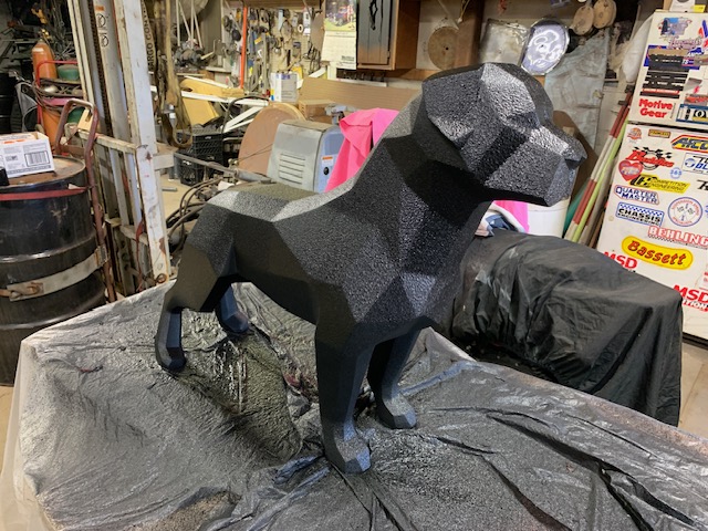

Well over a year later and way to many hours welding, grinding, a little bondo, fill primer and finally spray on bed liner to hide the little imperfections the Rot is done. Its going to sit in my oldest daughters house with a progression scrap book. This was one of my first cutting projects with my pro.
IMG_1883
IMG_1884
IMG_1886
Absolutely fantastic. How many hours do you think you have in that dog? I love spraying bedliner. Your floor will be sticky for a week or so.
That really looks nice. Nice job
Thanks guys. I probably have close to 50 hrs in it but It took so long I am not 100% sure. I have a little trouble staying on task at times. I wish I would have kept track though.
That is super cool. Thanks for sharing.

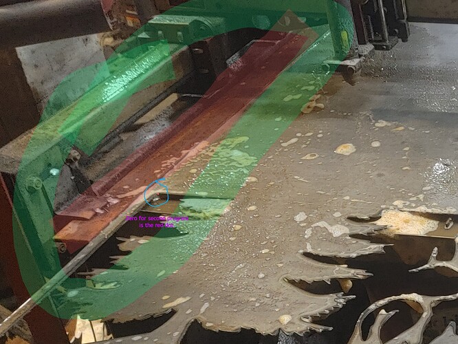

Very cool. @alwnasrock how challenging was it to adjust the sheet when cutting that big of a sign? Trying to think of ways to maximize my cut capacity buying an XR and or scrapping a full sheet because I miss aligned it for the second half of the cut :laughing: I’d love to hear your process.
I have a piece of .25 ×2" flatbar attached to the side of my table that keeps the plate lined up in the center of my table. I made two cut files on fusion360. Once i cut the first file i slide the plate through far enough to accomidate the second file. I ran a couple of dry runs to home in on a good zero. Prayed for success etc. I was nervous for sure. It all worked out. it is actually pretty easy once you understand the setup.
The red dot in the upper left corner is the zero for the second cut file.
Awesome. Thanks for sharing. It looks great and I got a good chuckle out of “Prayed for success” I do this every time I load half a sheet…I had my ground in a bad spot once and the tram clipped it and moved the sheet a foot out of place turning it into junk.
