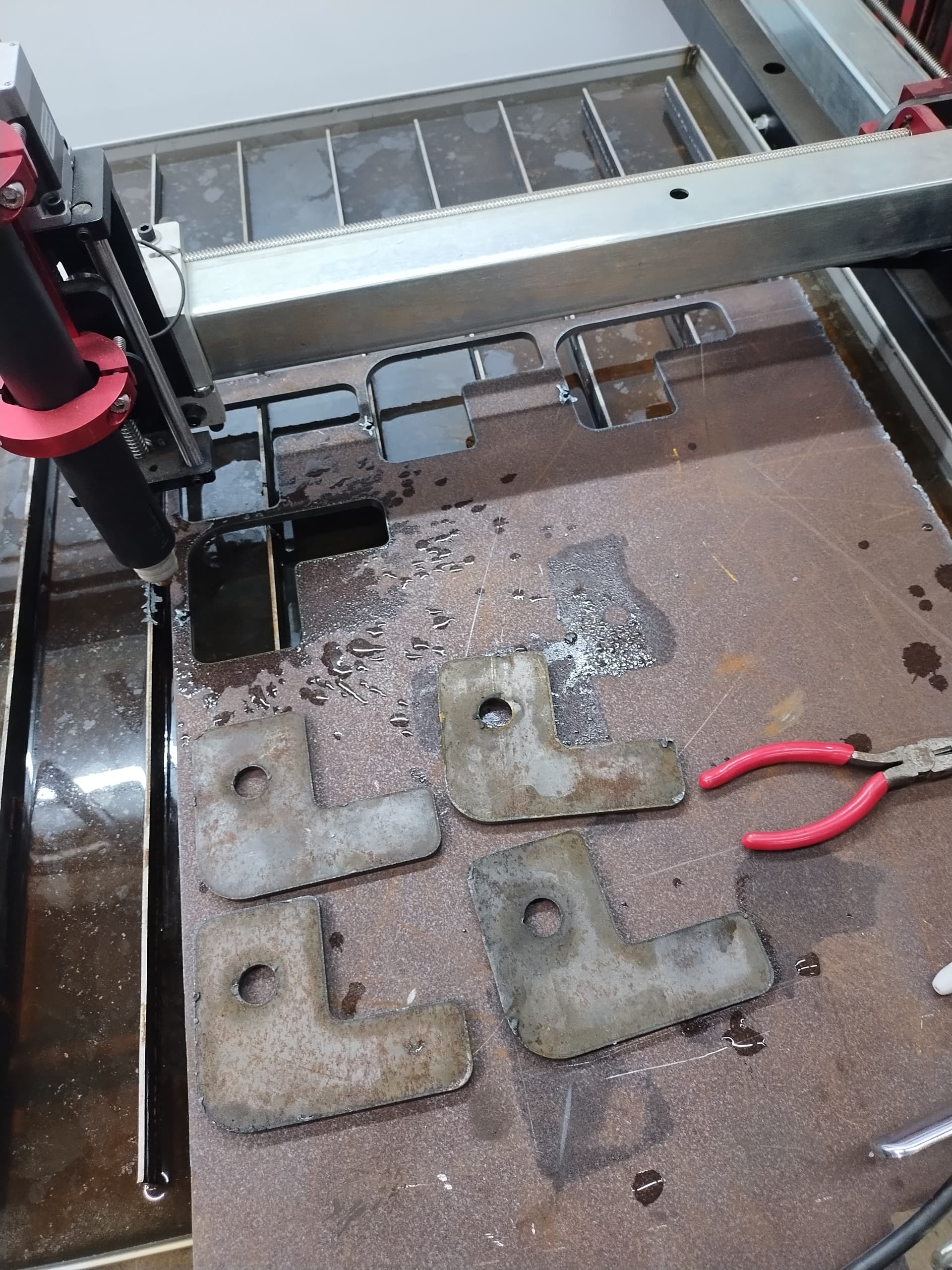

Some brackets for a snow plow mount. @Ammocan the metal work is amazing.
WOW Nice work

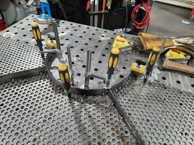

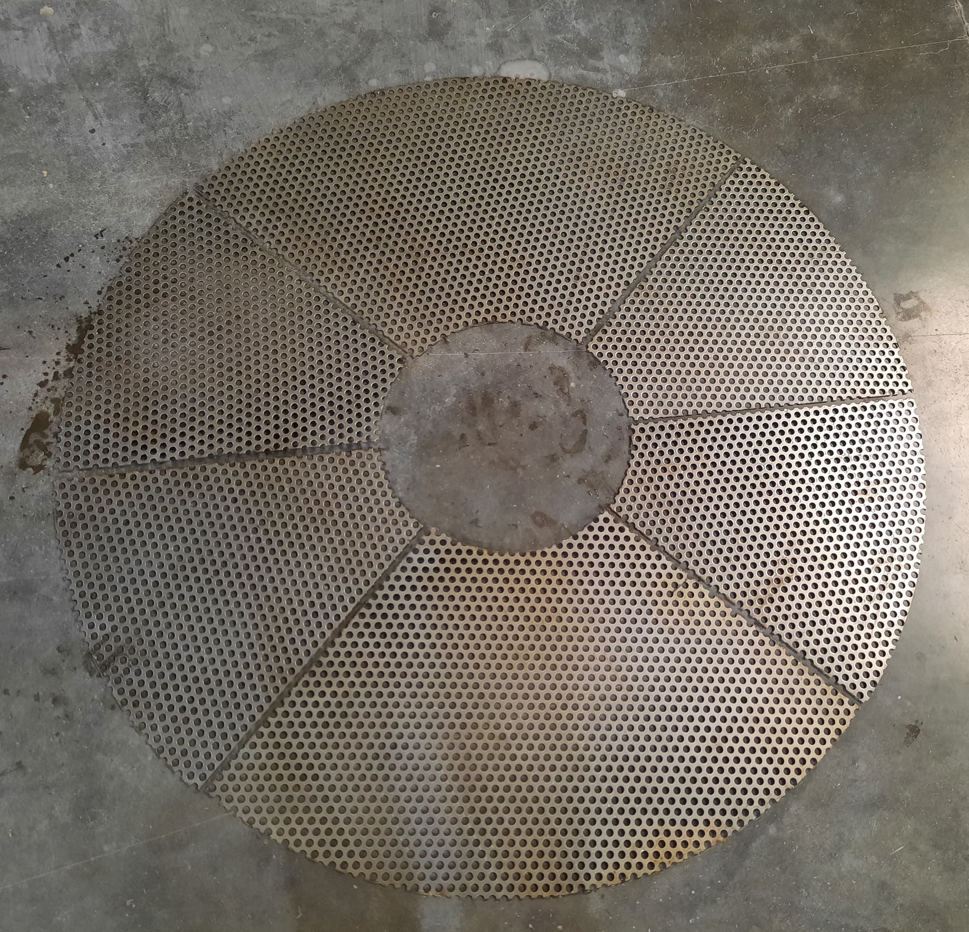

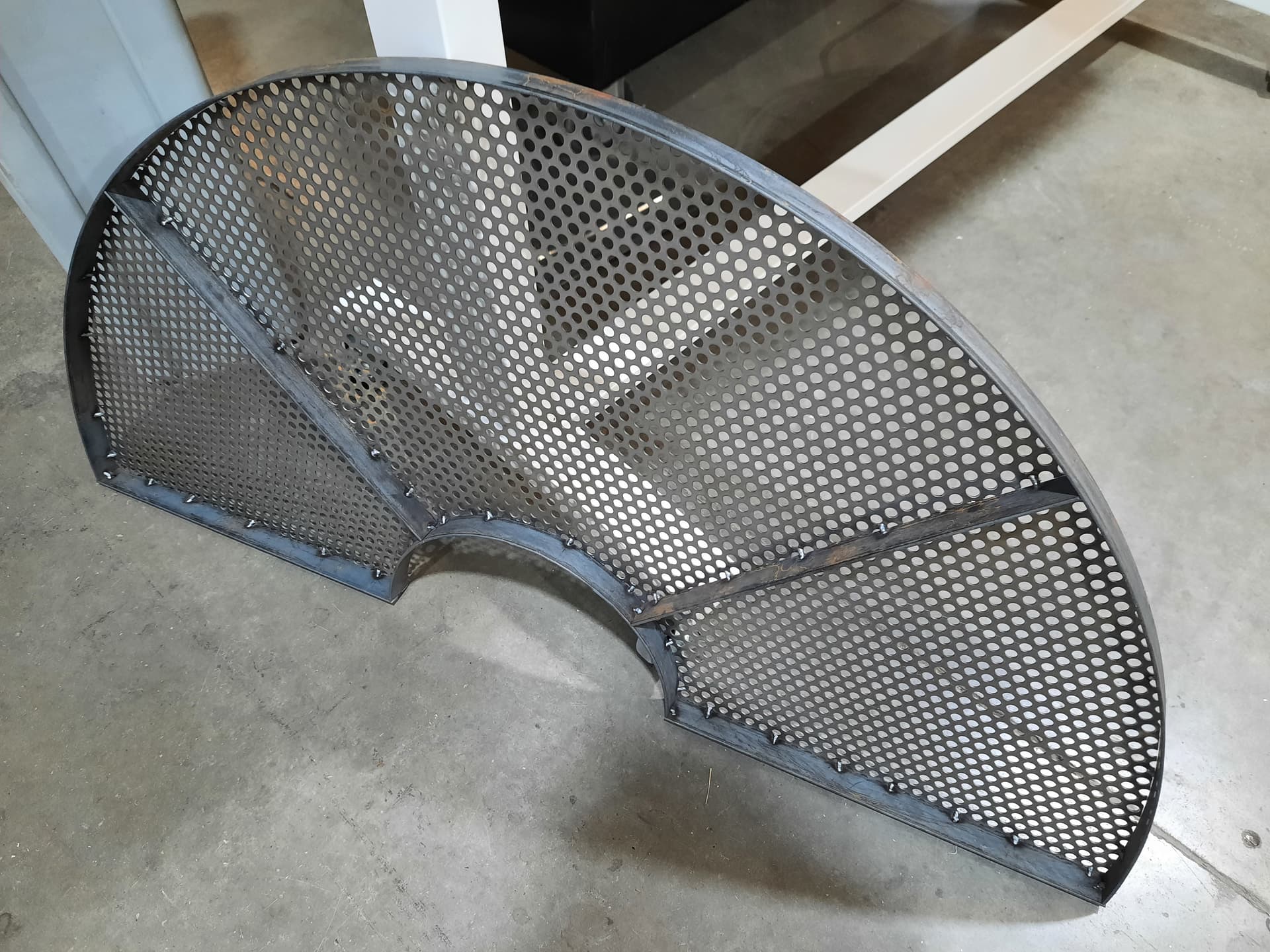

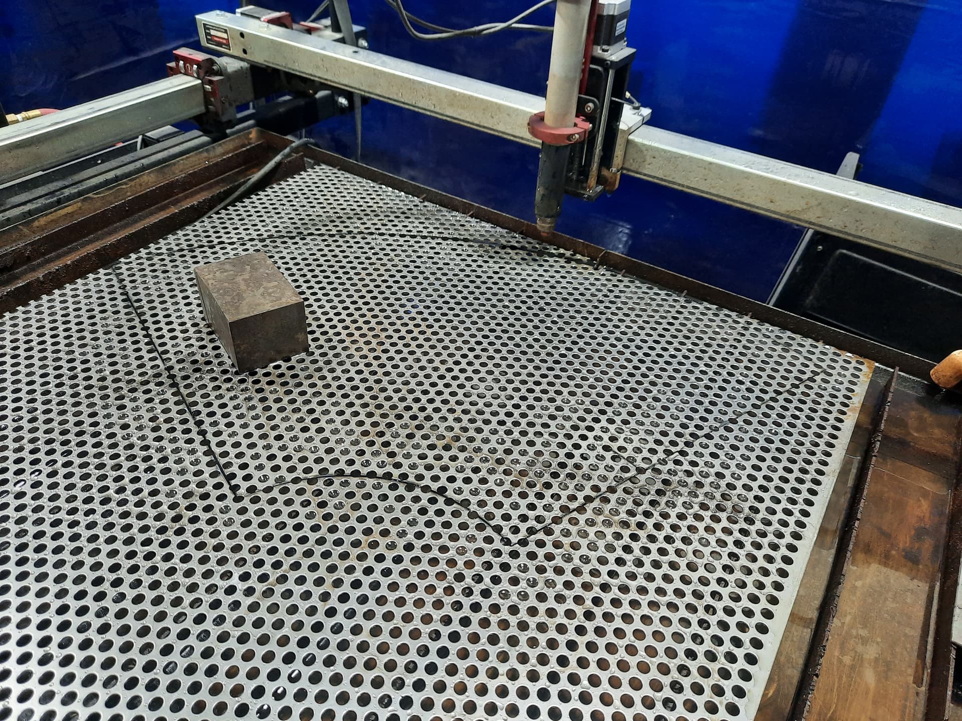

Working on a wrap around tree table made from perforated 14ga. (See my other post about perforated cut problems). Got half of the top fabricated this afternoon.

That’s gonna be cool, and you get to both cut and weld on the same project! :clap:
Can’t wait to see the finished product.
Sure, I cut and weld projects all the time. I’ll keep you posted on my progress.

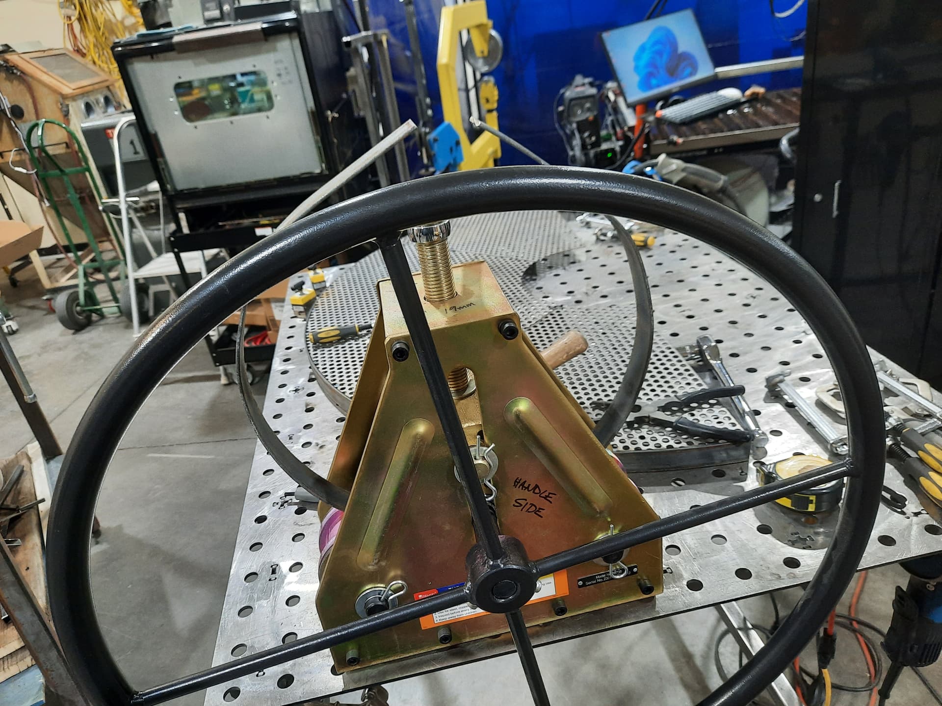

What do think of the Harbor Freight roller?
Are you asking me about a roller?
