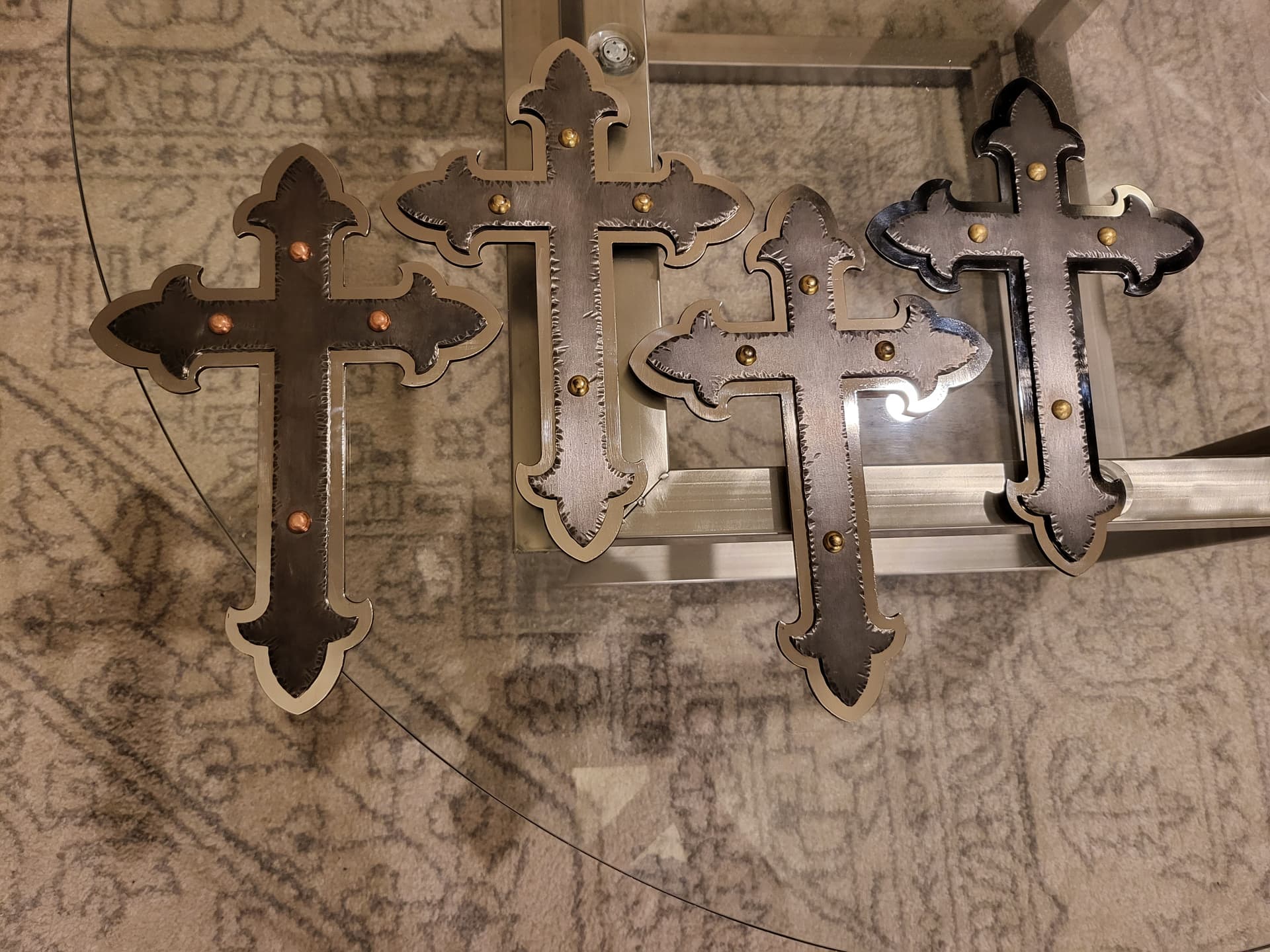

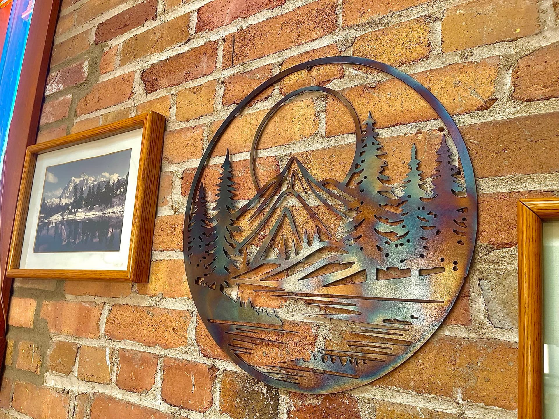

Had a little fun coloring some 12ga yesterday. Need some more practice to make it a little more uniform.
I have some odd pierce holes I need to sort out too.
I think it looks fantastic!
Thank you. I’m having fun with it.
Nicely done :+1:
Thank you!

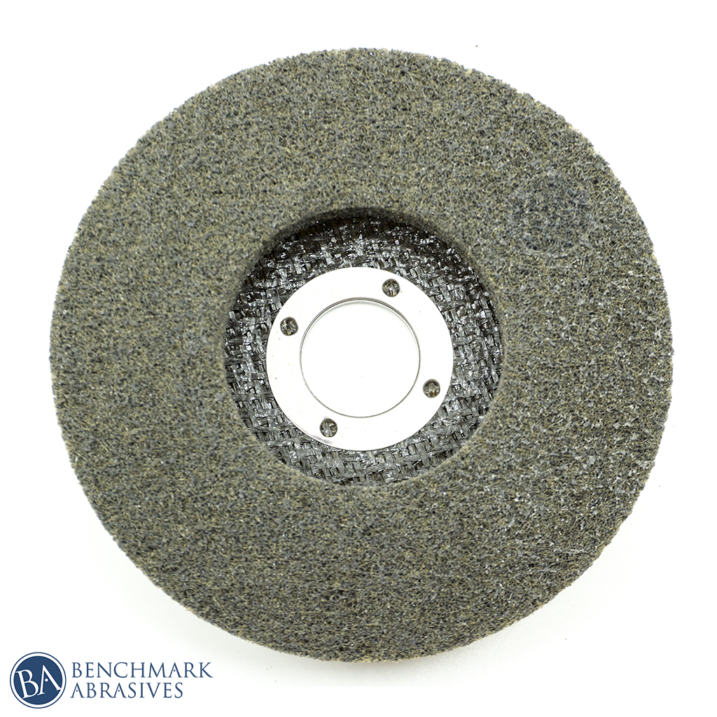

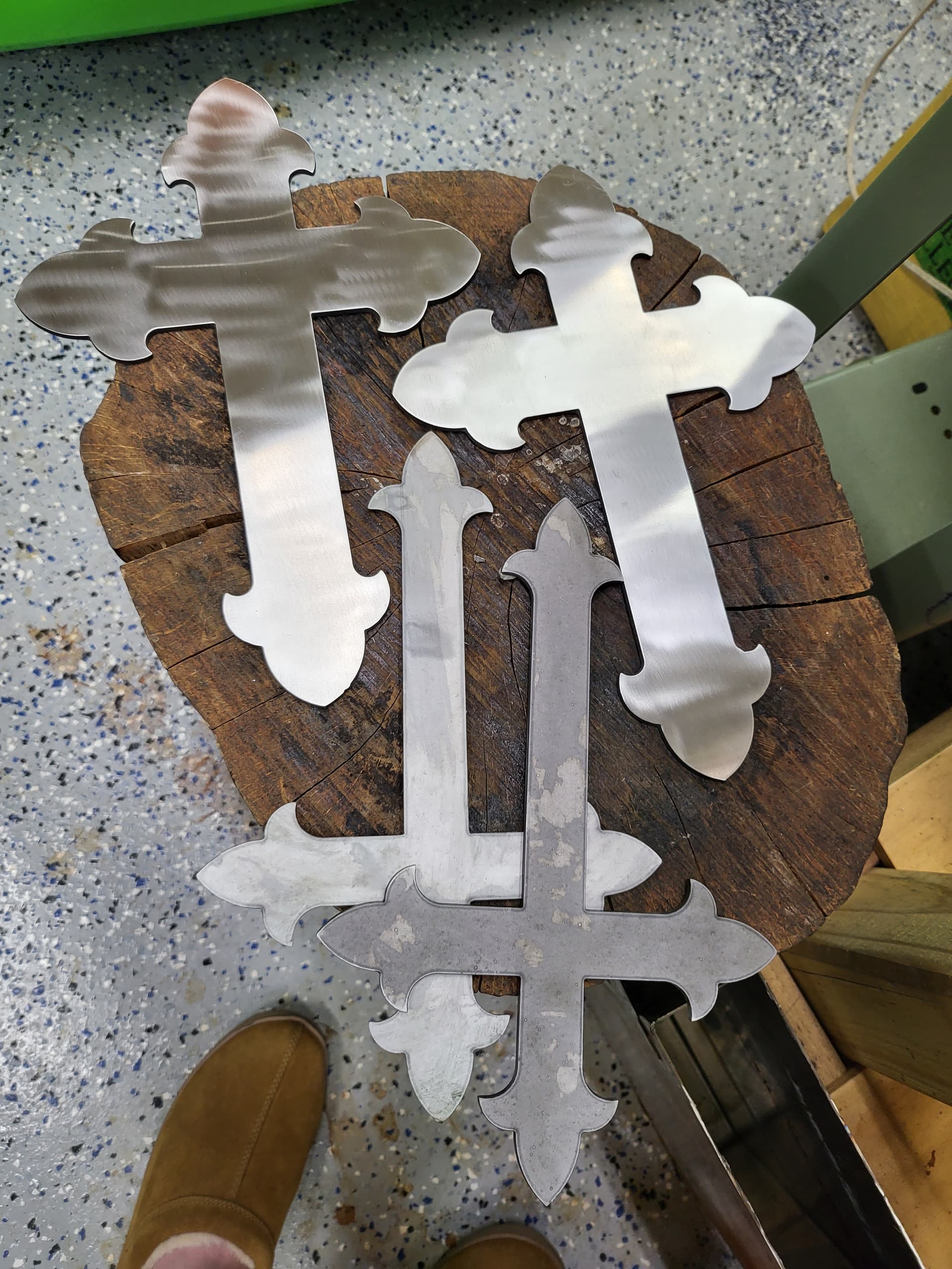

This. 80-120 grit flap wheel, or surface conditioning discs, like these from benchmark are what I use to clean up my .120 stainless crosses after cutting. I cut at 0.020 torch height, 75 psi, and water as close to the work as I can get it (also why I’m upgrading to a deeper water table).

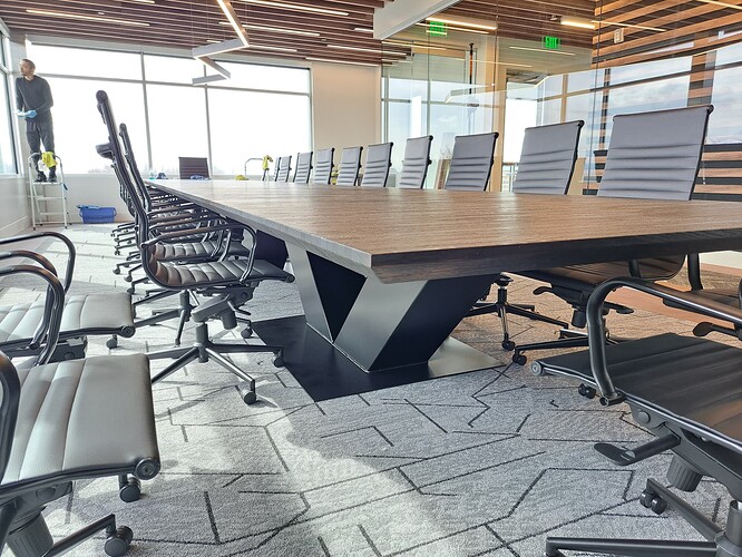

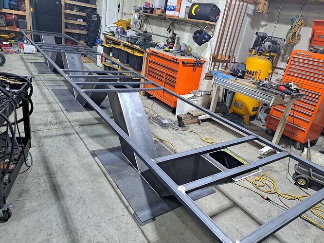

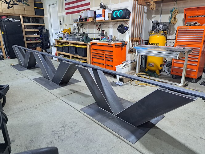

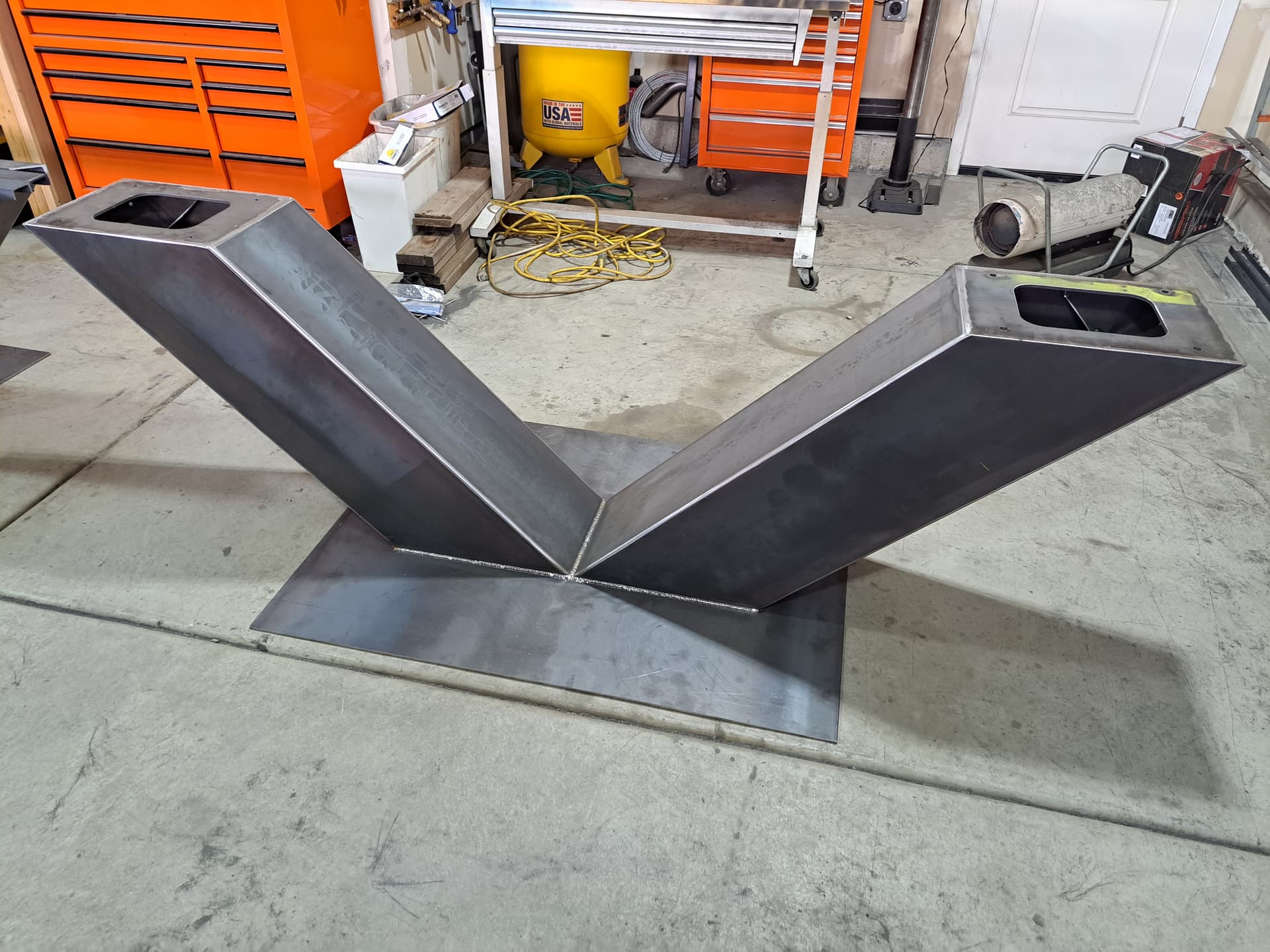

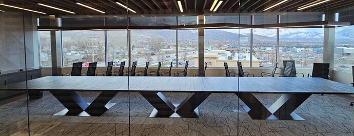

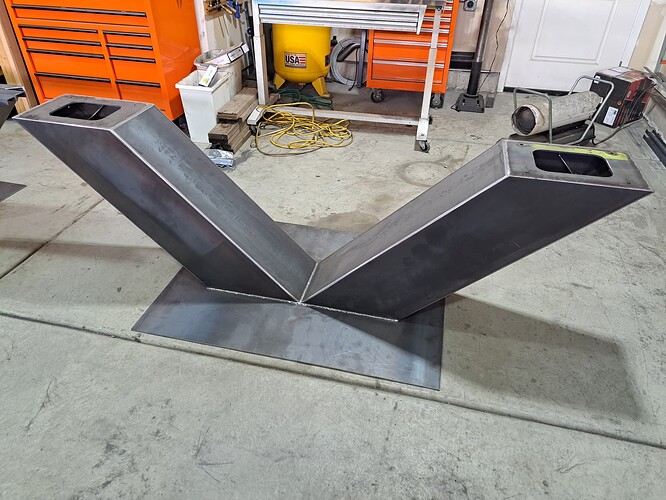

Here is the last project I will ever do on my crossfire pro (sold it right after this project) and the reason why I bought the XR. This is a 28ft conference table. Barely fit in my garage.
