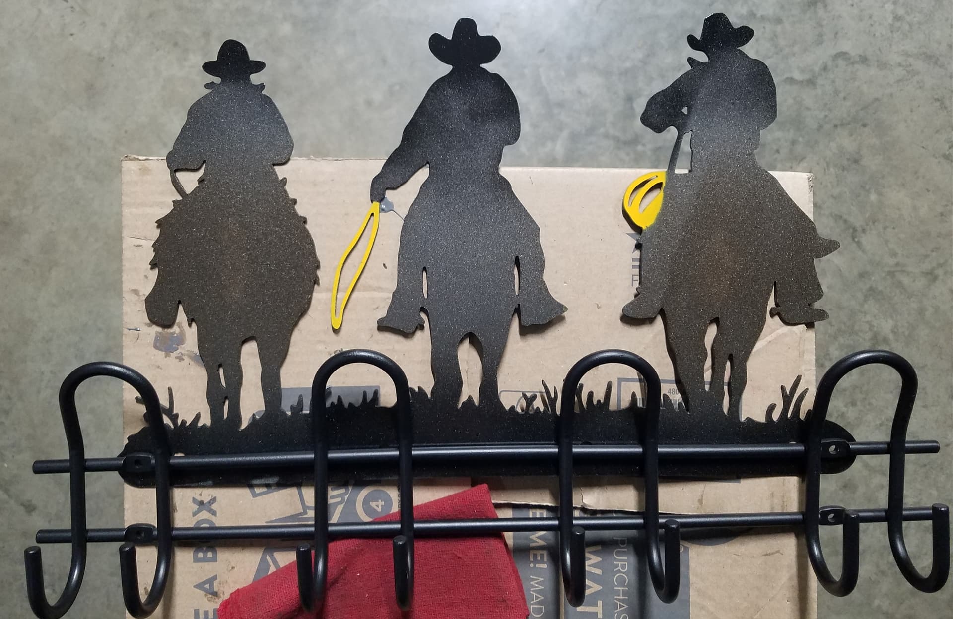

Making a coat rack for my parents kitchen. I had added holes for some hooks, but came across this premade at Home Depot. Not a very good pic, but… They are in their late 80’s and they both love to watch cowboy shows.
Nice work! Love the western coat rack!
They don’t make westerns like they used to! I don’t know how many channels my parents have… they don’t either… always tuned to the old western channel or live sports. :stuck_out_tongue_winking_eye:

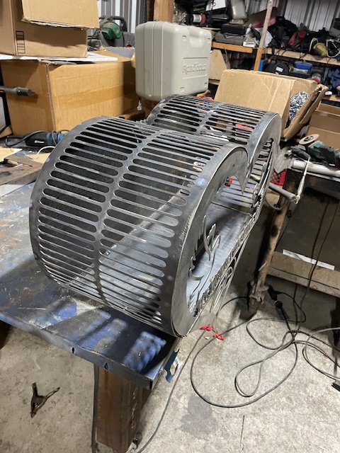

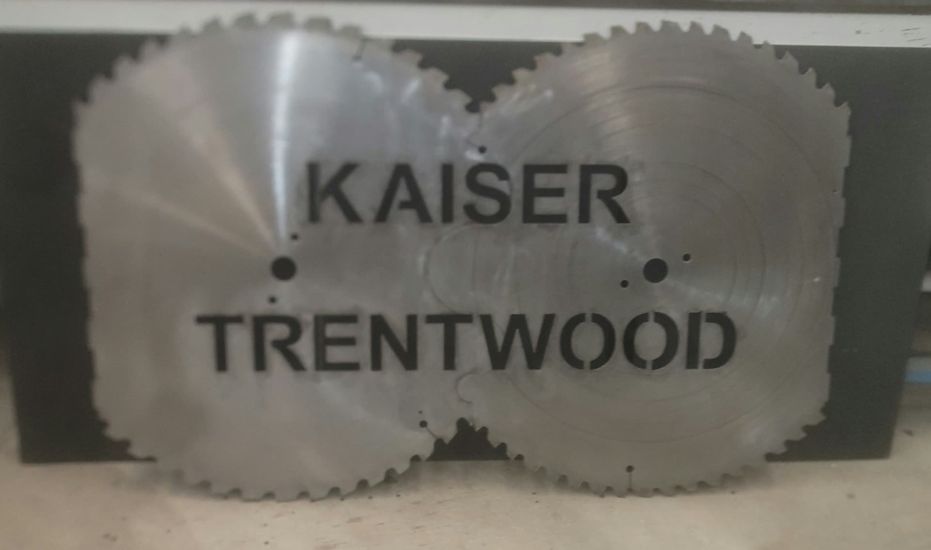

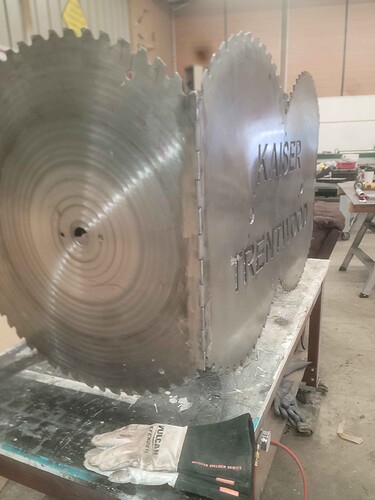

BIL asked me to make some carts to transport these blades from customer to his shop. He didn’t want just something ordinary so I’m playing around. Had no clue if it was a smart thing or if it would work stacking two of them to cut for a precise joint to weld these together into a solid backplate. Pleasantly surprised that it worked quite well.
Now I have to fabricate the base to attach this box to. If they like it they want two more identical.
two plate cut
Not sure how to post videos so let’s see if this works…if not can someone teach me how to post video?

I’ve no clue how to post on youtube. It was just a video of how well it cut with the two plates stacked on top of each other to get the perfect joint between them
I was able to watch the video so however you loaded it seemed to work. I believe it’s just like uploading photos just has to be within size restrictions.
Those blades turned out really good.

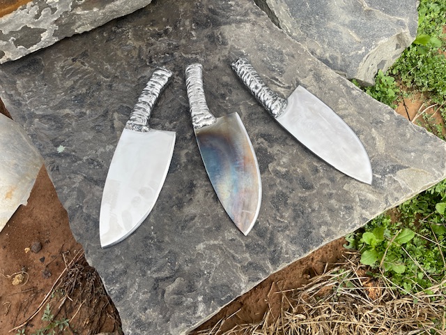

I grew up working on an old 4 head block Ireland mill

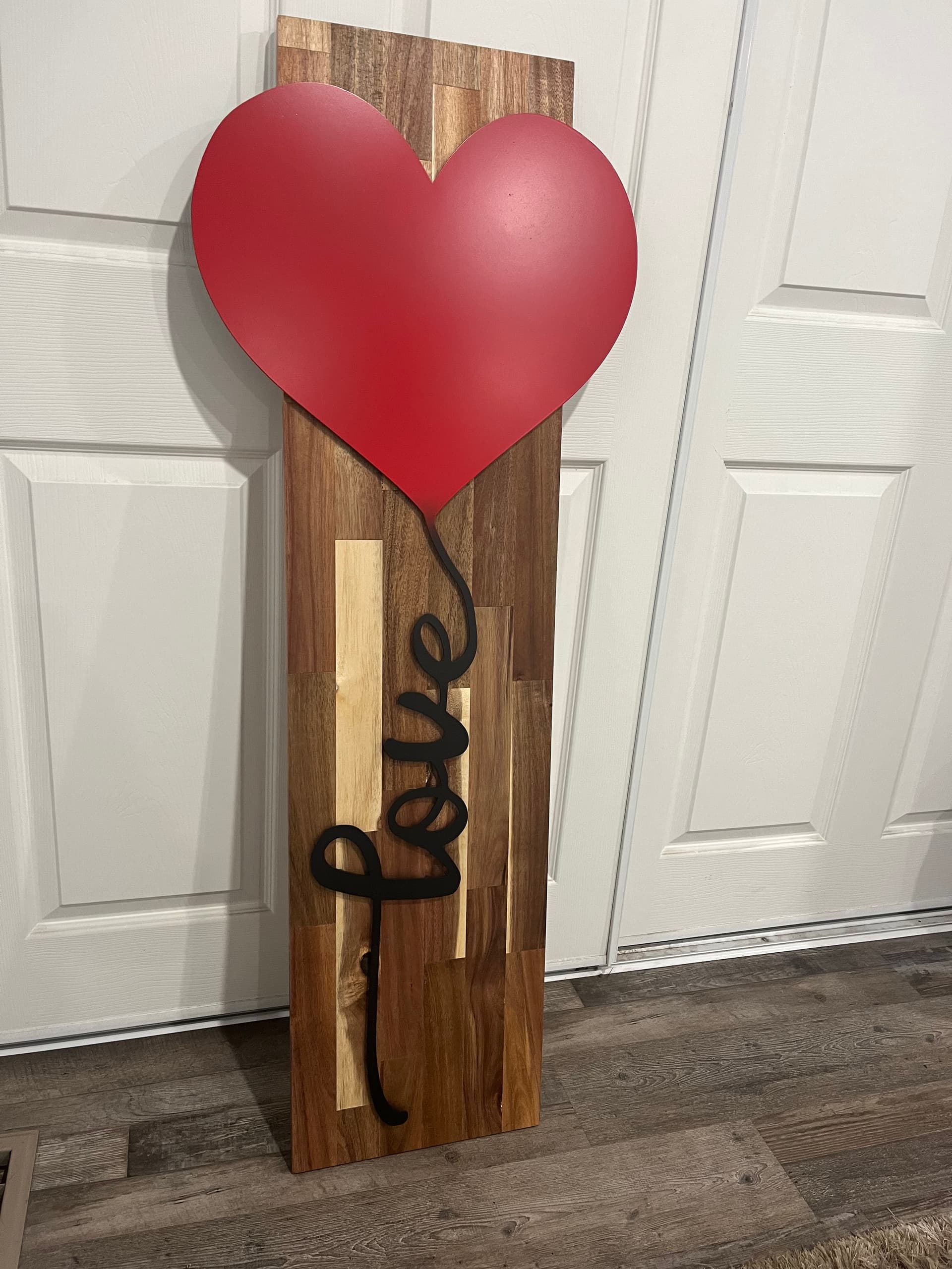

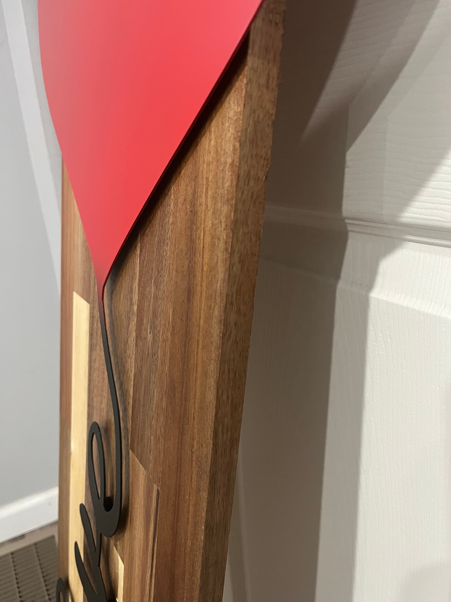

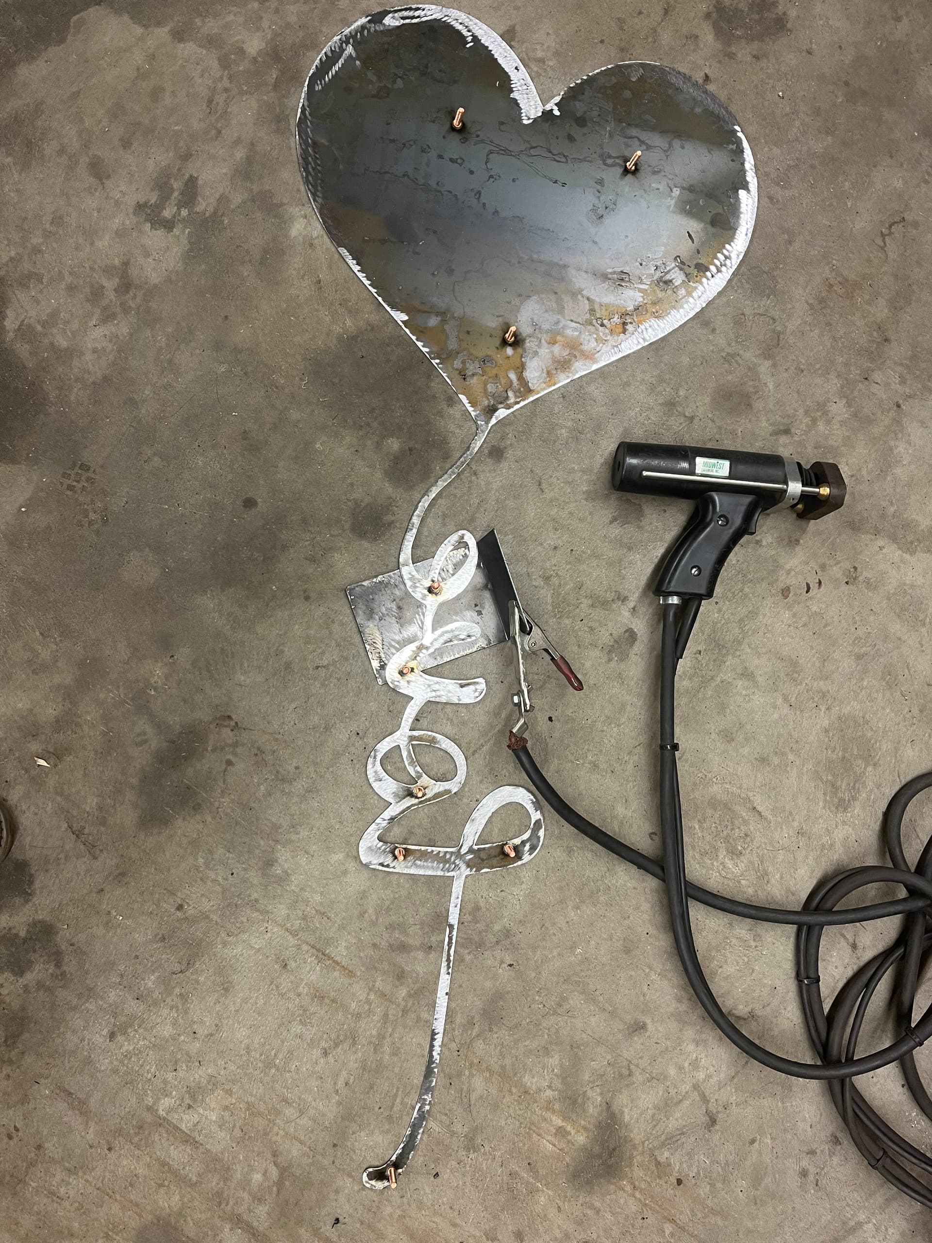

Last sign for me this year. I posted to fileshare if anyone wants it. Happy New Years Eve!
Heart balloon with Love string | FireShare | Langmuir Systems
I did not realize that was a video he posted and yes it worked for me also. thanks for pointing that out
Thanks for posting that I would have never tried that with out seeing someone do it first
As always @DonP you knocked it out of the park. Can’t wait to see what you make next year.

Yeah I’m generally crazy enough to try stupid stuff like that. The plates are .200 so I made sure they were flat and stable and set up for basically1/2" thickness. Bit of heavier dross on both sides of the bottom plate but cleaned up easy and meshed perfectly.
I’m like @Knick i would never have thought of that method. Thanks for posting!

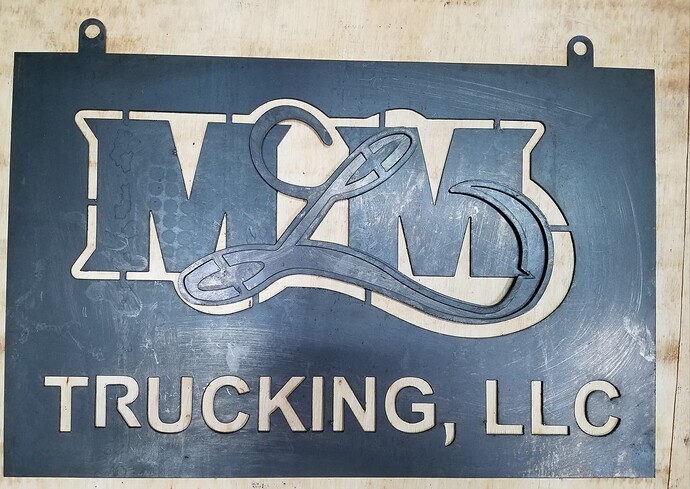

I cut this one out yesterday. A guy who I made a trucking sign for because he told me his son owned the company picked his sign up and then told me,… his daughter-in-law also had her own trucking company (can you say minority owned tax benefits) and asked if I’d make one for her side of the business. What could I say? Don’t want to cause a family squabble:
Her logo:
My rendition:

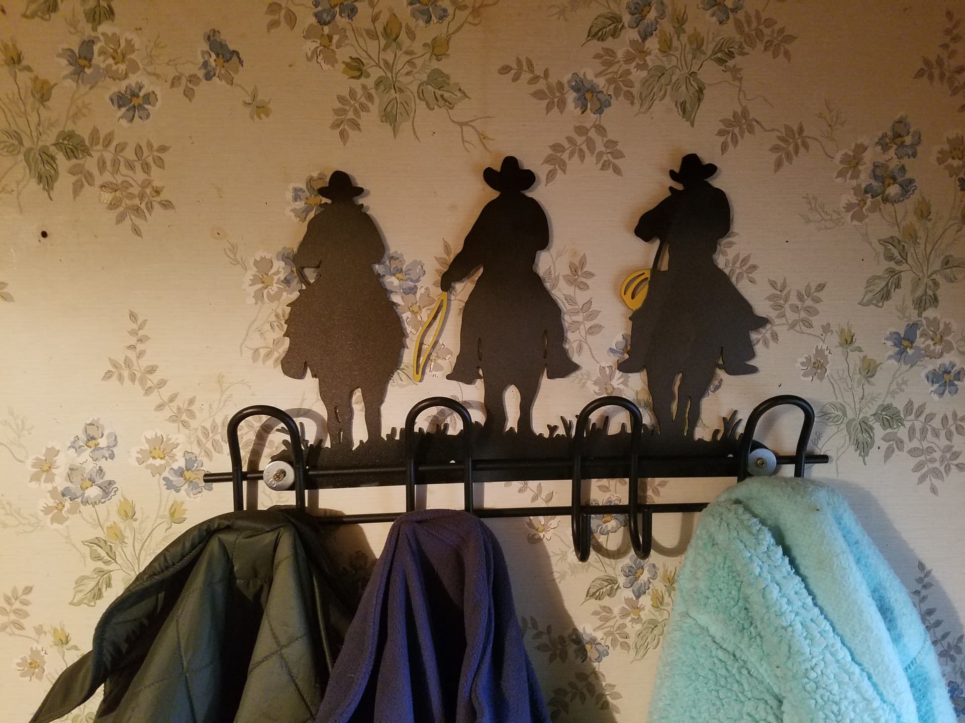

Also, got my mom and dad’s (cowboy movie fans) coat rack finished and hung inside kitchen door:
It’s straight. Pic is crooked :grin:

MLM…
Multi Level Marketing Trucking? :stuck_out_tongue_winking_eye::joy:
They both came out greet!

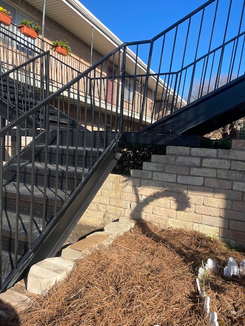

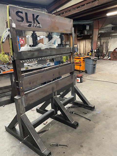

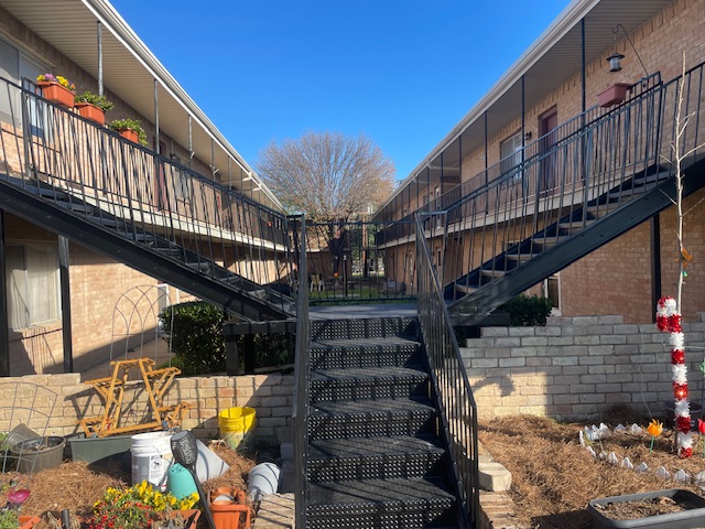

Haven’t posted in a while but here are a few of my most recent projects using my crossfire pro and the Xr. The press brake is a 60 inch 60 ton finger break combining 3 swag off-road kits. The stair tread were cut on the table. They are 44 inches wide and 3/16 tread broke on the custom built press brake.
IMG_2555
IMG_2504
IMG_2465
IMG_2398
IMG_2387
Beautiful job, as always! You have been busy.
How was/will the top surface of the stairs (be) finished?
Thank you Jim. They are painted with a good paint.

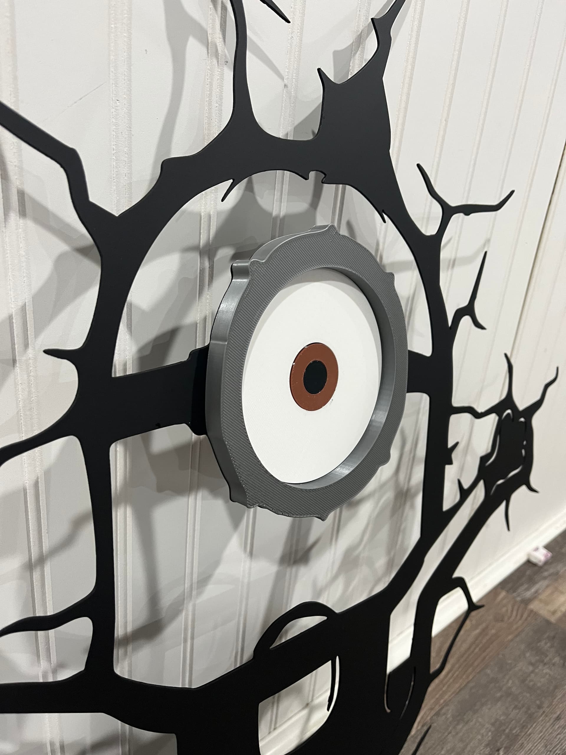

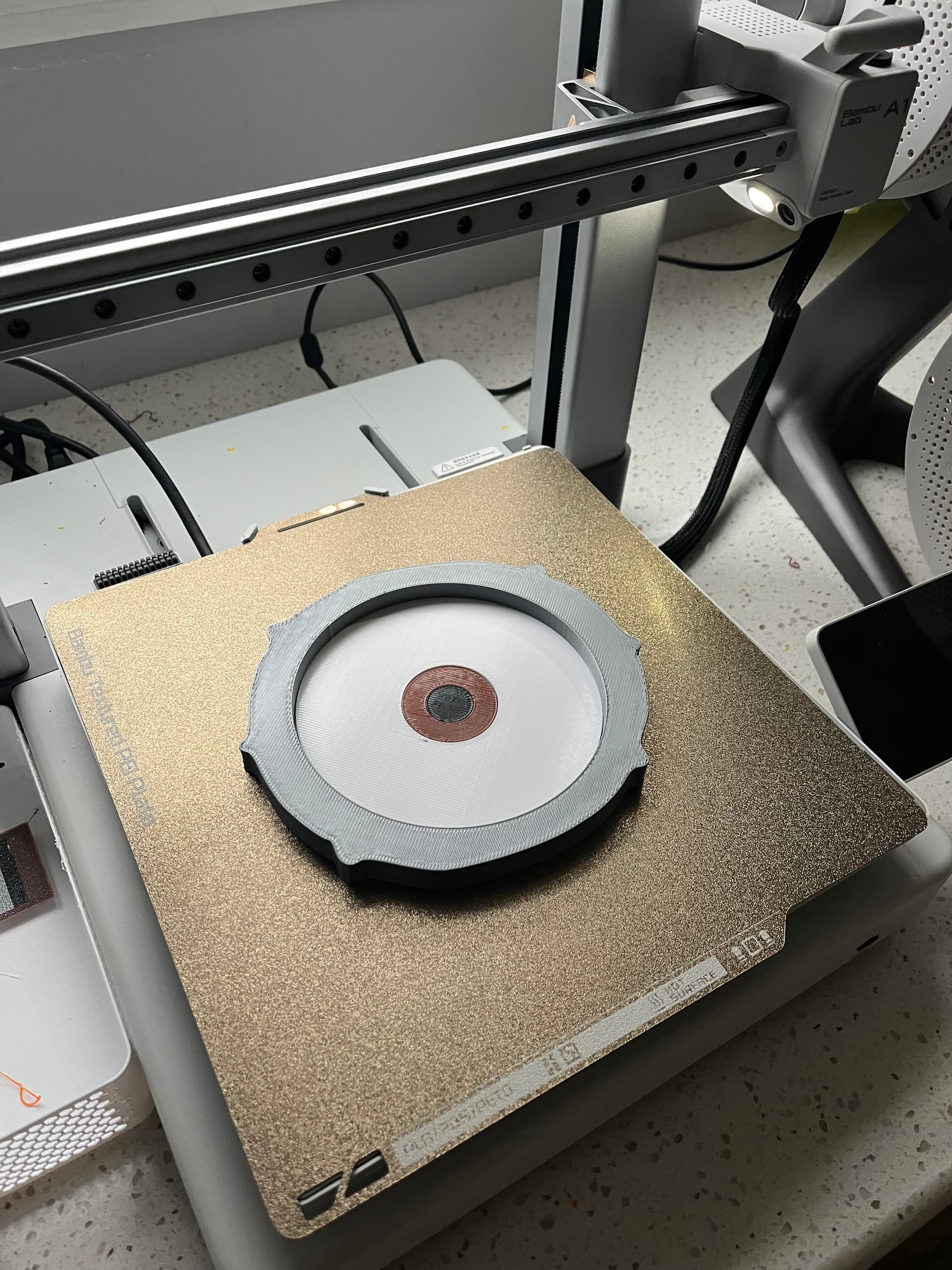

Did a fun sign with daughter today. I 3D printed my eye but added the DXF to fileshare.
Stuart from Minions | FireShare | Langmuir Systems

What kind of stud gun system are you using? It looks like maybe Midwest Fastener? Looking to purchase a system at some point.
