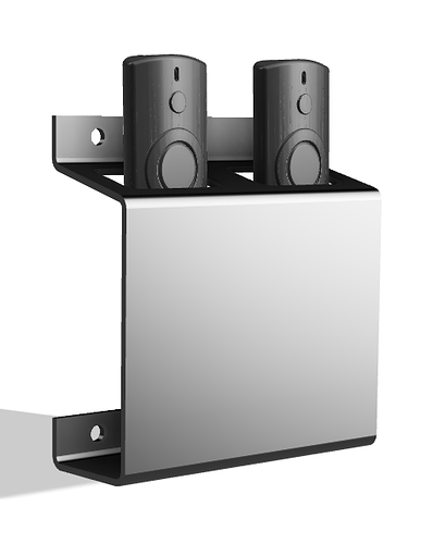

Heres a firestick remote tray render i whipped up in fusion today
May cut it this weekend tired of loosing the remotes

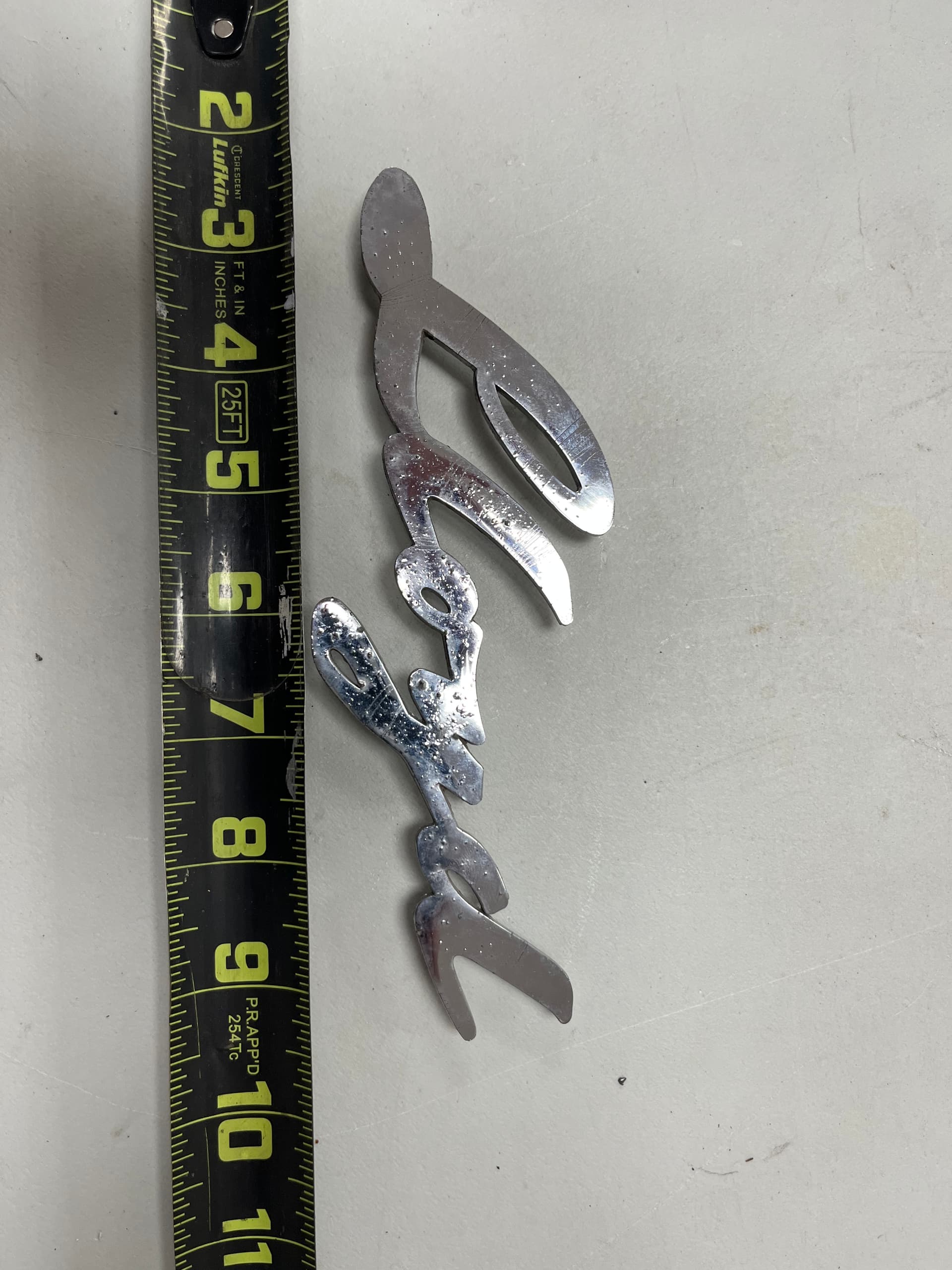

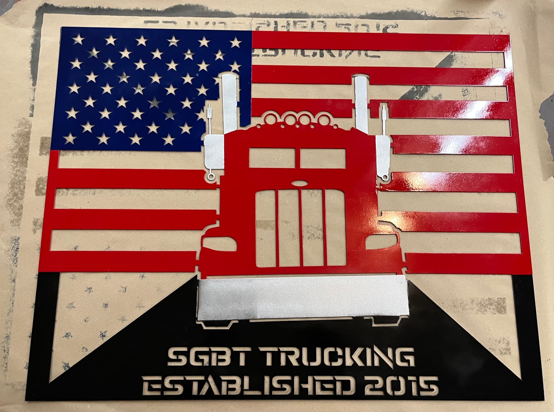

I can’t believe I forgot to take a picture of the finished Lloyd emblem. It turned out great for my first Stainless item. The trucking sign is from a picture he took of his own truck and sent me.

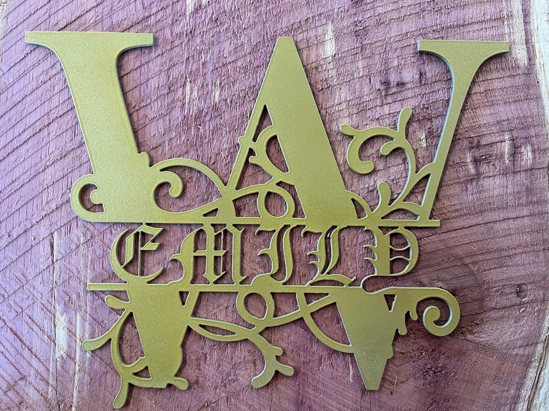

I used the “B” of that same font set that you have the “W”. I had to do a lot of work to it to prevent too much dropping out. Was the “W” the same?
Not really, but I had to do a lot to get it sized right, I think it started 600 inches.

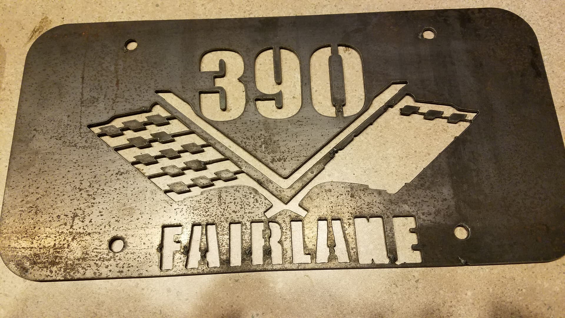

I created some scrap metal. First time I’ve cut anything since late November…long story. Anyway, also first time I tried to cut this license plate I designed for a friend who is restoring a 67 Fairlane with 390 V-8. Replica of front fender badge.
The drawing seems to be solid. My CAM setup had numerous errors. I learned not to take anything for granted. I had “mirrored” the left flag to the right side. For some reason, when F360 generated the tool path, it selected Outside for those mirrored elements, even though everything else except 2 letters in “Fairlane” generated inside, as I wanted.
My lead-in geometry stunk, as usual.
Think I have it ironed out. Going to make another try tomorrow.
18 gauge, 0.4 tip, 30 amps, 65psi, 3200mm/sec.

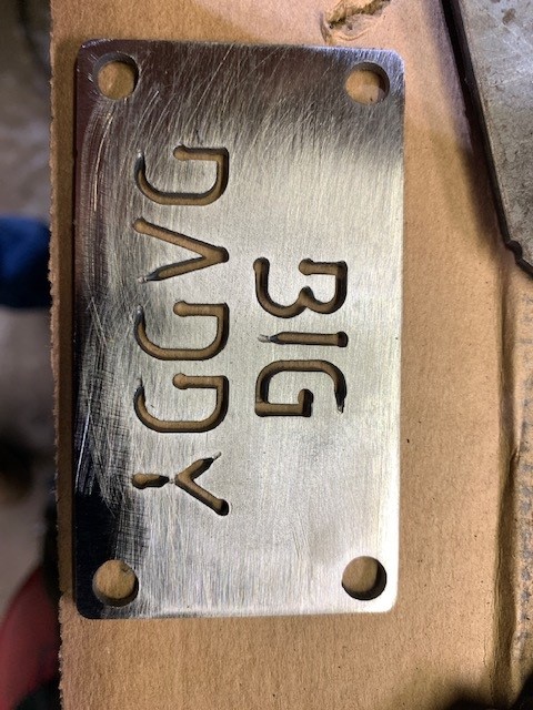

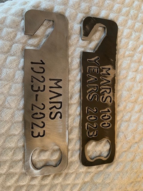

Business Cards and bottle openers. The Bottom opener is stainless I am still working on settings. Tin wisperer walked me through some things. Big thanks to him.
