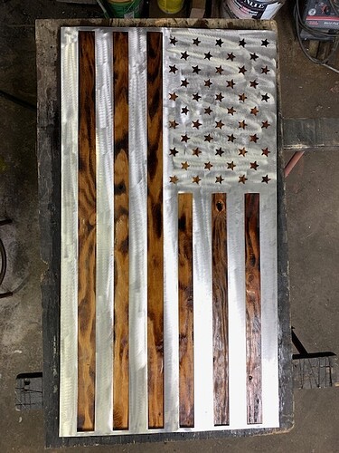

I cut out the flag from a very thin piece of aluminum. ( glad i bought the THC this stuff warps pretty bad) and am gluing it to a 3/4 piece of burnt plywood. If you look close the stars are not all cutting the same.
I have ordered new couplers and plan to change all of them I believe this is the problem. Any other thoughts on why this is happening? Thanks guys
Did you draw a star and replicate it or was this a converted svg/dxf that you inserted? If it’s an inserted image it may just be inaccurate line conversions.
May need to post the file and we can look at it.
I downloaded the file from fireshare. I had to fix just one of the stars and one of the stripes. I also scaled it up. Here is a closer picture of the stars. Some turn out nice and others not so nice.
Could you post the NC file or something that shows how the tool path were developed.
Seems like it could be a lead in or lead out or Pierce location issue or whether it’s cutting to the left of the line or on the line.
May even be a tolerance issue where it’s modified the geometry because of a tolerance setting.

American Flag big.nc (138.3 KB)
This is the file of the American flag like I said I did scale it up.
Flag passes
I ran it at 90 in/min but sped it up in Fire Control
I am using a Spectrum 625

90 ipm seems fast for cutting the stars. Did you cut your stars 60% slower then your straight lines?
You want to slow things down for small or tight geometry.
Also set your Tolerance to .001 no need for .0004 and your file will be much smaller.
Just slow your lead in speed down is what I do.
I have never set different speeds for leads, What do you look at to make the decision?
i have hypertherm 45xp and run 16ga steel at 150ipm and slow my lead-in speed down to 100ipm on all cuts. This is what works for me but not sure what the book says on this subject.
