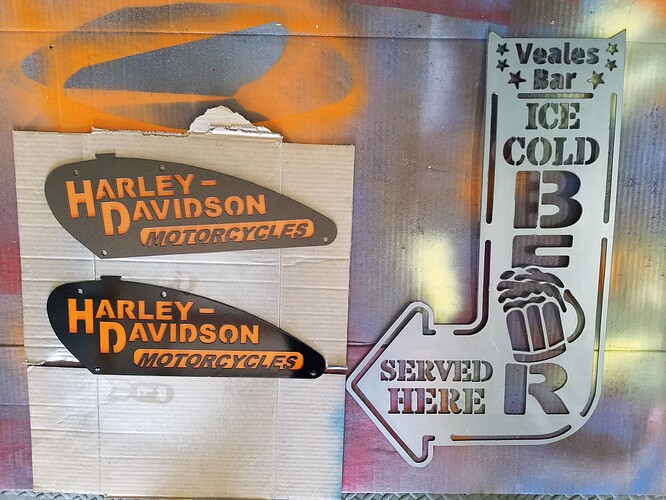

Out of the five I cut so far, only one had issues. For some reason the second “C” in motorcycles had a big blob on the sign side and also had several spots that didn’t cut through. I was able to salvage it.
I’m doing ghetto 3D on these ones for the craft show. I gotta recoat the black tomorrow. Bunch of dust on it.
I have a friend retiring in 6 weeks. He and his wife are major beer drinkers. I started one of the “Cold Beer Served Here” signs today. Got the easy part done!
Used 18 gauge because I don’t have a metal brake. Went okay but the connectors on some of the letters are so thin they are very frail. One already broke loose while I was wiping down the sign,

@DonP I cut out one of the beer signs for my friend today. I’m satisfied with it. But, quite a few of the letters didn’t quite cut all the way out and there were some of the lines that were wavy but should have been straight . If you decide to cut one, you may want to clean it up a bit. I was able to get it good though.
I am going to cut a backer plate with holes and use glued on bolts like I did on the Harley signs. Those bolts are really cheap and it’s easy to set them up that way.

I’ve been using a pea sized dab of two part epoxy. I rough up both surfaces. I’ll get a few pics when I do this one.
I like the bolt approach because it allows me to adjust the gap between the face and the backing plate. I noticed there is a sweet spot on the depth: too much and you get shadows; too little and it loses the affect.
I apply the glue/bolt and then assemble it so as to ensure they are glued in the right spot.
This is how they are adjustable. Just move the jam nut.

Here is how I make my backing plate and locate the holes. Just make a copy of the perimeter, add a few construction lines for vertical positioning, then pick area where the bolts will be most effective and least visible.
Beer Sign Holes
i make the holes on the original design copy and paste it next to it. then remove all things on my backer except the holes and remove the holes on the face of the sign. no measuring or line making.
BTW @DonP I falsely accused the file of having some issues since a lot of my letters didn’t fully cut/drop out. I looked this morning. I think it must have been my settings. Drawing looks well made.
