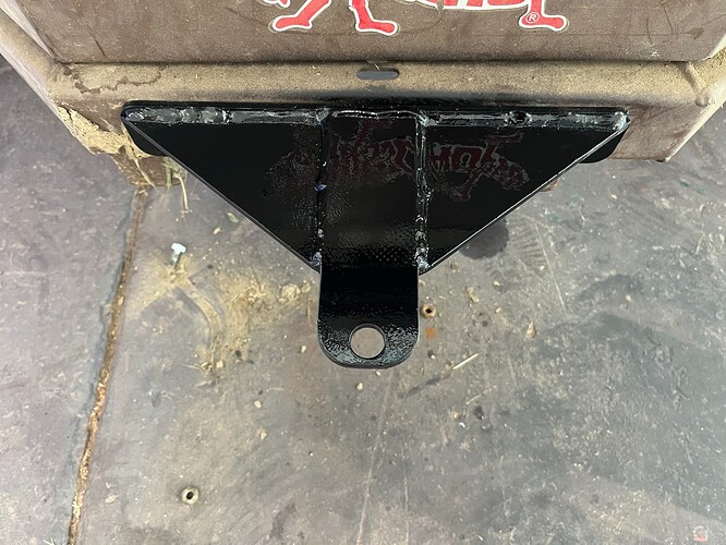

Think of how you normally use rivnuts then just put them in from the other side
:grin: Yeah, I get that. I was just wondering if the bolt install is from the back, meaning rivnut flange on the sign face, or am I missing something in his concept.
Like this?
Rivnut Install
I think what he’s doing is installing the rivnuts on the back plate from the back so they’re sticking out towards the face, then using screws through the front plate. In his second Pic if you zoom in on the rat you can see some screw heads.

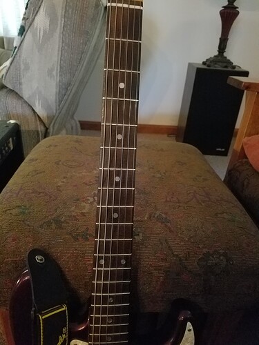

I pulled this design because i believe I need to do something different on the neck of the guitar. Maybe its just the paint that makes it stand out. I could just continue the sunset imagine like most of the designs on the market but was trying to add the strings. Any ideas?
You could cut slits to represent the frets and then add a black or bronze backing plate to give some contrast on the neck…
Also you could cut out and back the dots on the neck, Here is a pic of the neck of my Stratocaster (replica).
You could create tuning pegs with rivnuts. Drill a hole in each machine screws and actually turn a few turns of string around the machine screw.
