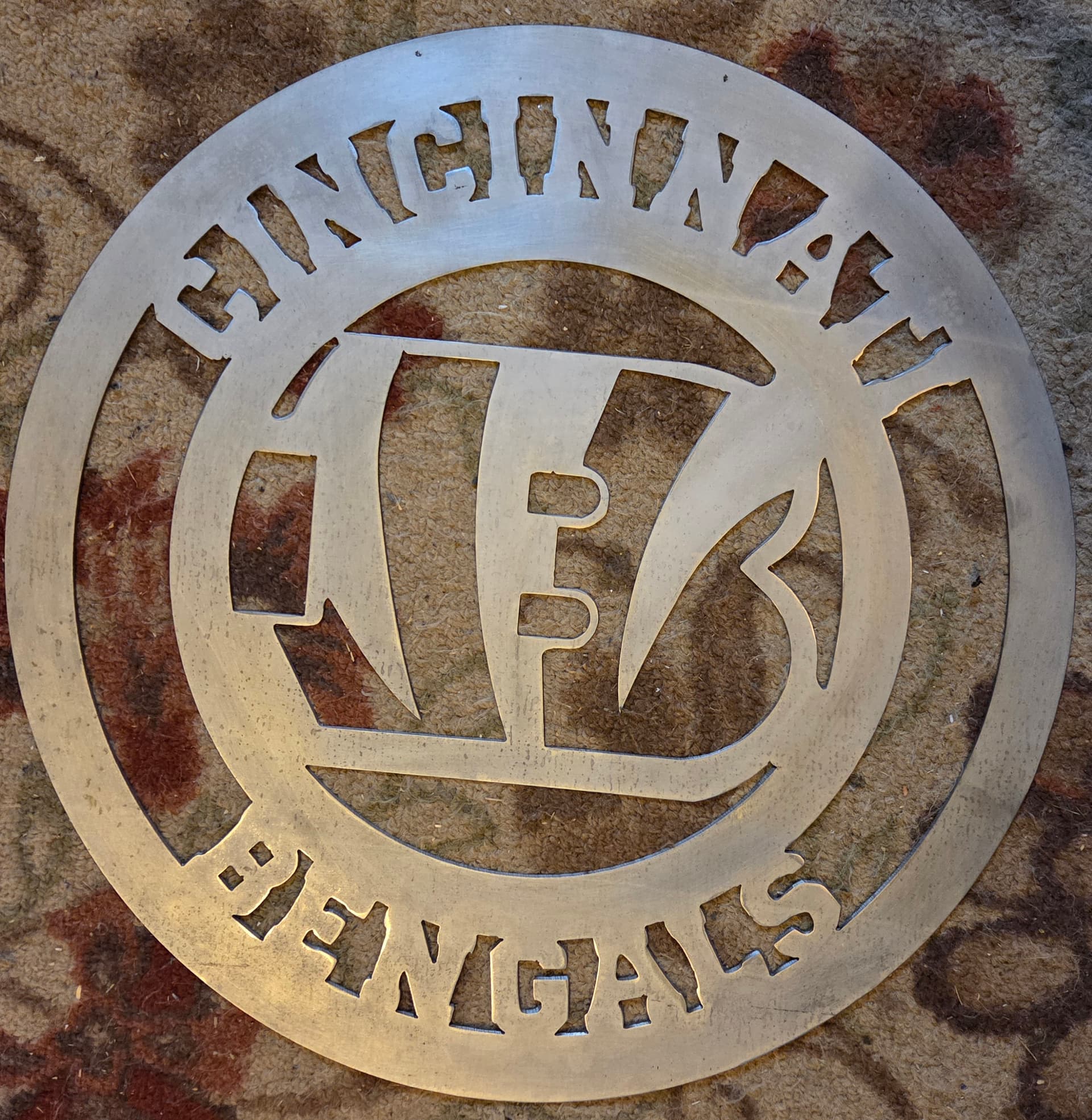

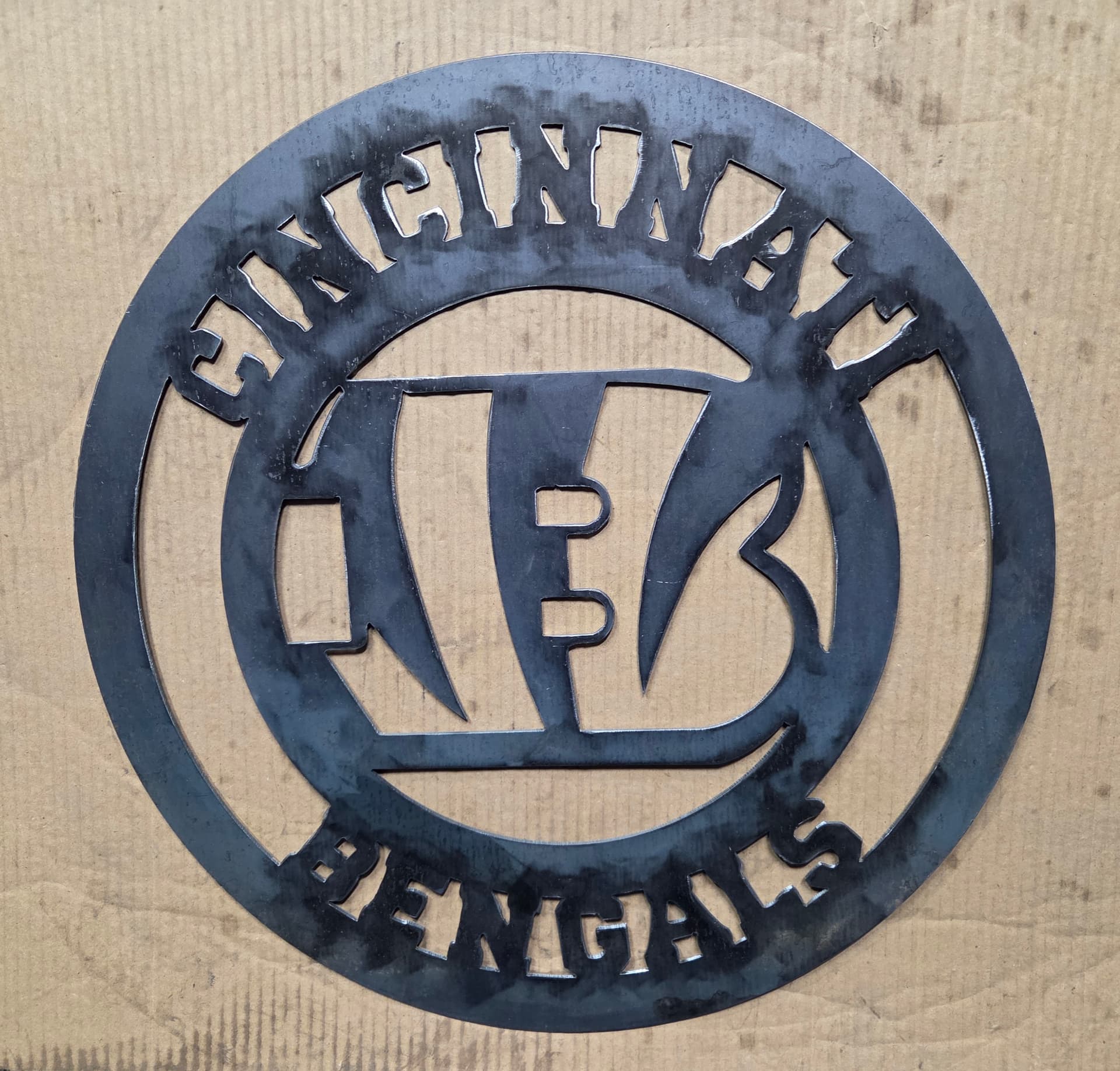

No I meant I was amazed you could cut something so narrow without it melting off. I get nervous when something is less than 2mm wide.
You gotta live life on the edge man! :rofl:
Oh, thanks. To be honest I just wing it and sometimes it works and sometimes it doesn’t. I don’t typically make signs with the machine however, I usually make car parts, so I don’t cut things that sharp very often. I got lucky with that cut up until I bent it trying to keep it from hitting the floor.
Lesson there is that I should not be dropping things.
I understand being concerned about that though. Sharp corners and tight spaces make for some interesting times with a plasma cutter.

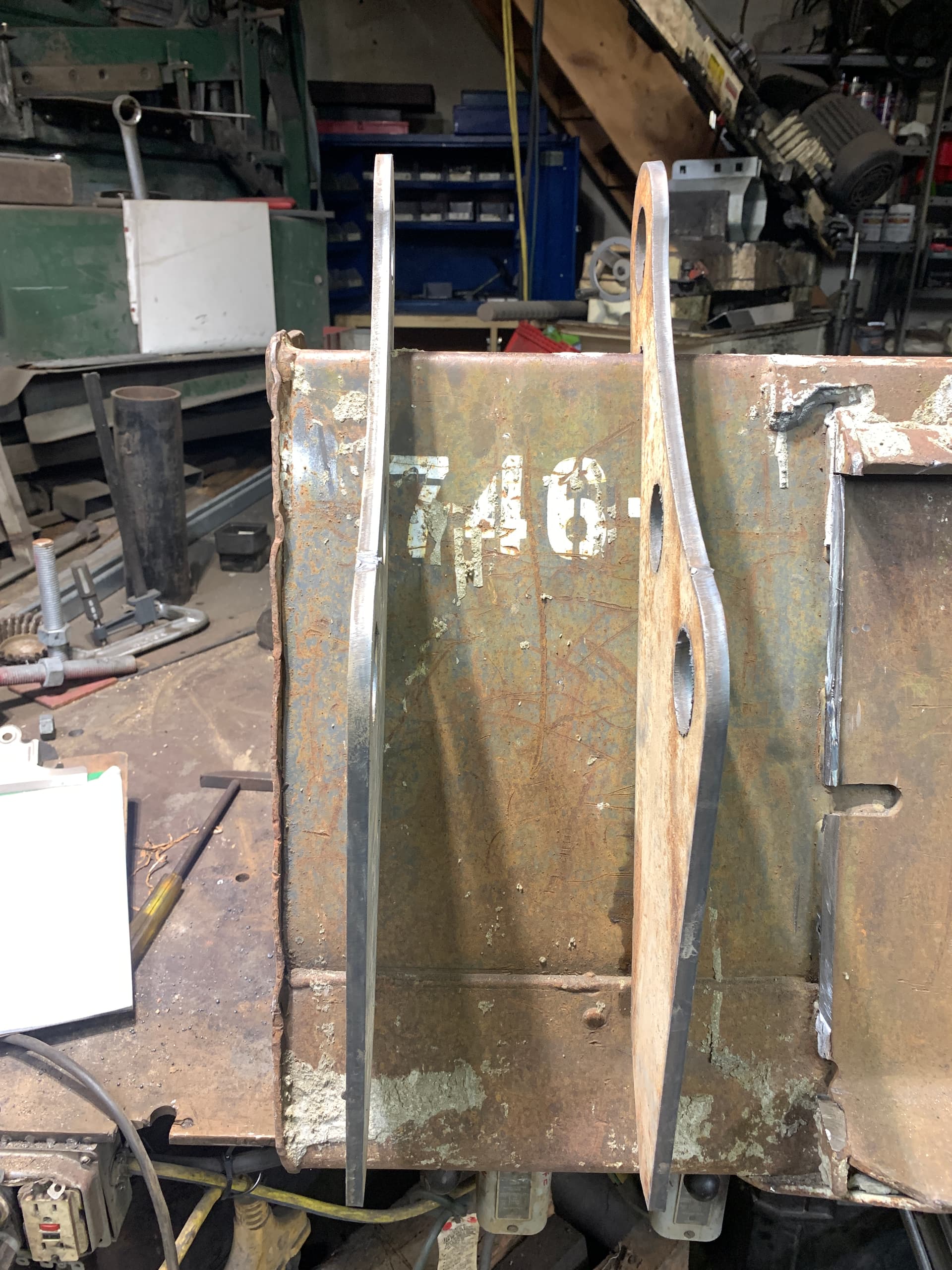

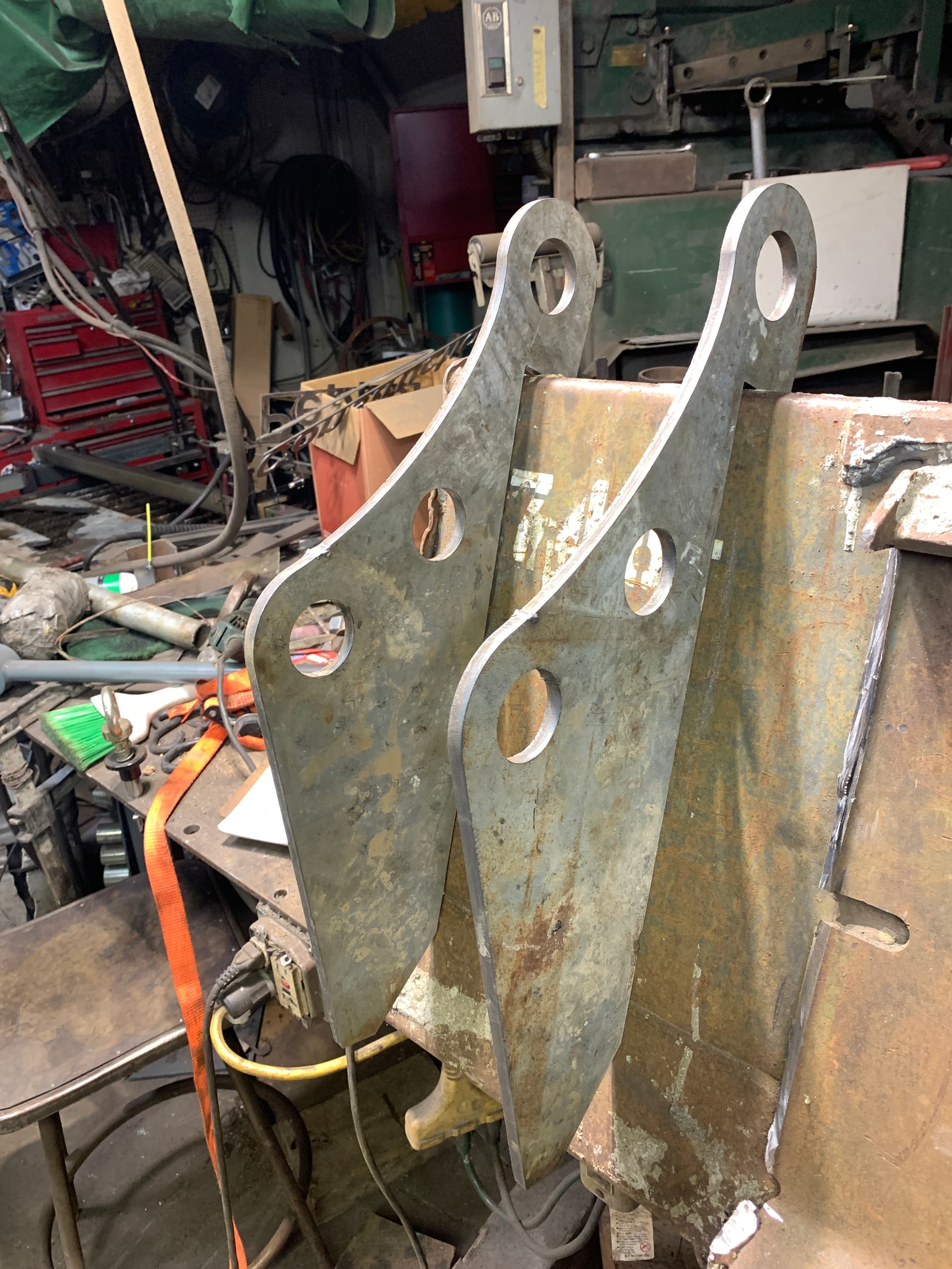

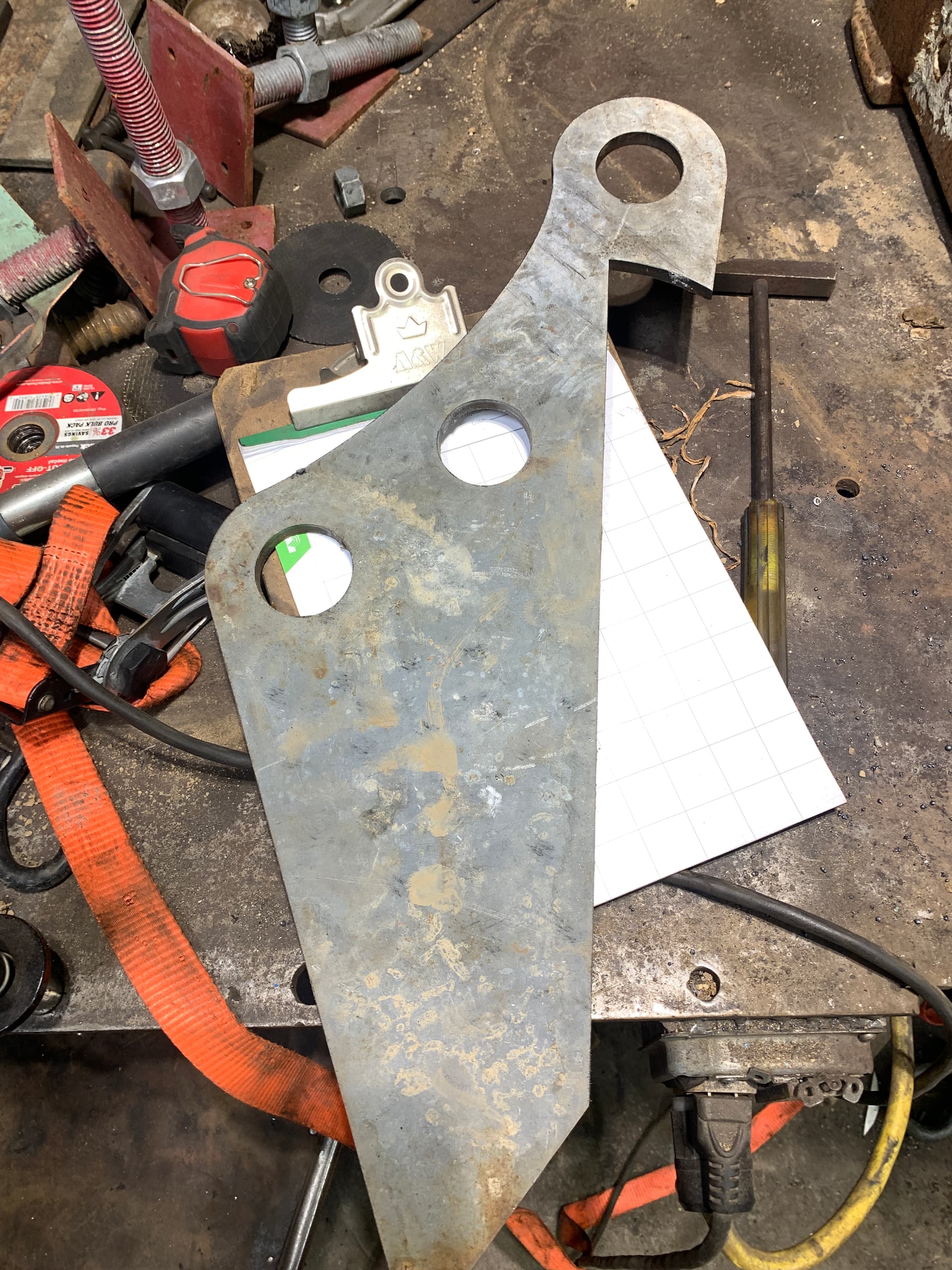

Made some ears for a bucket I am fabricating out of an old smooth skidsteer bucket to go on my mini excavator. 3/8” steel, Miller 625 hand torch. I still need to make some bushings for my pin size. 3/8” might be a little thin but I plan on welding some gussets on the sides of the ears. 3/8” is what I had and I don’t know how well my Miller would cut 1/2”
I’ve learned to drill or machine the holes for pins, especially on thicker than quarter inch…especially on 1 inch plate
Play with your torch height.
I used a value of -0.2 in that item and 100ipm.

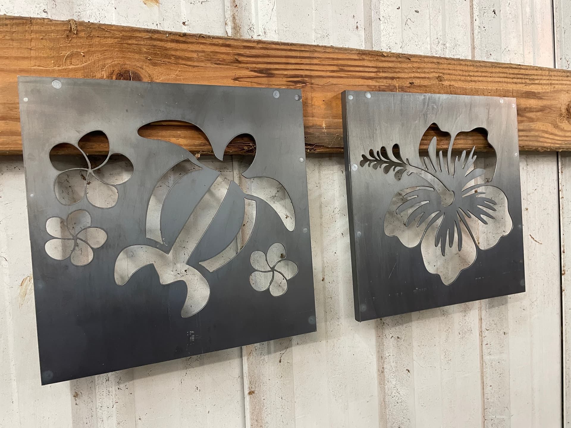

Most recent project. Similar to the fern panels but the feel of our Hawaii trips. I was also learning a bit more about inkscape conversions.

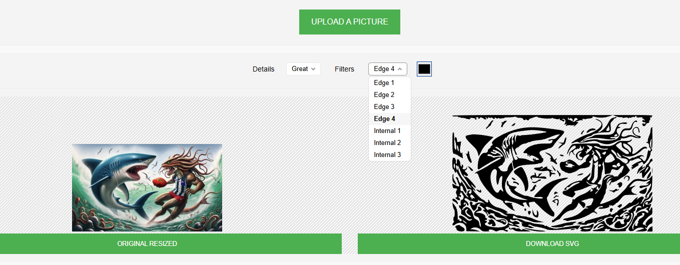

Here is a free website that does a decent job of getting you started toward the silhouette that you need for 2 color pictures.
Here is an example I just did:

My buddy Alix went into Chat GTP and typed out a description of the image that he wanted, and he stated in his description that he wanted it to create the clean end file that could be converted to a DXF or SVG file.
He then said something about uploading an image of the dog that Chat GTP used to create a cut ready file. In the original post I put in there that he sent me a DXF file, but going back through my saved images I found that he sent me a PNG that I used in a converter to create the DXF so I could put it into Fusion 360.
So basically he just had Chat GPT create a custom clean clip art. Then I used an online free program called Convertio that converted the image to one that could be used in Fusion. Convertio will convert to several different formats, but I only use it for DXF or SVG.
A couple of extra steps but it converted really well the first time and did not require any clean up on my end to get a decent cut out of.
I know nothing about those AI programs so beyond that I probably could not answer questions. If you have any about Chat GTP though I am willing to contact Alix and ask him - if that would help you out at all.
look at this post - Victor - Image to Cuttable Vector
