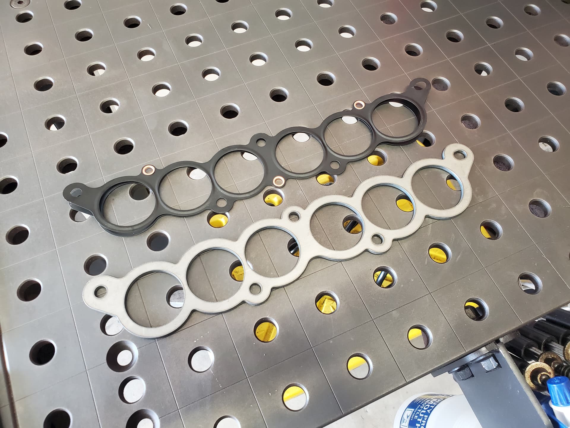

This is the part I’m cutting out from aluminum.
This is 10 gauge mild so large holes and exterior done at 90ipm, with the smallest holes done at 50ipm or so (I forget, made for mock up).
Book says 36ipm for 3/8", only problem is the piece of aluminum I was provided doesn’t have enough excess material to do test pieces like I normally would. Going to have to take a shot in the dark for the small holes.
Otherwise I would’ve done test cuts and refrained from posting lol

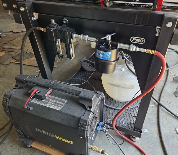

I finally added a Motor Guard filter to my system today. Even with all of the drying I have on my system, my consumables still showed signs of moisture reaching them. Hopefully this will put an end to that. BTW, I know my bead canister is small but I service it often.
You can see the rest in the background: tank to oil/water sep; to deraille cooler with fan; to copper piping; to HF chiller; and then to the area shown in above pic.
