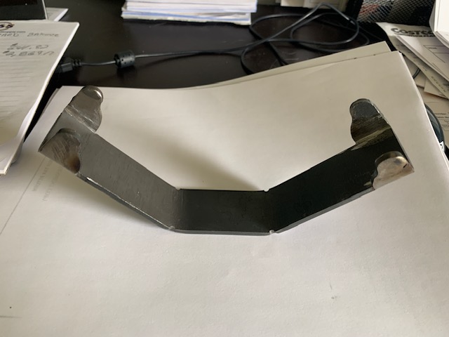

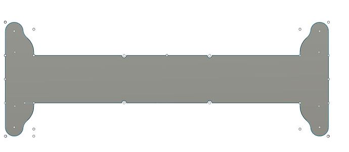

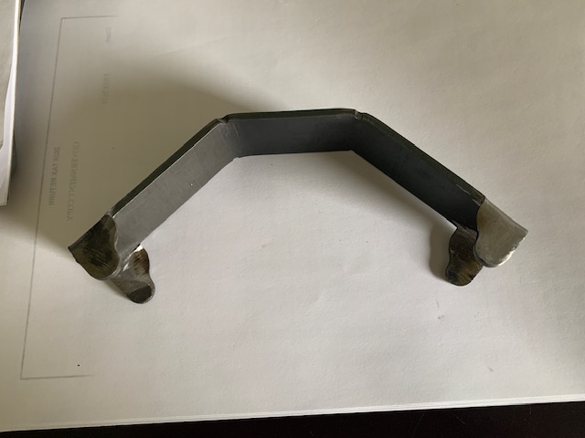

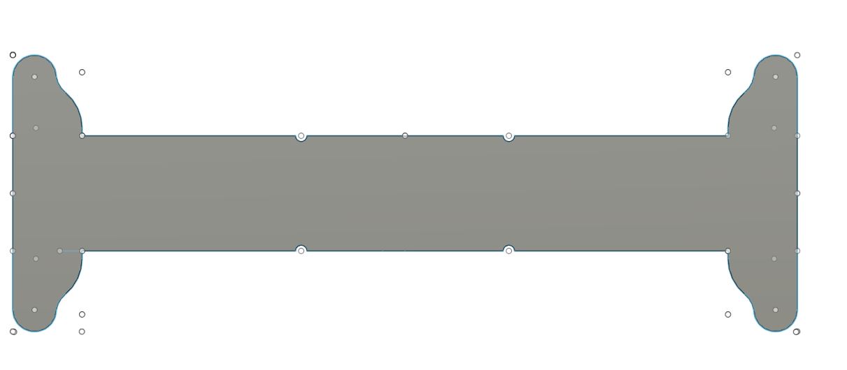

Well this may be a small feat for some but if all goes well it will be only my second paying job. Its been almost two years of owning my Pro, I am staring to justify the purchase. :stuck_out_tongue_winking_eye: I need to make 10 more. Its part of an adjustment tool to align solar panels. Any suggestions on bending them with more accuracy without buying a Titan? I am currently using an Ironworker.
Only 10? Make a template and rinse & repeat.

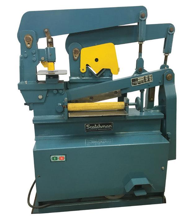

Don’t know what an ironworker is…I was under the impression that was a profession?
I like using a small press brake for precise bending. A backstop comes in handy for just tossing it in and hitting the foot pedal.
A fairly common piece of equipment in most industrial metalworking shops.

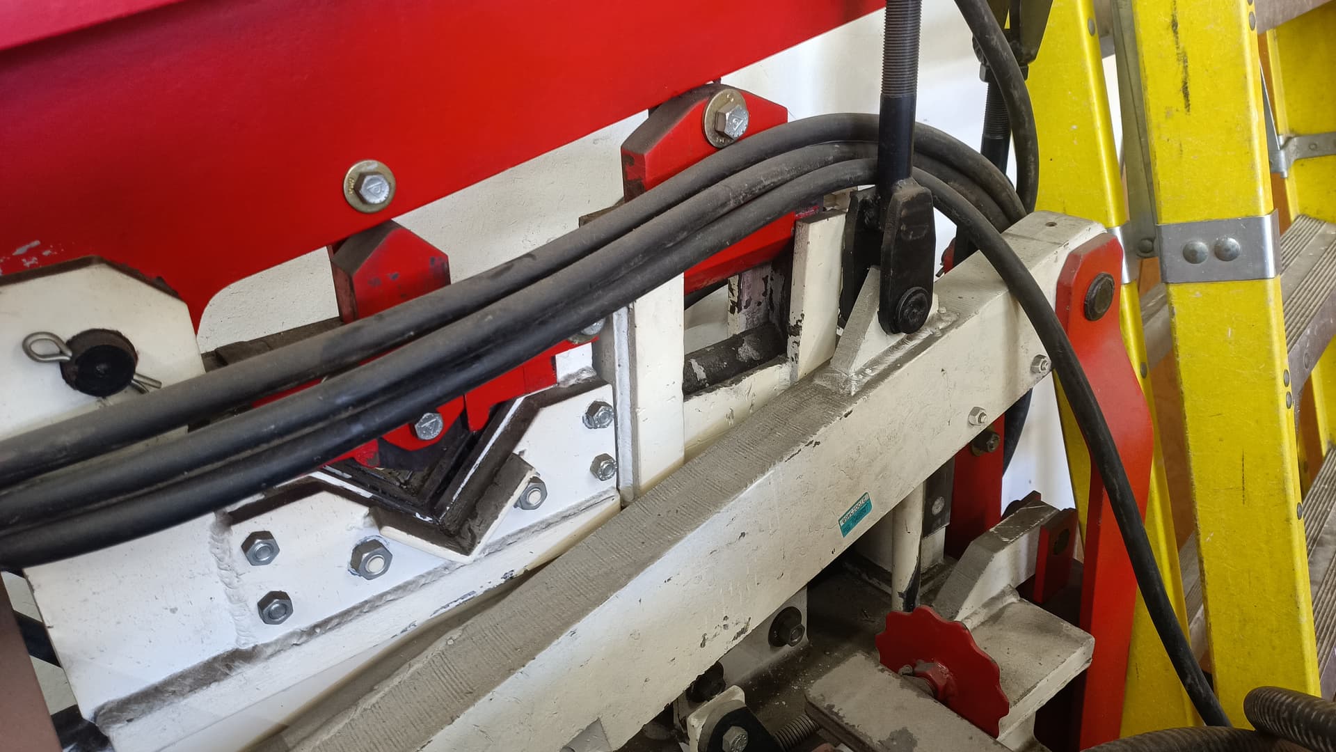

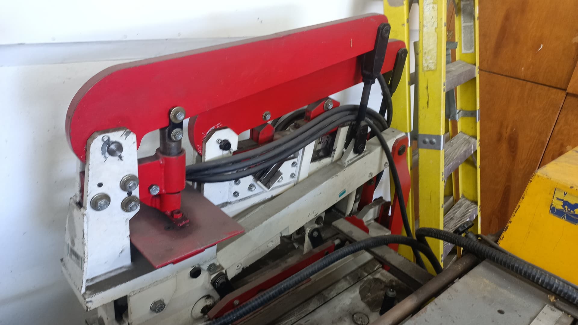

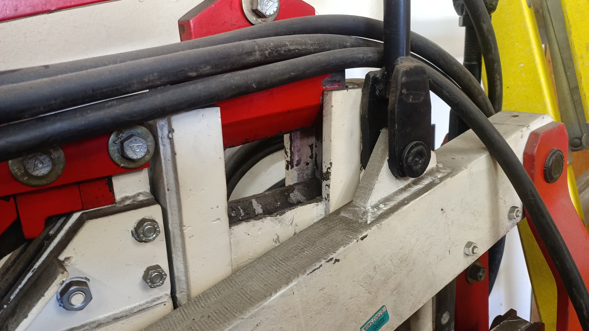

I happen to have an old Scotchman in my shop. Mine’s a lot more beat up than this.
Some of them like mine will have a little brake that’s one of the options.
Edit.
Here’s some picture of my old girl.
On casters and comes out when she’s needed

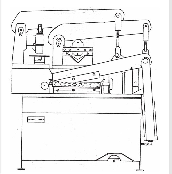

Yep that is it. model 314 mine is also pretty beat up I have made a lot of railings with mine. I use the punch more than anything. Here is a pic from the original owners manual. its an old machine but still works great.

If it has a brake attachment, I can’t see how “more accuracy” is needed? Just the right punch and die!
I have an old manual for mine as well.
