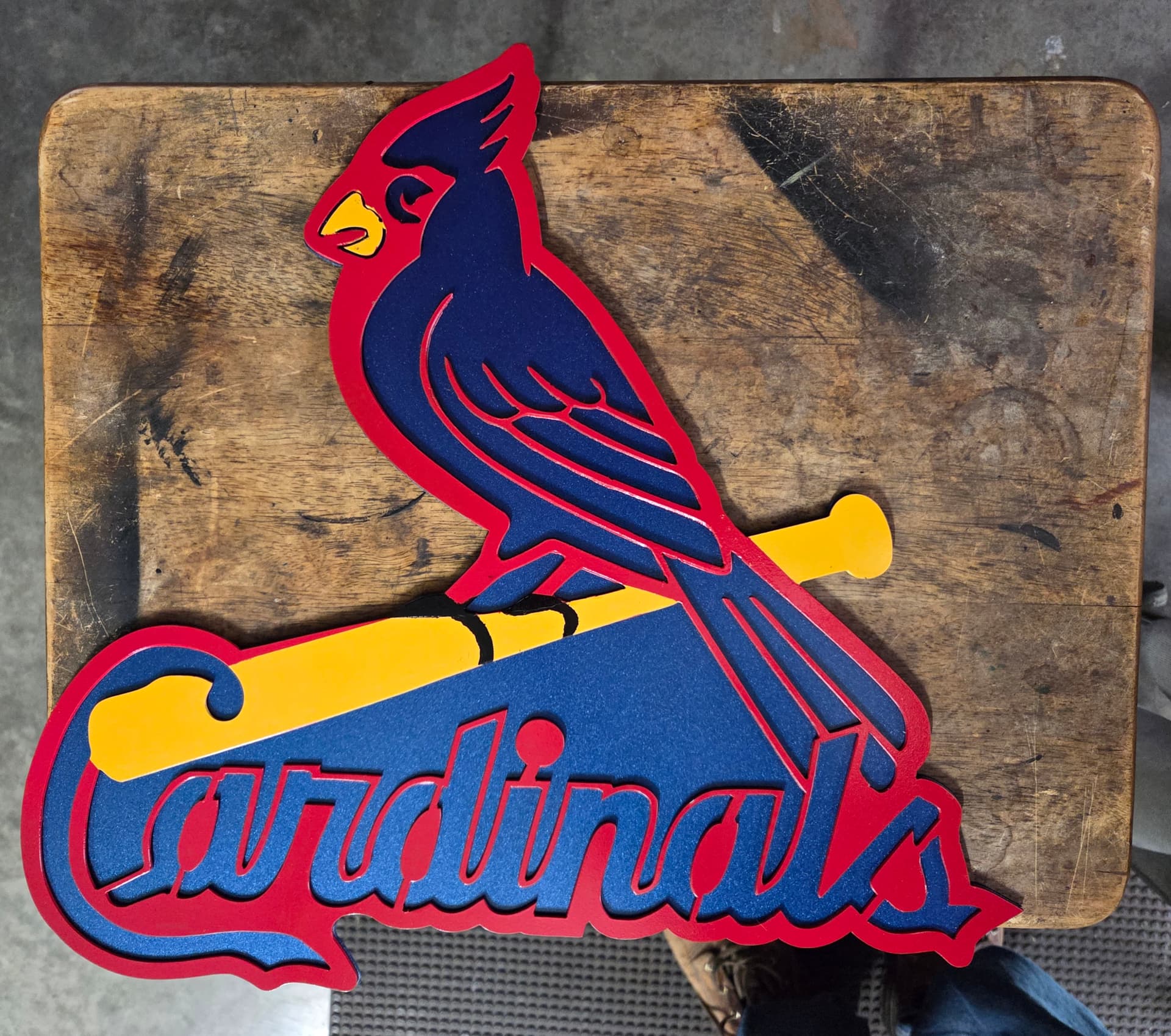

Cut this out for a friend who is a big St Louis Cardinals fan.

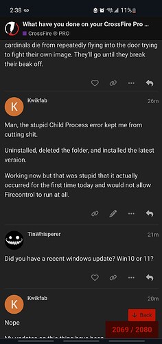

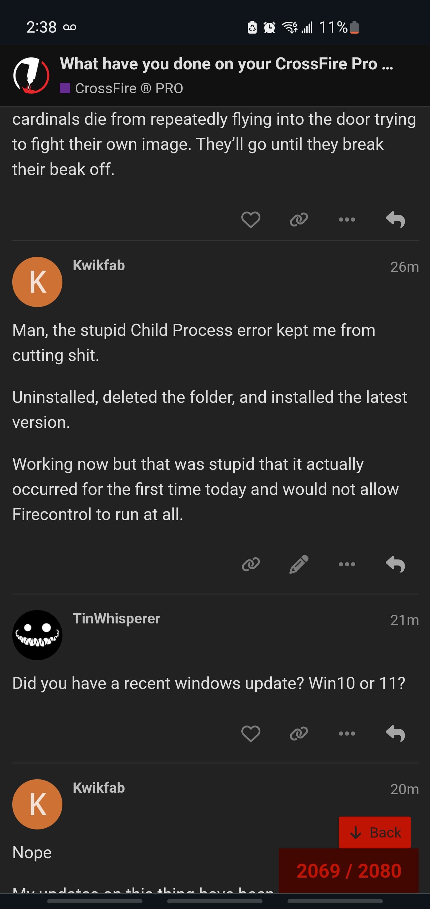

Man, the stupid Child Process error kept me from cutting shit.
Uninstalled, deleted the folder, and installed the latest version.
Working now but that was stupid that it actually occurred for the first time today and would not allow Firecontrol to run at all.
Did you have a recent windows update? Win10 or 11?
Nope
My updates on this thing have been shut off for years.
W11

Child process means it is missing a file or command line. Reload FireControl. Just make sure you get all the file folder it uses.
Only after an uninstall and deletion of the .Firecontrol folder did it work again with the latest Firecontrol.
Been running 21.1.5 for the longest. Now I’m on the new version, works again.
