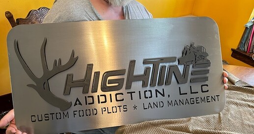

Just finished my layered pole barn signs I started this morning. Cleaned the water table so back to designing for few days. I would love to see more of people layered signs or 3D yard art and might give me some ideas for other stuff to make around my house.

Don, I’d be interested in hearing about your process using the stud gun… I’ve thought about this a few times but, I’ve gone the route of making several layers on the drawing with “drill points” that align in each layer… Then, drilling, tapping, welding(mig) studs, grinding, painting, and assembling… this helps 100% in aligning the letters at the assembly stage…
How does the stud gun method get that accurracy so things dont get out of alignment?
Always looking for new ideas here!! Example below…

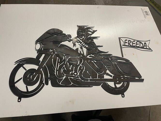

That’s great question. When you design the sign you add all your hole locations on backer and cut the outside edge exactly the same as your backer. this way all you do is lay your front cutout with all the letters or pieces so there perfect. no messing your trying to make it straight. it does cost you a little extra metal sometime but trying to get things lined up is tough. Most of the time fronts and backs meet up like the Harley sign. I use stud welder because it don’t leave marks on the front of the sign. It’s awesome but crazy expensive for hobbyist. Maybe for a business it would be no problem but i found myself a used one for reasonable amount. Let me know if you have any other questions. Happy to help
@DonP
So, do you weld your studs to the letters through the holes in your pre-drilled backer then?
And YES!!! the stud welder would save TONS of time!!
Yes…I have the holes sizing dialed in so i don’t even need to mark the holes and remove the backer. Just shoot them through the cut holes into pieces you plan on fixing to sign. Keep making cool stuff
A funny video i watched a few months ago said when you have more money than time you buy a stud welder.
Awesome!!! That clears it up for me… Guess what I’m shopping for now?!?
Thanks for the insight Don!!
The template for spacing letters isn’t always waste. We plan on using double sided tape and sticking on the way also. The cutouts like the center of the “D” do drop out but same thing with sticking to wall in correct position.
For people not wanting to spend the money for stud welder you can do layered signs with strong adhesive but lose the appearance off it standing away from backer and ability to remove later. i do want they call gorilla welding very strong but ugly. So when i started to tack bolts to the back i would mess up the face of my signs. i do hope this helps
I have been using rivnuts on some of my multilayer signs, i install the rivnuts backwards on the back layer and they provide a connection point and set stand off distance. I make peck marks in my designs then drill to appropriate sizes. Another method I have used before incorporating the peck marks was to lay the layers on top of each other and simply drill pilot holes. Again this insured perfect alignment. Amazon has tons of screwhead types so you can pick the ones that work well with the feel of your design. You can also weld the rivnuts on and use them as hidden connections as well. The awesome aspect from my experience is no welding on mostly finished signs that are multi colored risking damaging finishes. And if paint does get screwed up it’s super easy to disassemble and repair then bolt back together.
As a former Harley owner I endorse this message!
