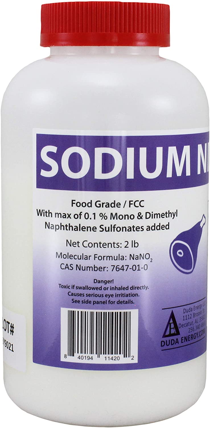

sorry for more questions about this…i have looked at Amazon for the Nitrite…they have 2lb food grade (pic) for $21.18 and
which says used in manufacturing…but then there is a 4oz fine granular one for $19…I’m not being picky about price, but wonder if the 4oz one is not like the other…also found a bagged one pound says Chemically pure for $16.99 …so the “type” is what i am making sure with you on what i need. SX342 nothing on amazon says Anti-rust additive…thank you in advance!
You want to get reagent grade, pure Sodium Nitrite, with no additives and, if you’re going to get more than 4 ounces, get it in a container that’s resealable because that’s all you’ll use for a long while.
I got this one as well. I like that it said “Food Grade” made importation so much easier! :rofl:
At first they sent the wrong thing (Potassium Hydroxide). Paid a lot to clear it and dispose of it and it gave the lady a bad skin rash, when messing with it, necessitating a trip to the ER.
thank for the heads up…I checked we got the Food Grade…wowl….don’t need a trip to the ER at this point…

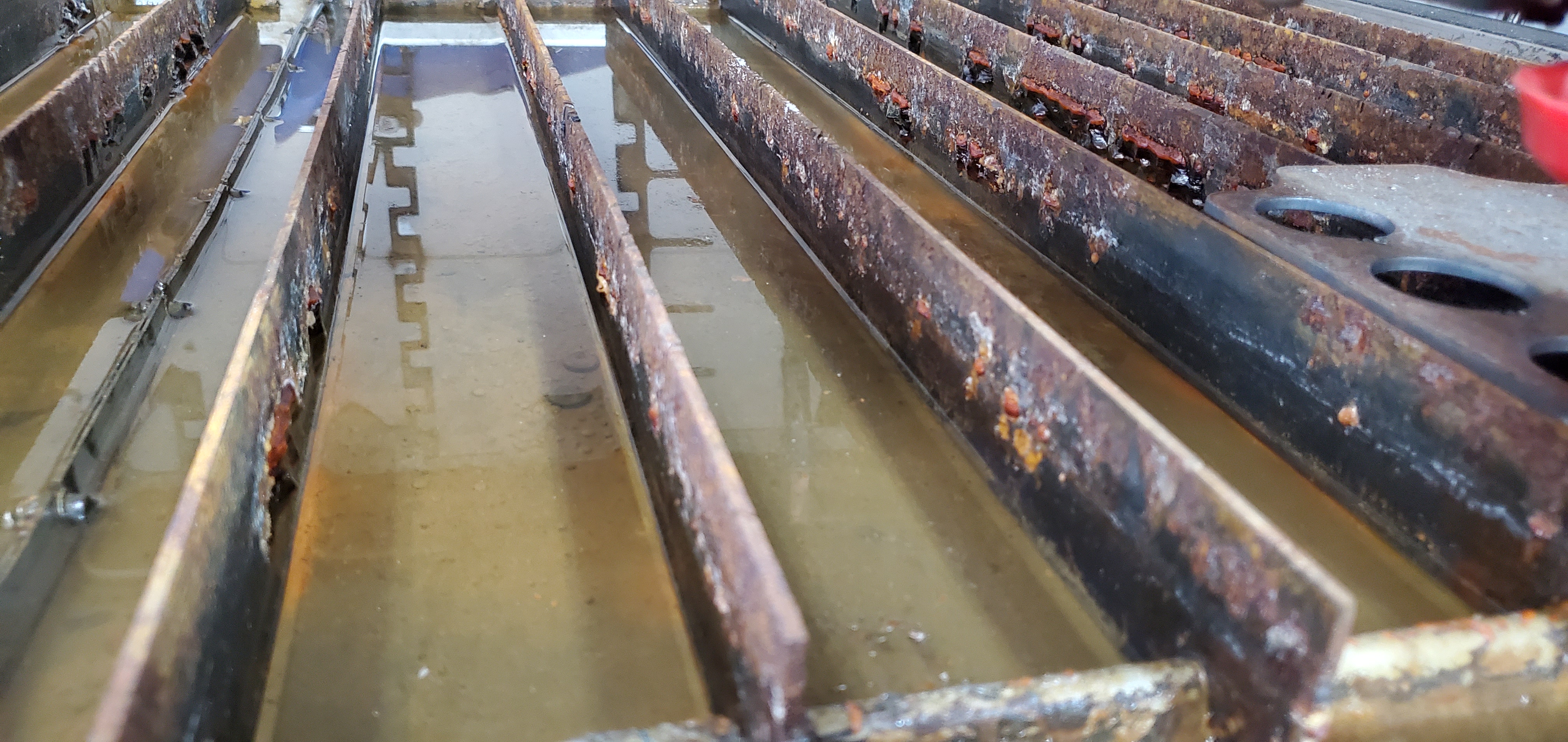

I make a ton of sausage, smoked fish and jerky so i always have a bag of pink curing salts on hand. But ive only used borax in my table water. Ive tried different things but it always turns to a red rusty mess no matter.
So, does the Borax work well?
looks like it was brought up from the Titanic
Did you test the pH?
No, i havent rested it. My water is already between 7 and 8 from the well.
