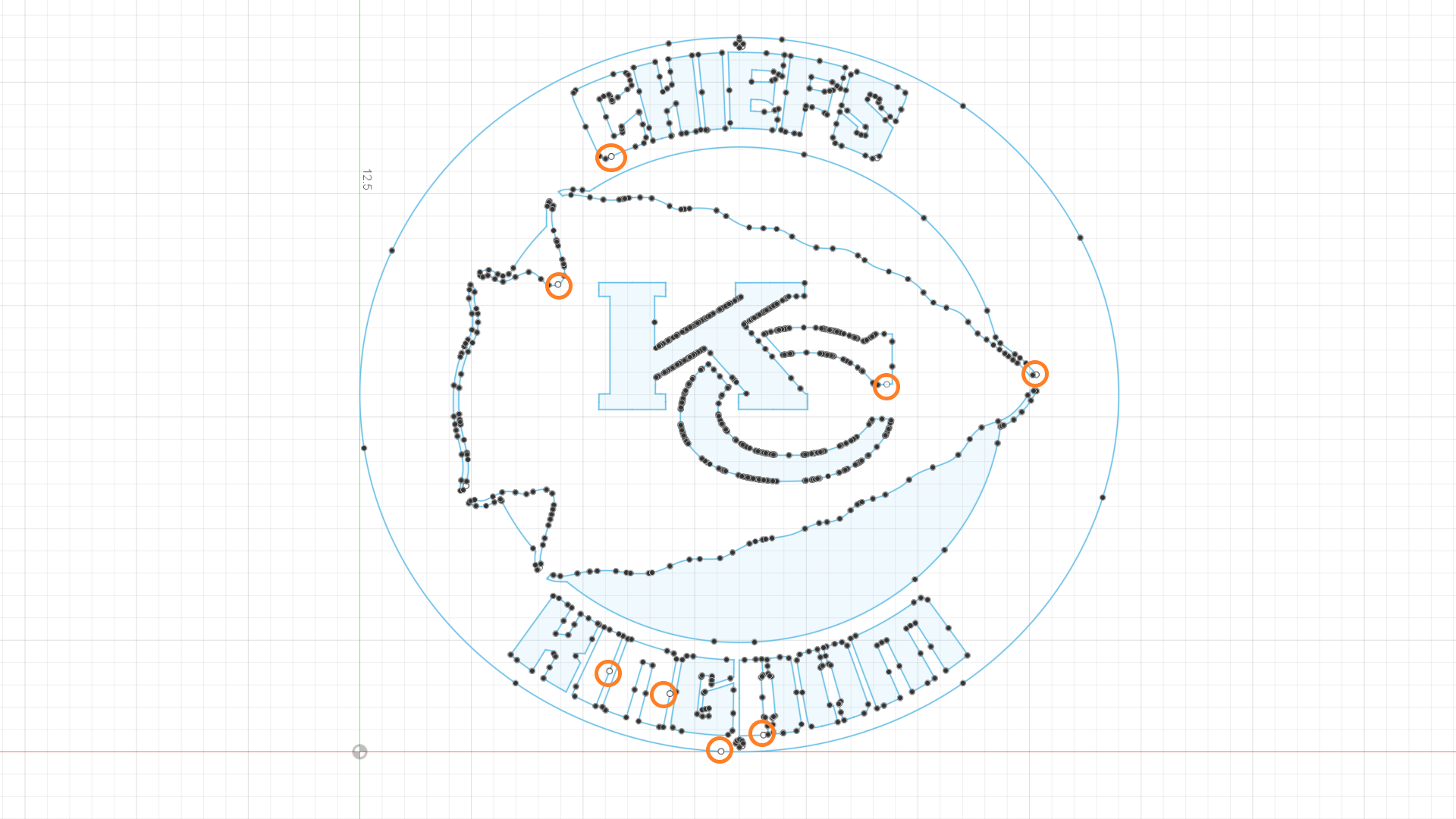

Here are the screen grabs
Here there are several open contours

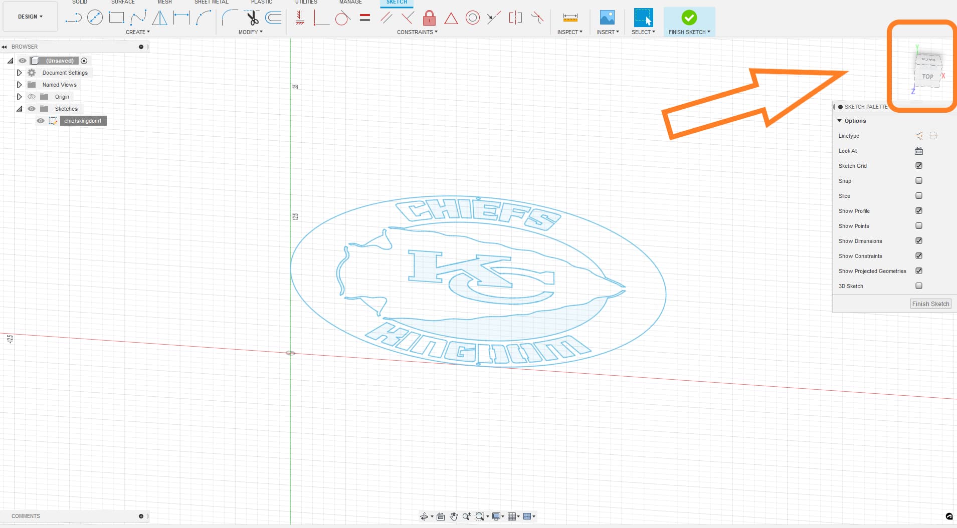

here shows the odd orientation of the dxf to the XY plane. It is XZ plane with Y down? which is weird.
I would like to see the original DXF file to see what happening there or it may have been inserted incorrectly into fusion.
I repaired the openings and reoriented the XY plane with Z up

Here is a couple screen shots off when i load the file. Even the one you remade me came in upside down. Ive got a setting off somewhere

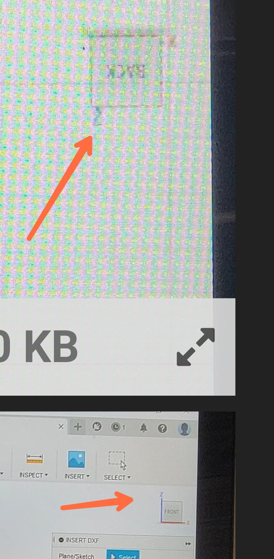

Your orientations on your navigation cube seem off.
You should be looking top down at the XY plane.
AKA, Top view.
You can also reorientate your top view if your top view is not on the XY plane with z facing up. If you right click on the navigation cube there is options in there for reorientating the top and front face.

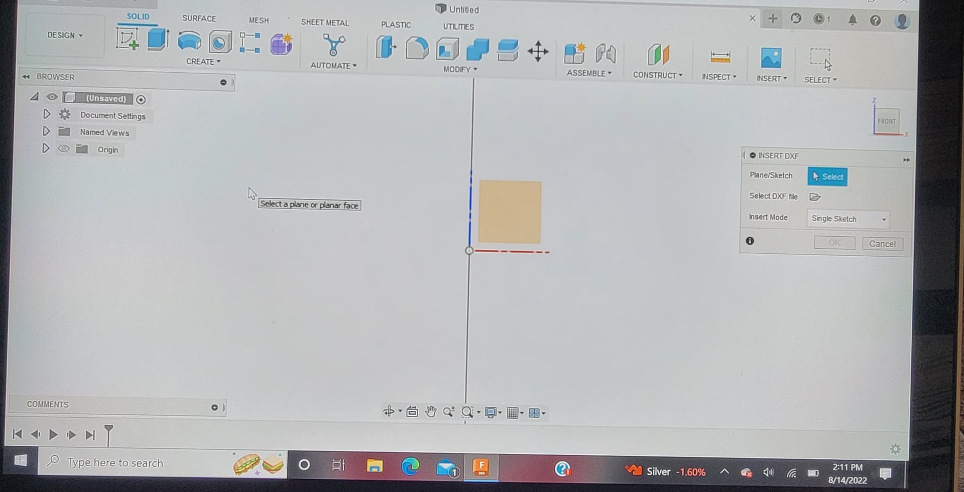

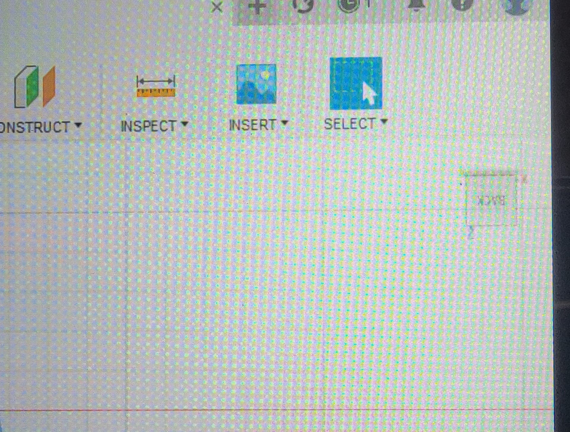

Yes i use the insert tab, the choose my plane and file . The first pic is where the pic looks like it should be. Not upside down or backwards. The second pic is everything choosen , just have to add the dxf file i am gonna use.
