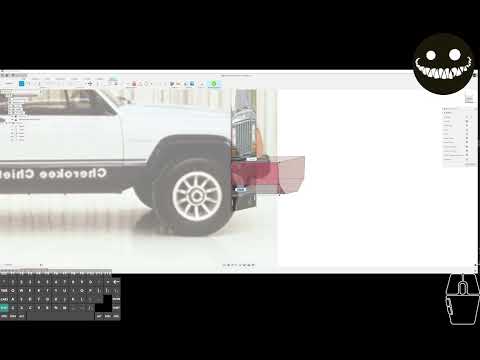

thank you for your time once again. it was a lot to in at once but i will for sure be referencing this video in the future.
@asummers509 When I create my Toyota bumpers I plan on 3D scanning the front end of the Toyota and importing that in Fusion 360 to design the bumper from.
I think a 3d scan will work well with the method I went over in the video
