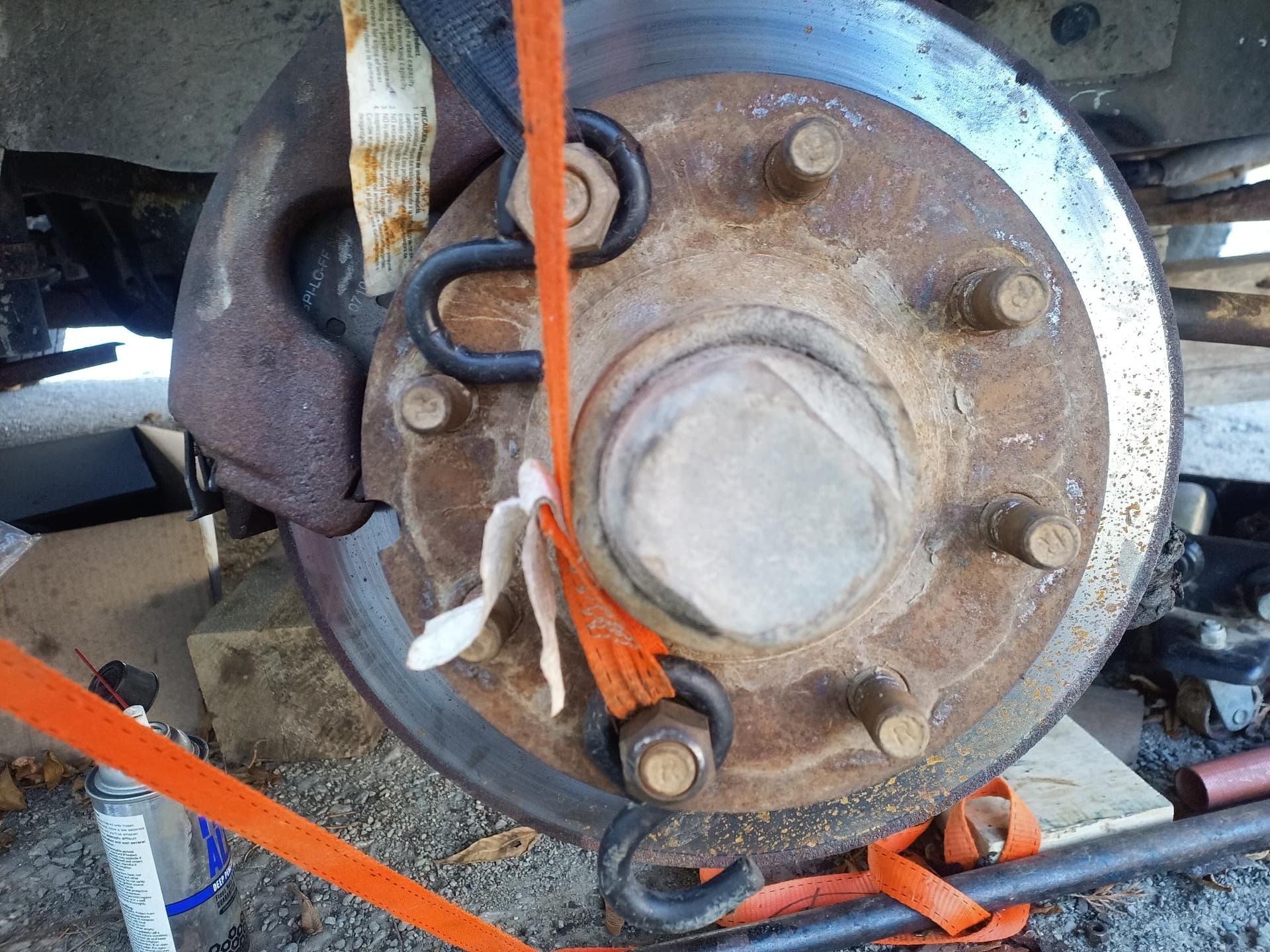

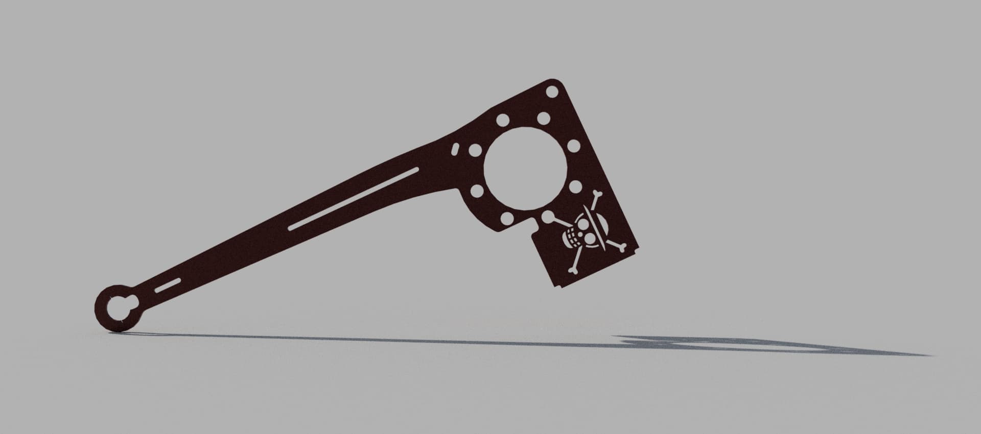

Building a lever that will bolt on to my hub to hold the wheel spindle steady so I can remove that ball joint nut… The end of the lower control arm broke off and is still attached to ball joint.
ugly and not really the way to go about it but it is what i am doing.

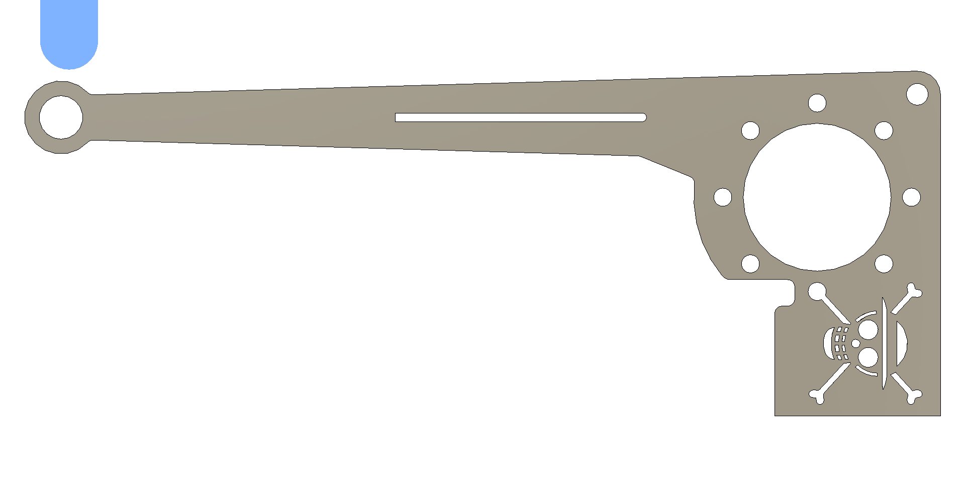

I got a little carried away.
make sure you show us when you use it. I am curious as to what your doing with it.

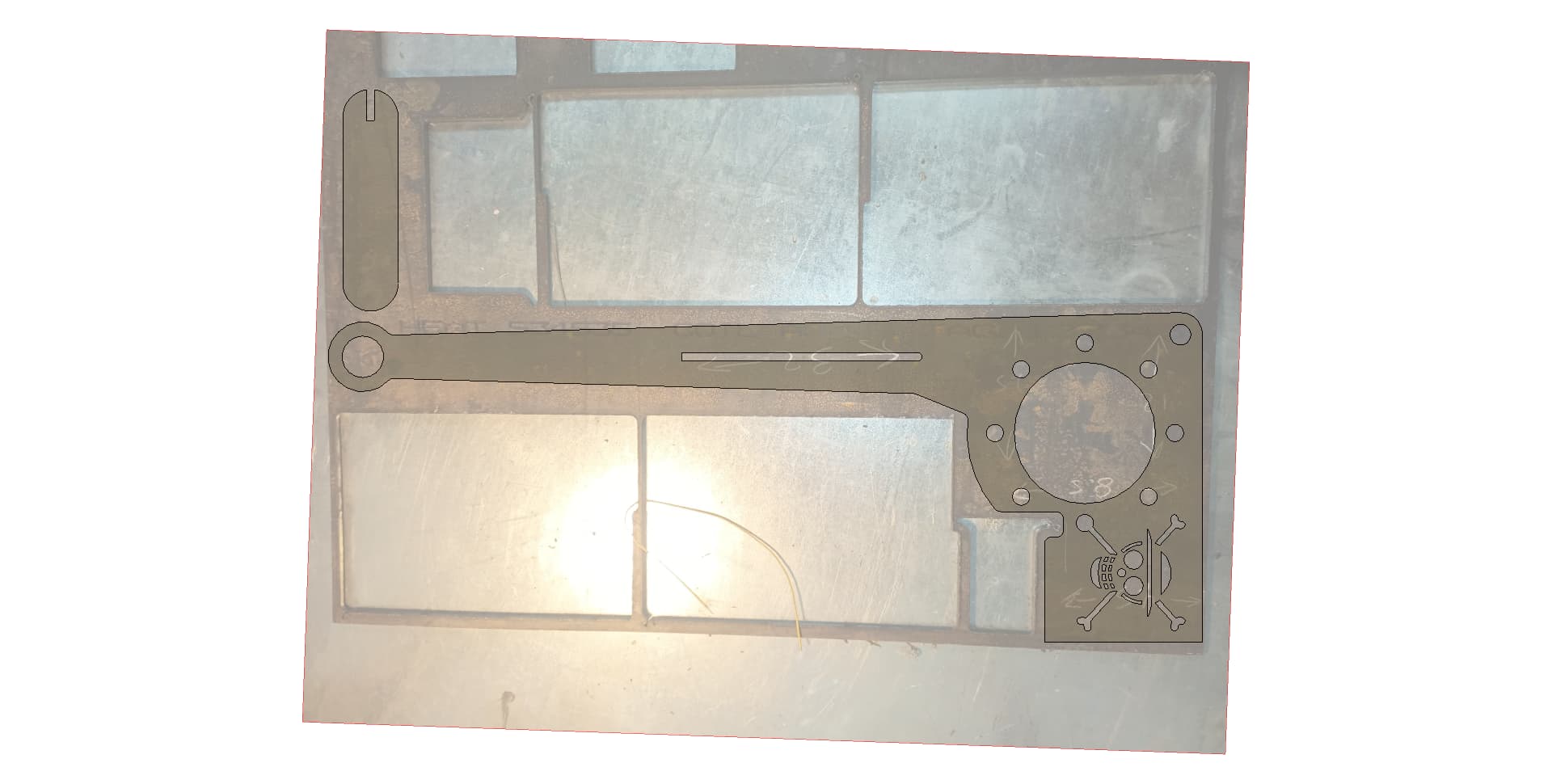

will start a design for fireshare using the canvas feature in fusion 360 a 5:15am mst after a quick break.
Xmas santa boy.dxf (404.0 KB)
Ill add this to FireShare
https://www.langmuirsystems.com/fireshare/xmas-2022-24x16-boy-and-santa-panel-example-langmuir-forums-tinwhisperer-example-live-stream-from-twitch#comment-3016
FIXED NC FILE PIERCE DELAY NOW .5 SECONDS
xmas santa boy.nc (75.6 KB)

So is this to keep the rotor from spinning or to keep from moving from side to side?
Just enough so I can crack the ball joint nut without having to take anything else off.
The whole lower control arm is gone so the wheel spindles just flopping around on the upper control arm and the brake lines.
The ball joint and the tip of the lower control arm is still bolted to the rear of the wheel spindle.
It’s a mess that I should just remove it all but…

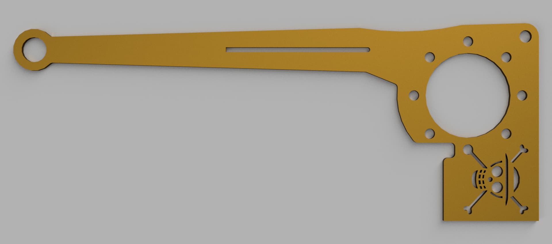

I left those two linear slots so I can weld a stiffener into the handle if I needed to.
Worked out. Pretty fun project.

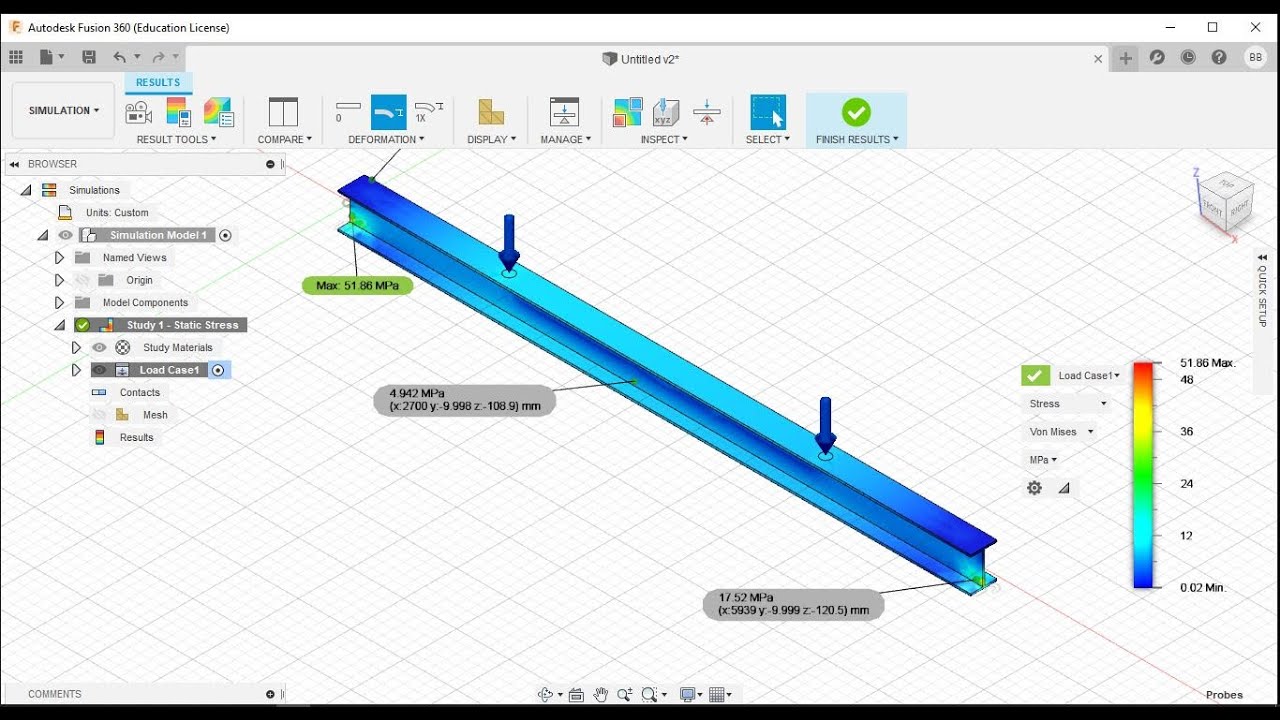

Yes you can import all kinds of things from manufactures and I forgot to mention the any of your saved documents can also be referenced in a current design. I do it with the moon in my video of making the kid with Santa, above.
here is a link to that beam stress analysist video I mentioned .
@TinWhisperer Thanks for going through that for me! Your videos are great!
I also watched the beam analysis. That is cool that fusion has that capability.
If you are interested in doing some simple analysis RISA 3D has a demonstration version, you can download. The demonstration is limited to 40 nodes but with 40 nodes you can analyze beams and many trusses ect. RISA comes pre-loaded with current and historic AISC (American Institue of Steel Construction) shapes. Included in this are Wide flange, Channel, Tube, Pipe, Angle ect. AISC also writes the code for steel design here in the US. Im sure Canada has a similar organization/publication. It also comes preloaded with dimensional lumber, and engineered lumber. If I did videos, I would do a walk through on using it, but I am sure there are plenty of them out there.
