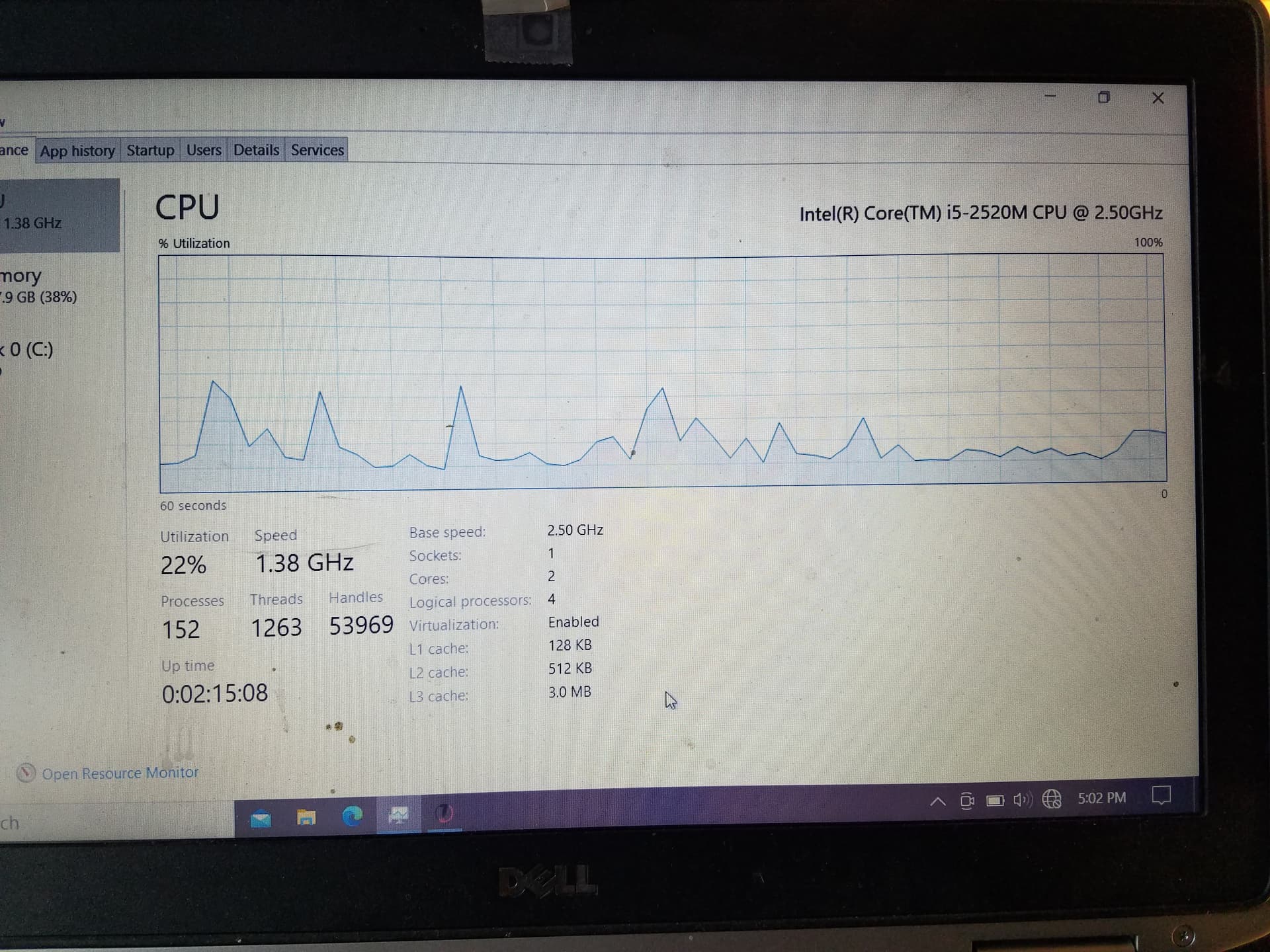

Passing this along in case you can glean anything from my scenario. I did a little trial on my system yesterday. Over the past few days, I’ve successfully cut 5 signs w/FCtrl 21.1 and FCtrl froze during two of the cuts. However, the g-Code program continued to progress fine and FCtrl became active again after the program completed.
Snapped a few pics. This first one is with cut in progress, but before FCtrl froze. You can see FCtrl + background programs using about 22% of resources and a little over half processor speed…
This data is while cutting, but FCtrl completely frozen. No screen updates to anything and even the cursor will not respond.
About 10 seconds or so after completing the cut, FCtrl again responds.

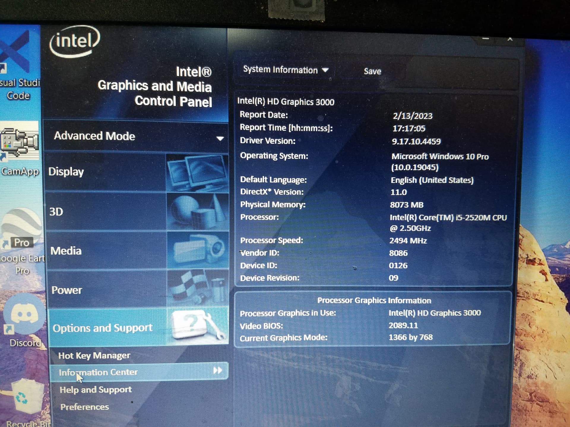

Dell Lattitude Core I5
Here are my systems specs:
Even though this was not with “Compatability” version, I get the same freezing running it. I do think the air drying and EMI (10 cable chokes, cable separation, moved cutter out from under table) changes I’ve made have helped. My electrode and tips are wearing much better and previously my torch was freezing up or refusing to fire on some portions of a cut, but continuing on with the program. Everything seems fine now except for the screen refresh/frozen controls. Still unacceptable, but better.
Anyway, maybe some piece of your puzzle in there…

Your system specs are now identical to mine, except you’re on Windows 10, which uses even less of your system resources.
My FireControl very rarely unfreezes without having to restart it. And it’s interesting that you have had the same freezing with the compatibility version, as that is one of the things Langmuir wanted me to try as a test.
You’ve got some good data there. What does the fact that FireControl recovers indicate? That’s the question…
