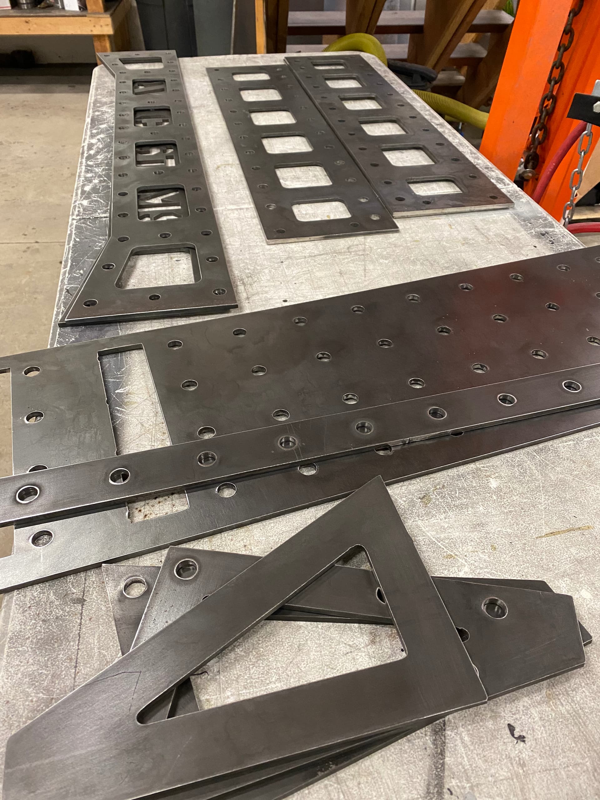

Have you messed with the USB? Try the paper trick. It takes a second. Also I would wire to raw voltage. I did notice with mine, run the air switch on the plasma cutter and watch the live voltage. When I was wired through the CNC port, I would get 12-13 volts, with just AIR coming out the torch. Thats what made me wire to RAW. Since I did raw voltage and the usb trick, its been flawless. I cut all day today and it cut perfect!!!
