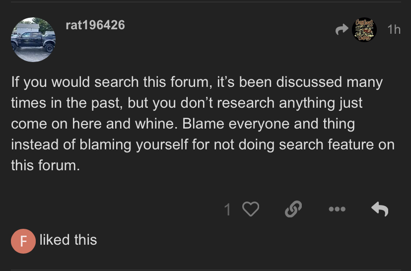

If you would search this forum, it’s been discussed many times in the past, but you don’t research anything just come on here and whine. Blame everyone and thing instead of blaming yourself for not doing search feature on this forum.

Hey @rat196426 I’m going to print this post out, frame it, and hang it above my plasma table:
It will serve as my daily reminder of how easy it can be to let yourself become a sad and angry person.
But, hey, @Found thinks you’re cool! Just goes to show that misery loves company, I guess.
