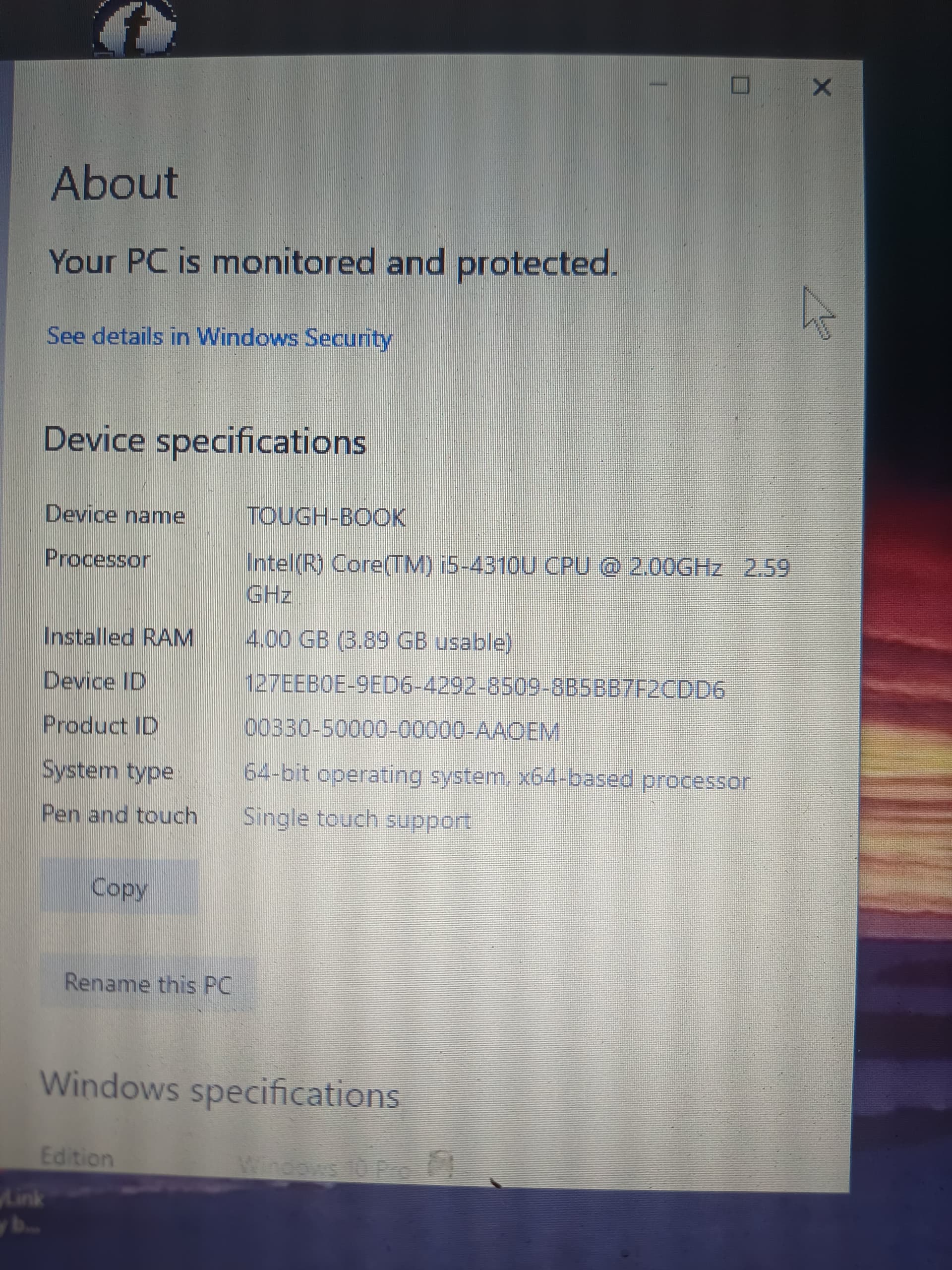

I run an old Panasonic Tough book I picked up from a police auction of surplus equipment. I have to run the older fire control because of graphics card issues. I actually have 2 of them. I’ll send you my spare to try with a fresh win10 install if you want to try it. The tough books have a lot of emi shielding built in them due to close proximity to police radios. Also they’re good about not being affected by power fluctuations.
PM if interested.
It’s nothing special but it does run a SSD hardrive instead of the old style.

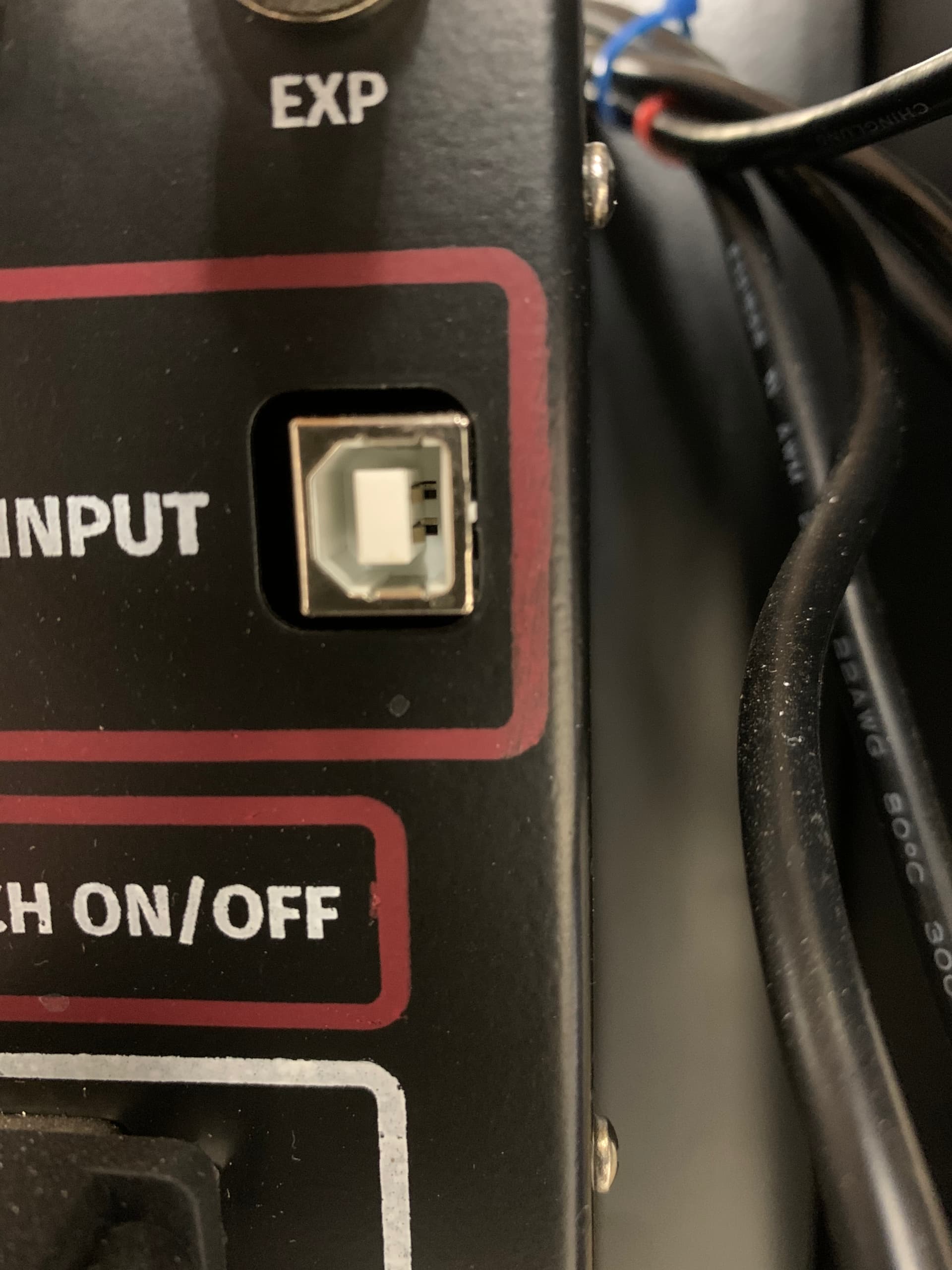

My friend @AVRCUSTOMS has been having many similar issues to my own. He just sent me a picture of the USB port on his electronics enclosure, which is making contact with the case. I checked my own case, and sure enough…
Could it be that simple? We will see…

I would think that the outside of the usb port is grounded to the case internally anyway. the whole electronics enclosure is supposed to be isolated by the plastic insulator bracket that goes between the enclosure and the leg. I could be wrong though.
My thc was going crazy with this contact! Spaced out the control board and works perfect so far!
after doing some online research i believe what i stated earlier is accurate unless Langmuir installed the usb receptacle very uniquely. The metal case or outside of the usb is connected to the “ground plane” on the board it is soldered to internally.
I asked Langmuir about this because I’m curious as well. All I know is it fixed my issues I’ve been fighting for a few days now.
Only thing I can think of is it grounds else where, the whole control board is isolated from the case for a reason! I’ll post when I get a response!
I did not realize the board was isolated from the case. that is interesting. i assumed the board was typically installed and that the entire case was the isolated part from the table. love learning new stuff. eager to hear what langmuir tells you. that would be a nice spot to have folks check that is easily fixed.
Yes I was surprised to find the board isolated! I suspect many have had issues related to this, every picture I have seen the port is really close or touching the case!
You guys both know more about this stuff than me, @AVRCUSTOMS & @DnKFab, but Langmuir told Austin that he should have 10k ohms between the table and usb port; and he didn’t have that until he got the usb port off of the case. I still have to check for that resistance on my own table, but Langmuir told me that I should definitely find a way to fix the contact, as that “could be an issue” in regards to the problem of live voltage freezing that I’ve reported to them.
VERY interesting! Thanks Austin for bringing this to my attention. Here’s hoping!

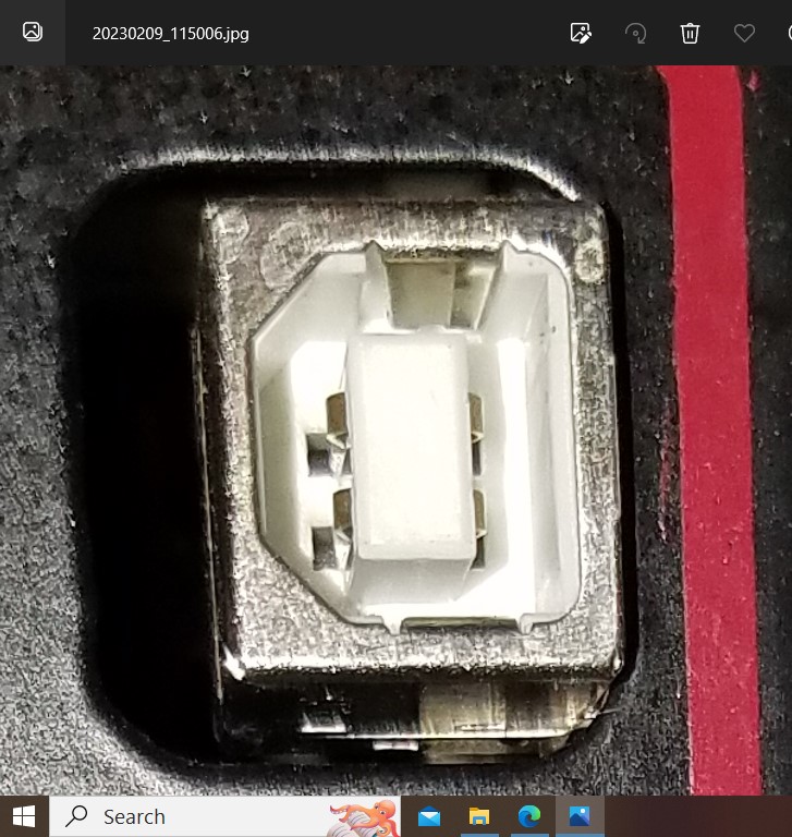

I just took a picture of mine. I also have issues with FireControl freezing. Like you, I’ve been working through a lot of the potential root causes.
Did you or @AVRCUSTOMS re-align the port or take some other action?
Mine:
