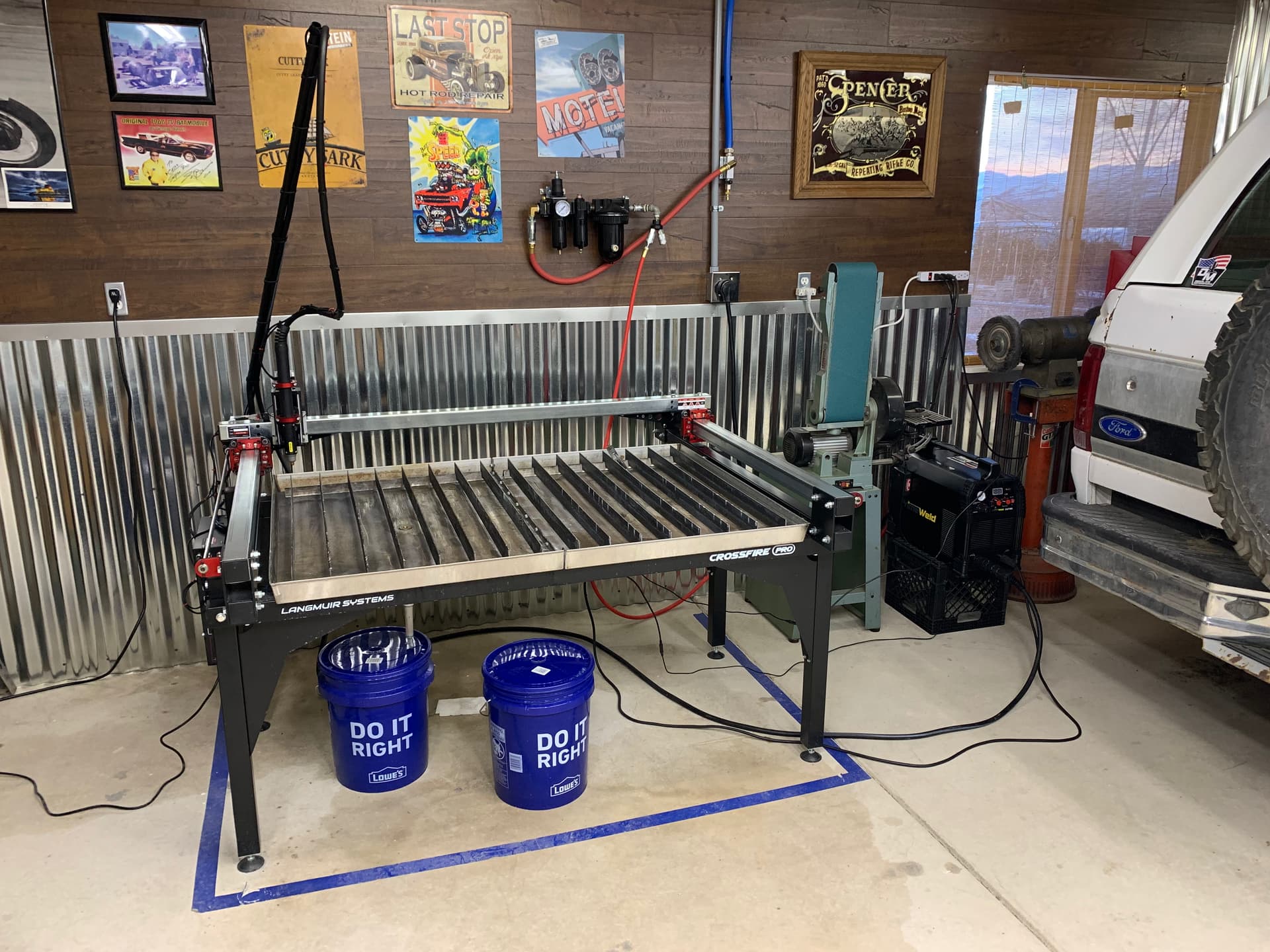

My 1.2GHZ Laptop is ONLY used for FireControl and the occasional YouTube video (never at the same time). I had Langmuir remote connected into that laptop, which I’m sure uses a fair bit of processing power, and as such I had WiFi on and email updating, etc. and more windows than ever open at once, and under those conditions we could NOT get FireControl to freeze ONCE.
But with all of that stuff off/disconnected, as soon as the compressor and dryer are both running at the same time, it will freeze EVERY SINGLE TIME I attempt a straight line cut.

Regarding EMI Management:
Since the NEC rule change about bonding sub-panels was brought to my attention by @smithto, I decided to tackle the basic EMI reduction steps first (cable routing best practices).
Per @nicaDd’s recommendation I got some extension cables for the Div Voltage and Torch Firing connections, and got my plasma cutter a full 8 feet away from the Langmuir Electronics enclosure. I also routed those cables away from ANYTHING else, per @DnKFab’s recommendation, just loosely for now, as I am unsure if putting them into some sort of split-loom and p-clamping them to the table will negate my rerouting efforts.
I have uncoiled my work clamp lead, and routed my torch cable so that it doesn’t make contact with any other cable in the system.
My question is regarding a comment/article posted by @TinWhisperer, regarding taping the work clamp and torch lead together for field plasma cutting. Should I tape, or otherwise connect my plasma torch cable and work clamp cable together for the portion of their run that is near each other? The principle seems sound enough. I just wasn’t sure if that was something anyone else was doing. Would it lessen the antenna effect of those cables?
Whatever the recommendation winds up being, I’m going to consider this “phase 1”, and then make some cuts.
I would say, have all cables separated, run a few test cuts and see how that goes. If everything performs well without firecontrol bugging out THEN tape or wrap the torch and work clamp cables together and do another test run.
technically i believe that both of those cables will exhibit similar rf emissions. An interesting concept i saw in that video shared by @TinWhisperer a while ago about rf emissions and nullification could possibly incorporate. Following the concept of the twisted wired method in ethernet cables it is a possibility that the work and torch lead attached to one another could experience some noise cancelling. Even if not, both of those i think experience the same noise (a lot!) and i dont think having them together would have any negative effects and in fact would be positive simply by decreasing the number of really noisy things you are trying to avoid. both of those cables will have the max rf noise i believe. seperate you have to avoid both of them. together you only have to avoid 1 less cable.
