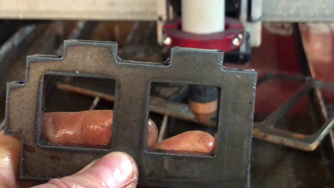

I am getting to wits end, I have been struggling with cut quality for week and have tried just about everything under the sun and am wondering if perhaps I am having a THC issue or if it really is just machine settings.
I have used Fusion 360 and Sheetcam for the CAMing.
I have the Crossfire Pro table and am trying to cut 1/4" mild steel. I started with using my PrimeWeld Cut 60 and hand torch and my outer corners and sides with tabs have been severely rounded and severely beveled. I tried with 60A and 45A nozzles and the range of settings and eventually started using Path Rules. Couldn’t improve the tabs.
I also have a Hypertherm PM85 and recently acquired a machine torch so I now have that set up with my machine. I have tried cutting with both 65 A & 45A consumables and parameters per the Hypertherm manual and I am getting convex and concave edges in the same cut and my corners are still pretty rounded. In all cases the cut height has been set to .060" as specified in the manual and pierce height = .015", Pierce delay either .6 or .5 sec depending on consumables, Kerf per the HPT manual as well.
I had air leakage issues that I corrected before the cuts shown, so I don’t think air supply is my issue

As suggested on plasmaspider thread, run with the plasma cutter off and THC disabled. Pause the program where it is “cutting” and measure the cut height, is it correct? Pause it during the torch fire and measure the pierce distance, is that correct?
Assuming yes, if you haven’t already try doing a cut with THC disabled. Any better results?

So my pierce height is off on the parts cut using Sheetcam, I had a typo where I misplaced a decimal. So my pierce height was .015" instead of .15". Cut height was confirmed at .060"

The bad pierce may have ruined your electrodes and doomed the rest of the cut. That picture of the electrode above is really zoomed in, it’s hard to see the defect by eye (at least my eyes :slight_smile: ). If you upload the dxf, if the part isn’t too big I can try cutting it to give you a comparison.

OK here’s my try:
The ‘inside’ corners on the outer contour can use some work. The outer corners I used the Sheetcam feature to loop the corners and they turned out much better. The inner squares, could probably slow down the corners further. I did the complete inner squares at 60% feed (29 ipm in my case). The outer was all done at 48 IPM (full spec). So I think those ‘inside’ corners on the outer cut could clean up with slowing down. I may try that. The still pictures at the end of the video, first is front, second is back. Dross on back was removed with a screwdriver, no grinding on front or back.

Greg9504 Thanks for the help. I replaced my electrode and re-cut the part with the corrected pierce heights with both a 65 and 45A nozzles. I also used the triangular outer looped corners and my cut has significantly improved. I tried running slower on the outer perimeter but the inner corners still need a little work. Seemed better at 65A so I will continue to make some adustments with the 65A nozzle. I am definitely heading in the right direction though. Thank you.

Inside corners will always be a little rounded. If you want square inside corners you have to do it the old fashion way, with a file.
Mecahnic416 - You are right, for 100% 90deg corners hours will need to be spent with a file fighting with a case hardened edge. Not everything I cut I designed, so there isn’t always the extra tolerance needed for rounded corners. Plus the CNC plasma is supposed to be a time saver once figured out…
BUT for those that need corners with clearance so that parts can go together like puzzle pieces quickly, The slower speed helped and I actually gave the developmental version of SheetCam a try for it’s “overcut on internal corners” feature. Works great, my parts fit nice and tight together making welding it easy.
