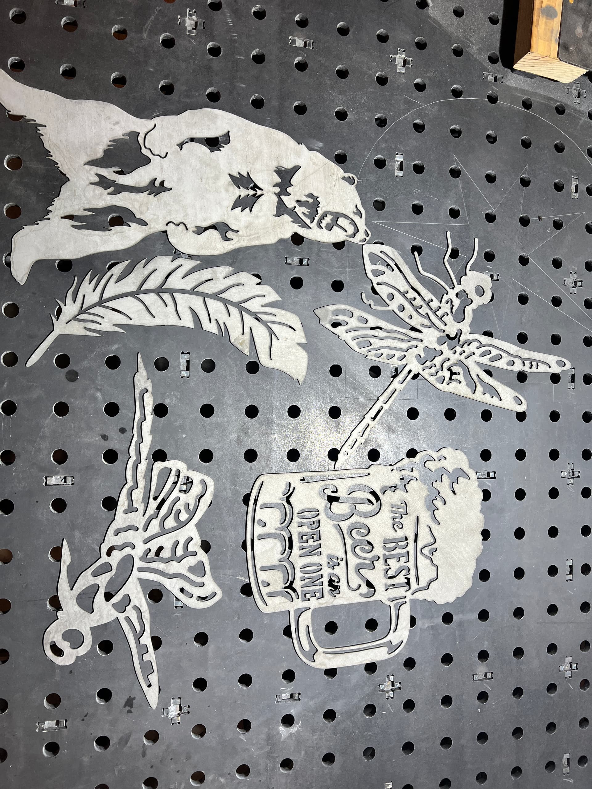

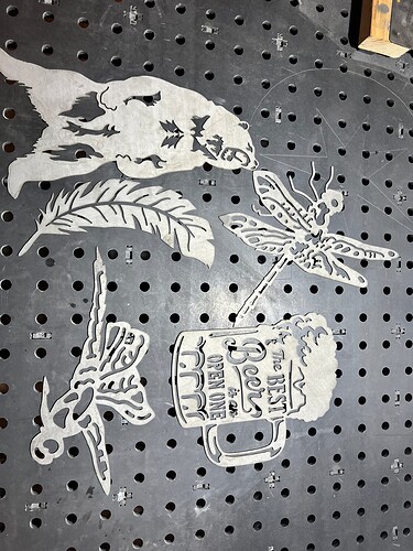

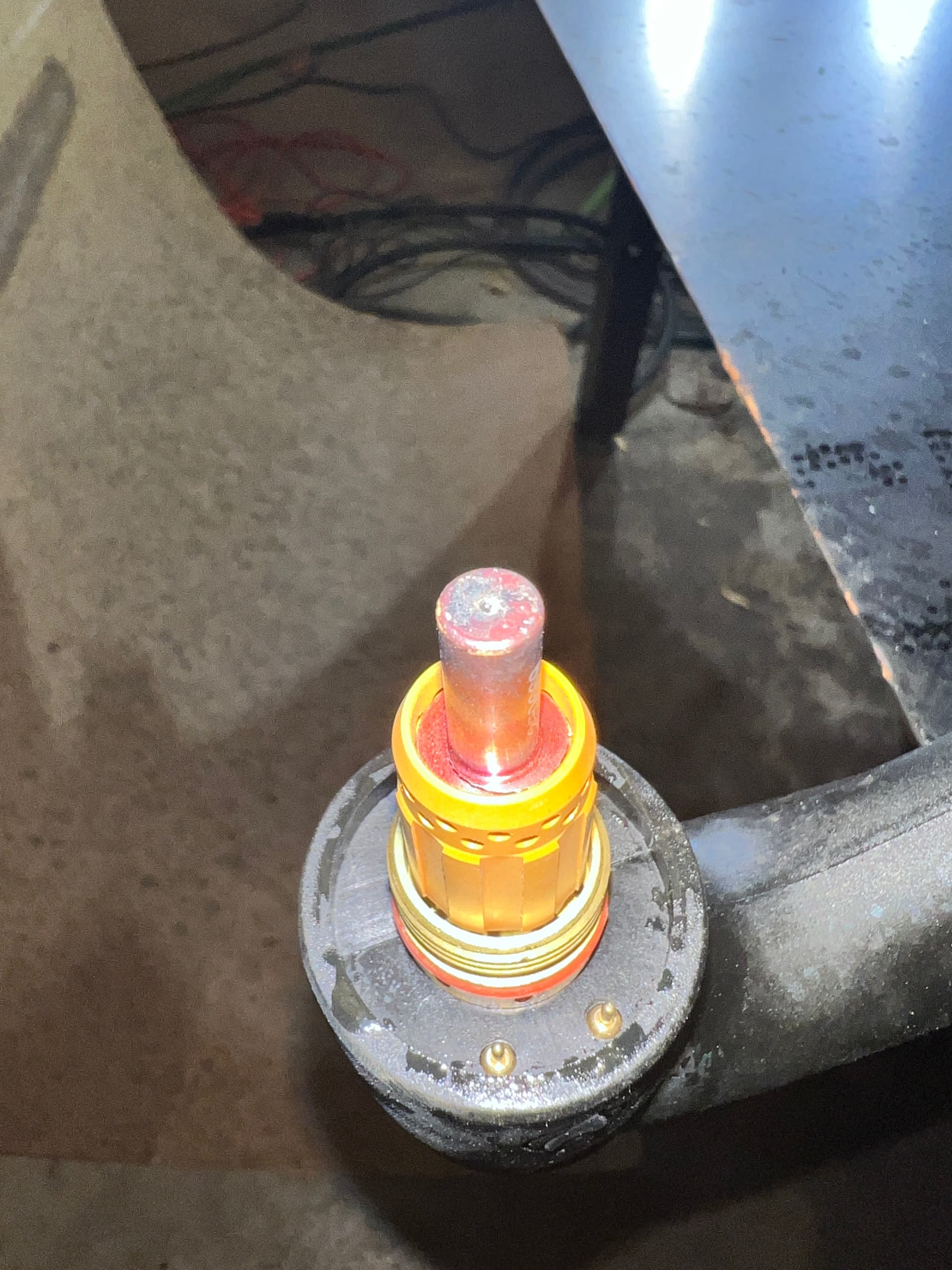

So no jaggedness at all, other than the dross showing up from behind. This piece is, I think, 177 pierces and 30x21”

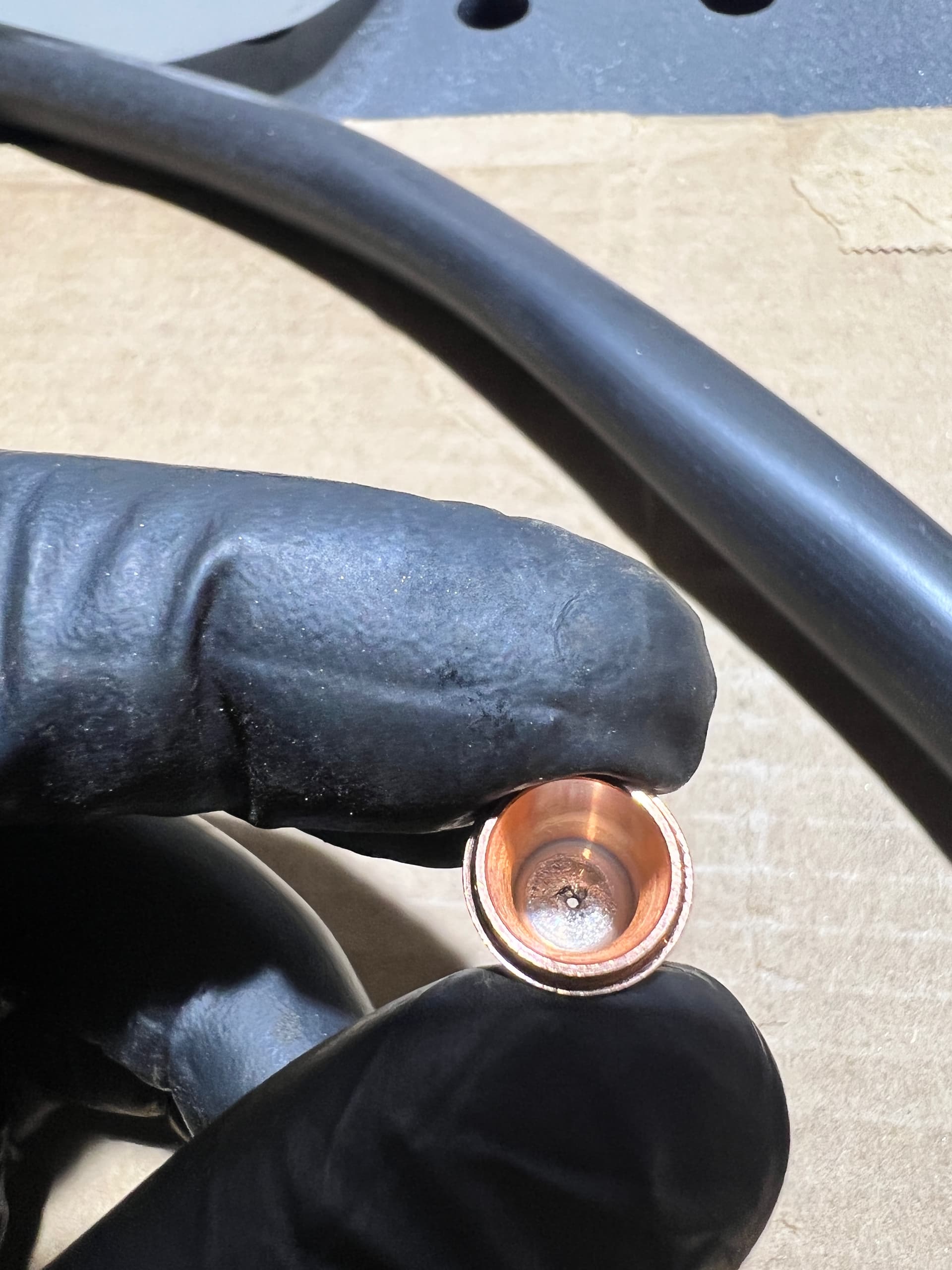

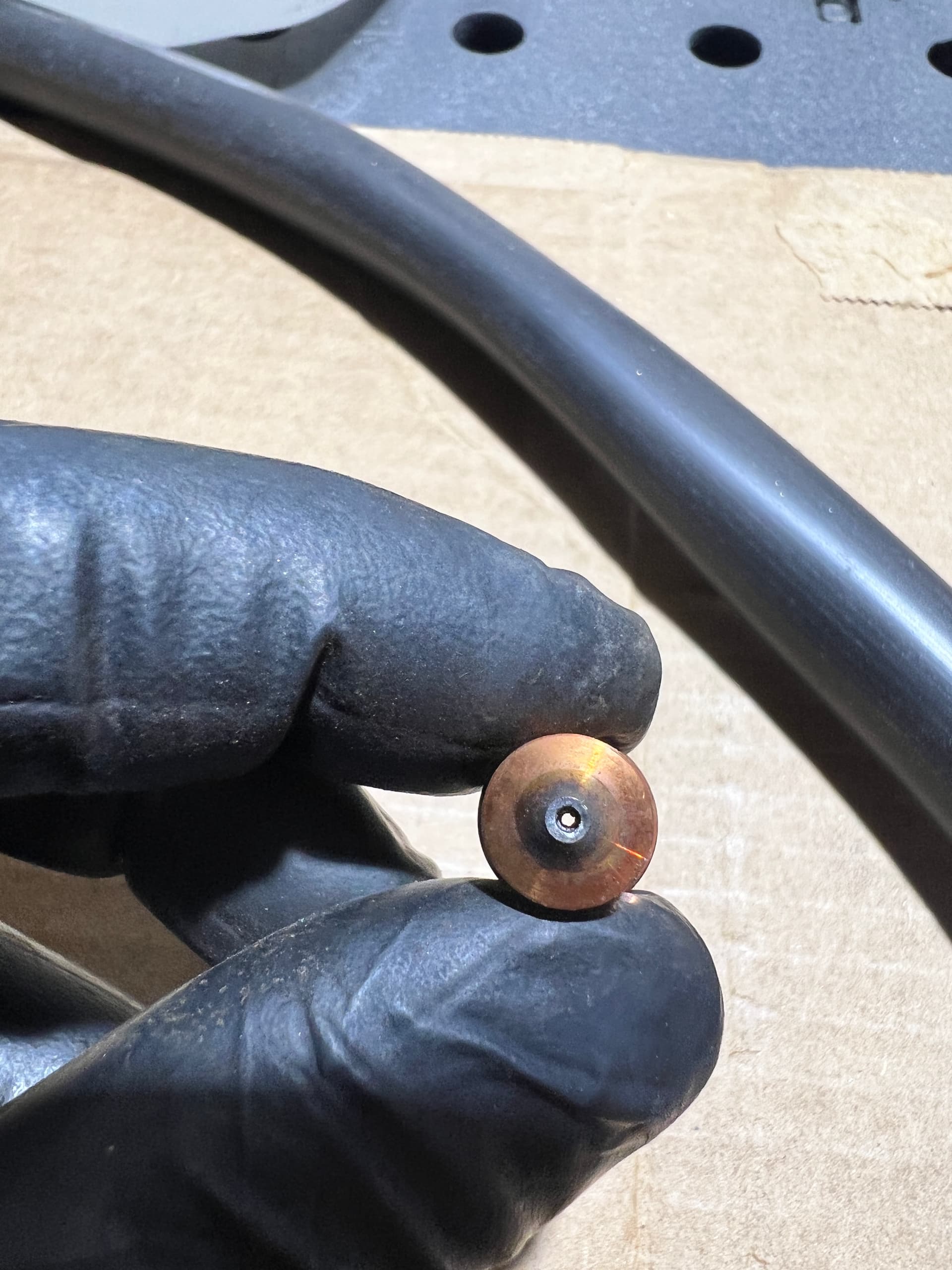

I did however run into a fresh issue. The torch would come down, go to fire and fail, then I’d get a misfire warning in fire control. Cut perfectly when resuming cut, but warning happen more often as I went. The final cut was smooth but a little rougher than the rest.

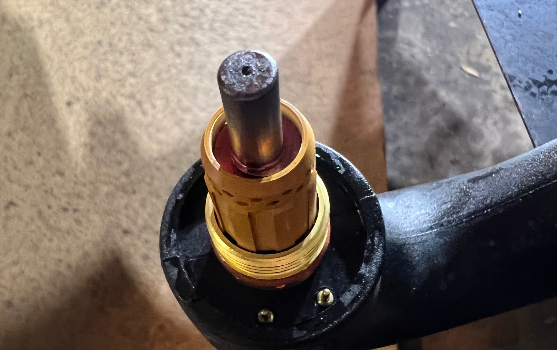

I’m thinking I just wore out my hand torch consumables, never seen a misfire before. Gonna pull the consumables in a minute

Hole in the electrode seems pretty deep, possible misfire cause?
That nozzle is done.
The second electrode picture is done as well
Yea I figured it was consumables, that was the most pierces and cuts I’ve ever gotten from a set lol

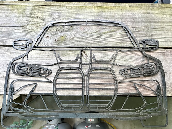

I’m overjoyed at how well it just cut that car out, I was so nervous after how it cut out my previous one
A big piece that takes a long time to cut can be super nerve-racking, especially with the memories of earlier issues.
Is those two pictures of nozzles the same nozzle with different lighting or two different nozzles and different lighting?
Same Nozzle but it’s directly under my table worklight so shadows can be exaggerated, I only have the consumables that came installed in that torch lol
Here’s everything it cut yesterday (table holes are 2” offset to give size reference) plus it cut the whole car out.
