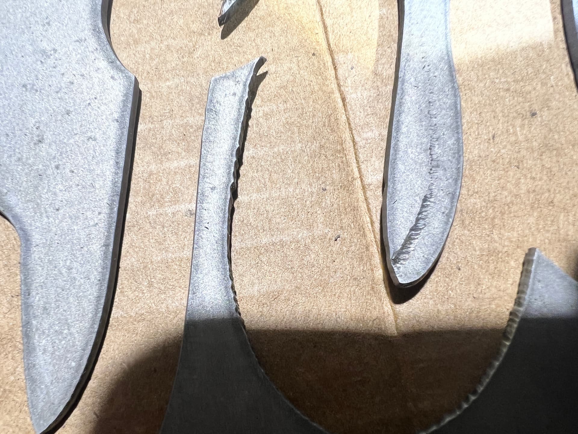

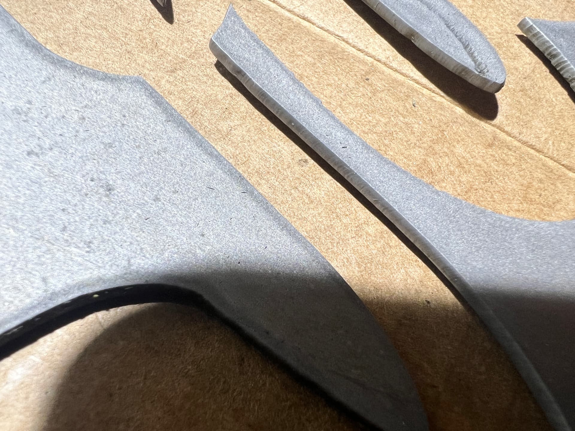

So before I show the issue just want to go over my details:
PLASMA:
RazorWeld 45
PTM60 Machine Torch
40A Shielded Consumables
Consumables are Fresh at time of this issue
160ipm
Machine has 80 psi @ idle, 75psi while cutting
Cut Height .05”, pierce height .12”
AIR SUPPLY:
~17 SCFM, 80 Gallon Compressor
Air leaves tank, 6 48” drop legs of 1” copper, goes to oil separator and desiccant filter (desiccant was fresh and blue before cut), goes to Refrigerated Air Dryer running 34 degree F, goes to Eastwood CFS Desiccant Dryer (cartridge was fresh and new) run through ~10 ft of rubber air line to a MotorGuard filter (stays bone dry) goes to 1foot hose, enters plasma cutter
SYSTEM:
Latest FireControl and THC
Laptop, unplugged
THC is enabled, running Smart Voltage
MATERIAL
16 G Hot Rolled Steel
FILE

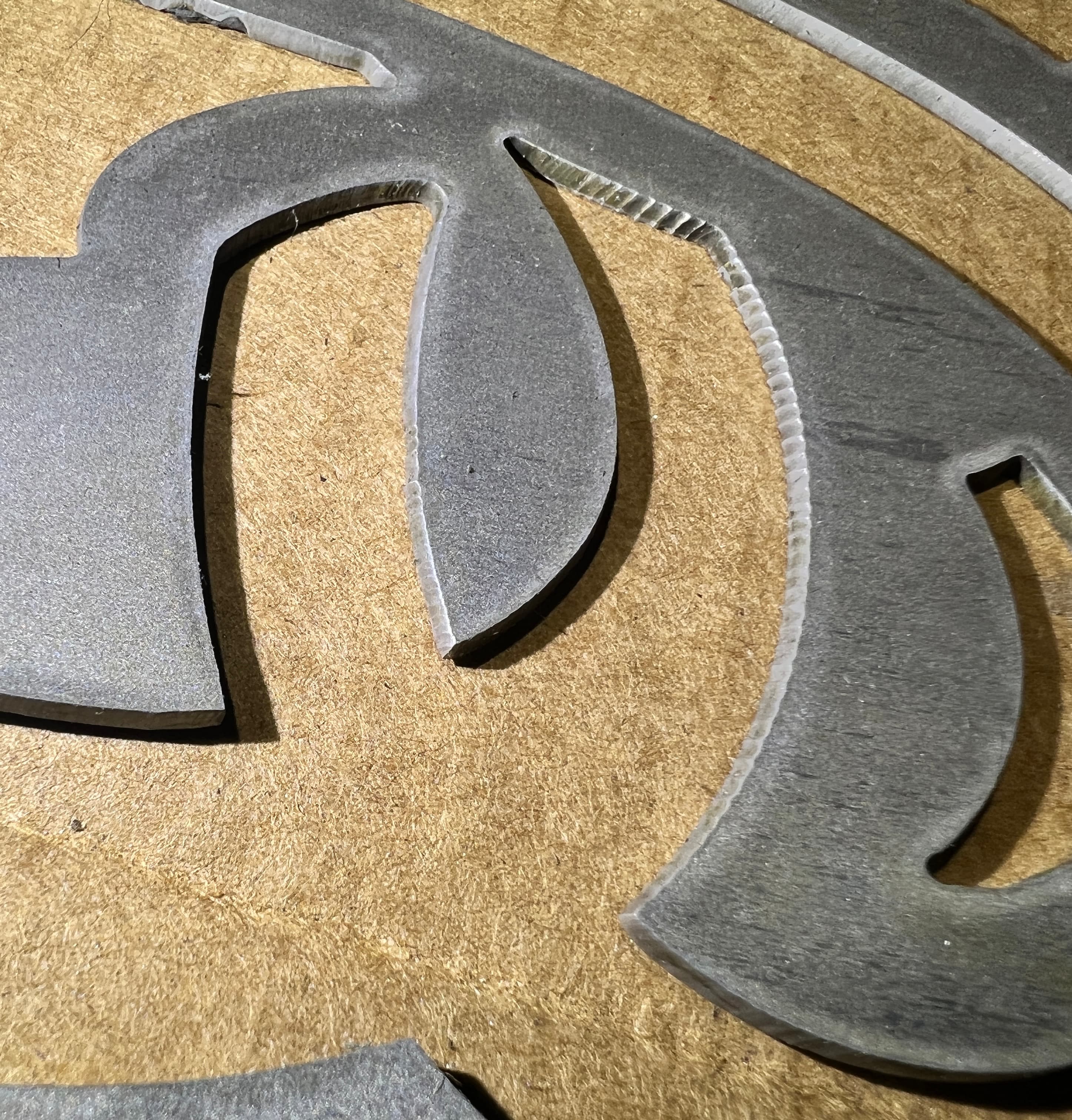

You’ll see the file cuts perfect one time, the other time the issue occurs
Ok fun stuff is out of the way now, now for the pics.

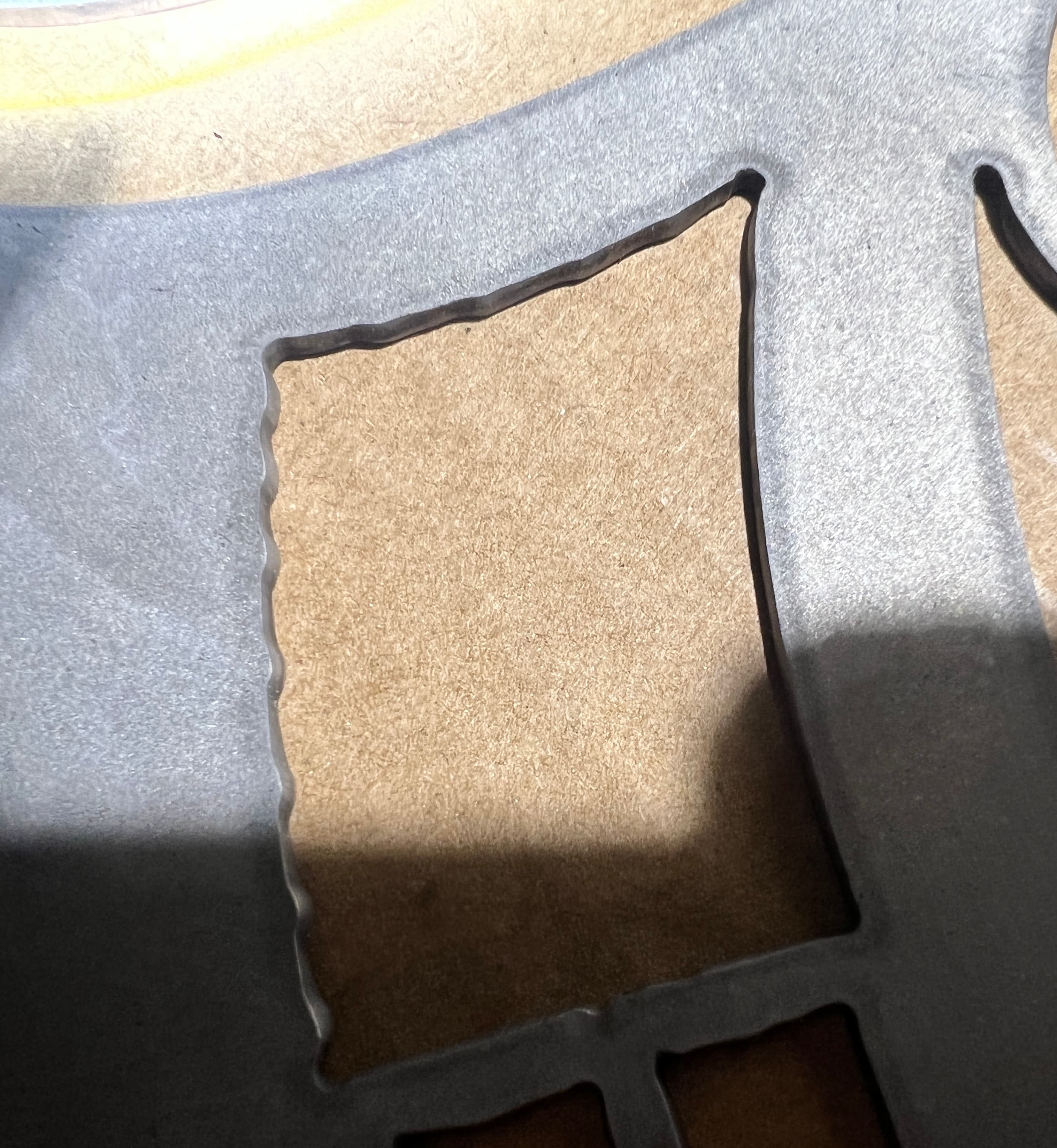

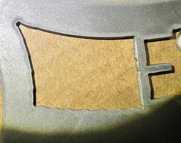

Here you can see where the jaggedness starts, goes from perfectly smooth to jagged

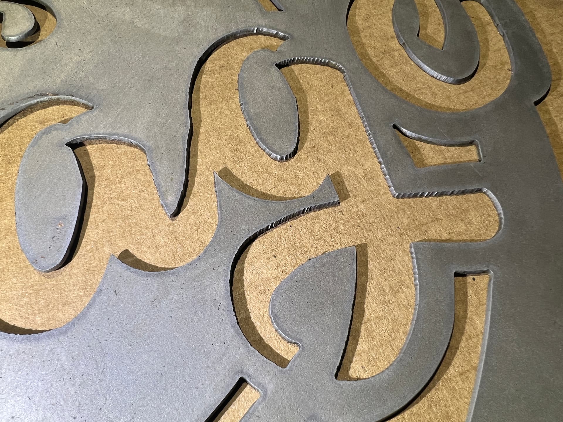

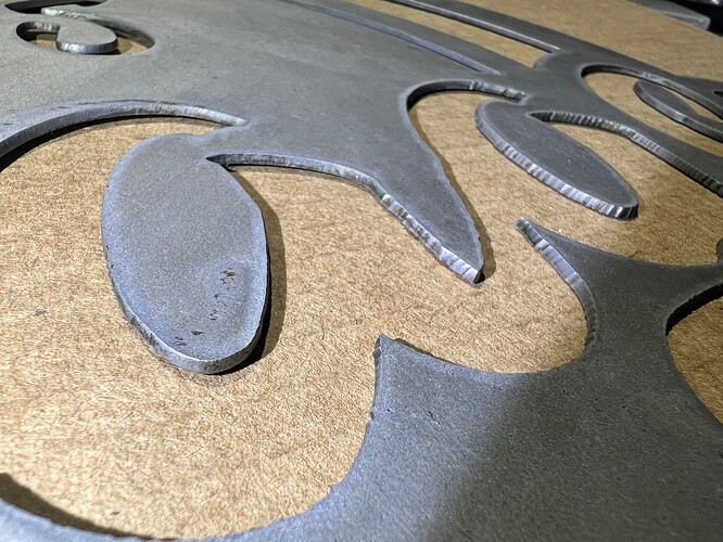

Here’s how long it stays jagged, you see it stays jagged in all directions

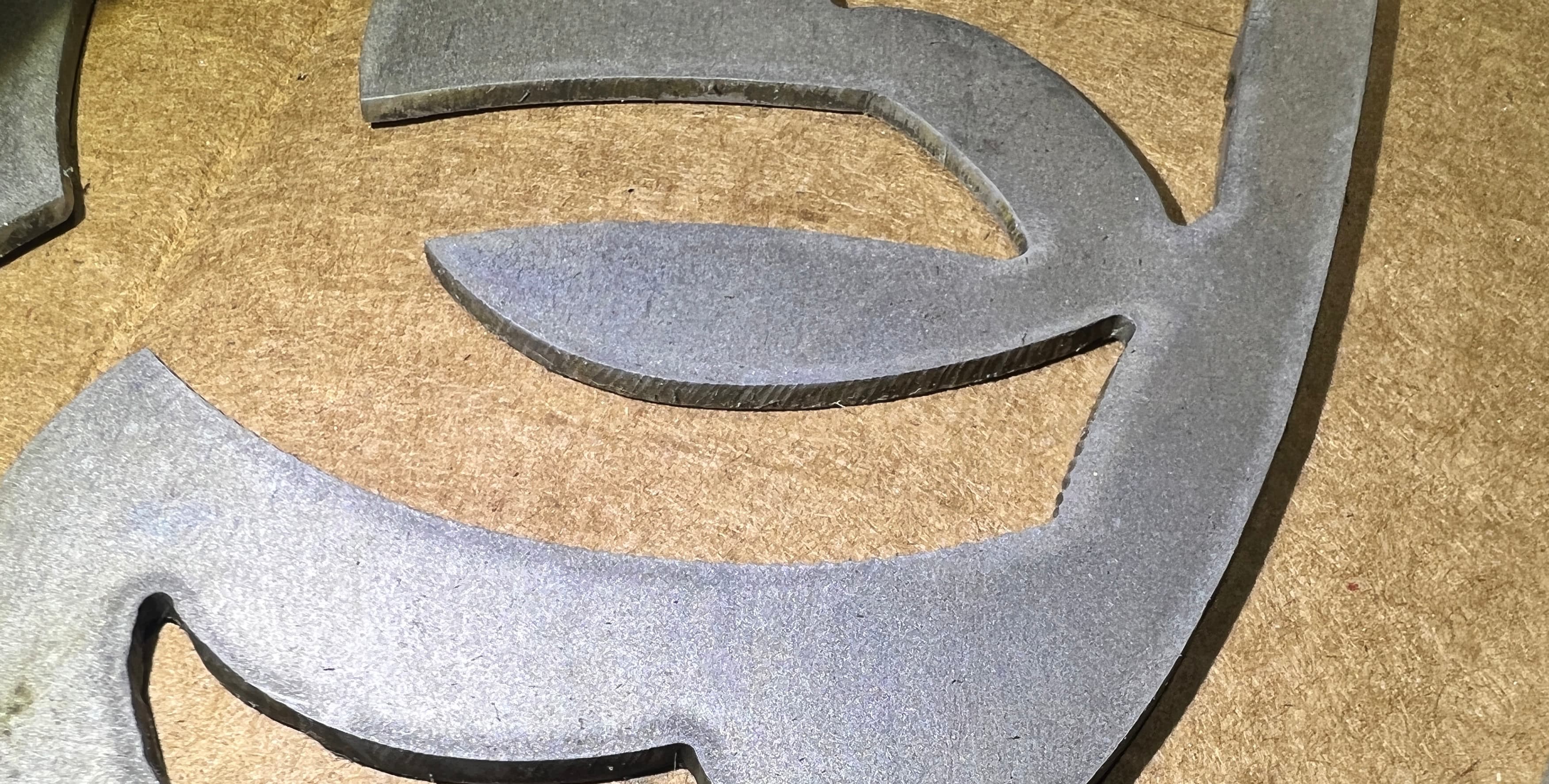

Here’s where it ends, just turns a corner and butter smooth again.

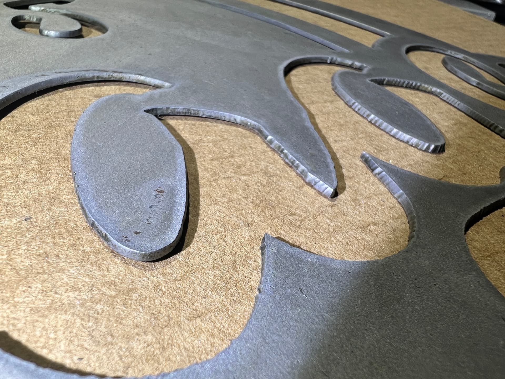

Here it comes up suddenly then goes back away.

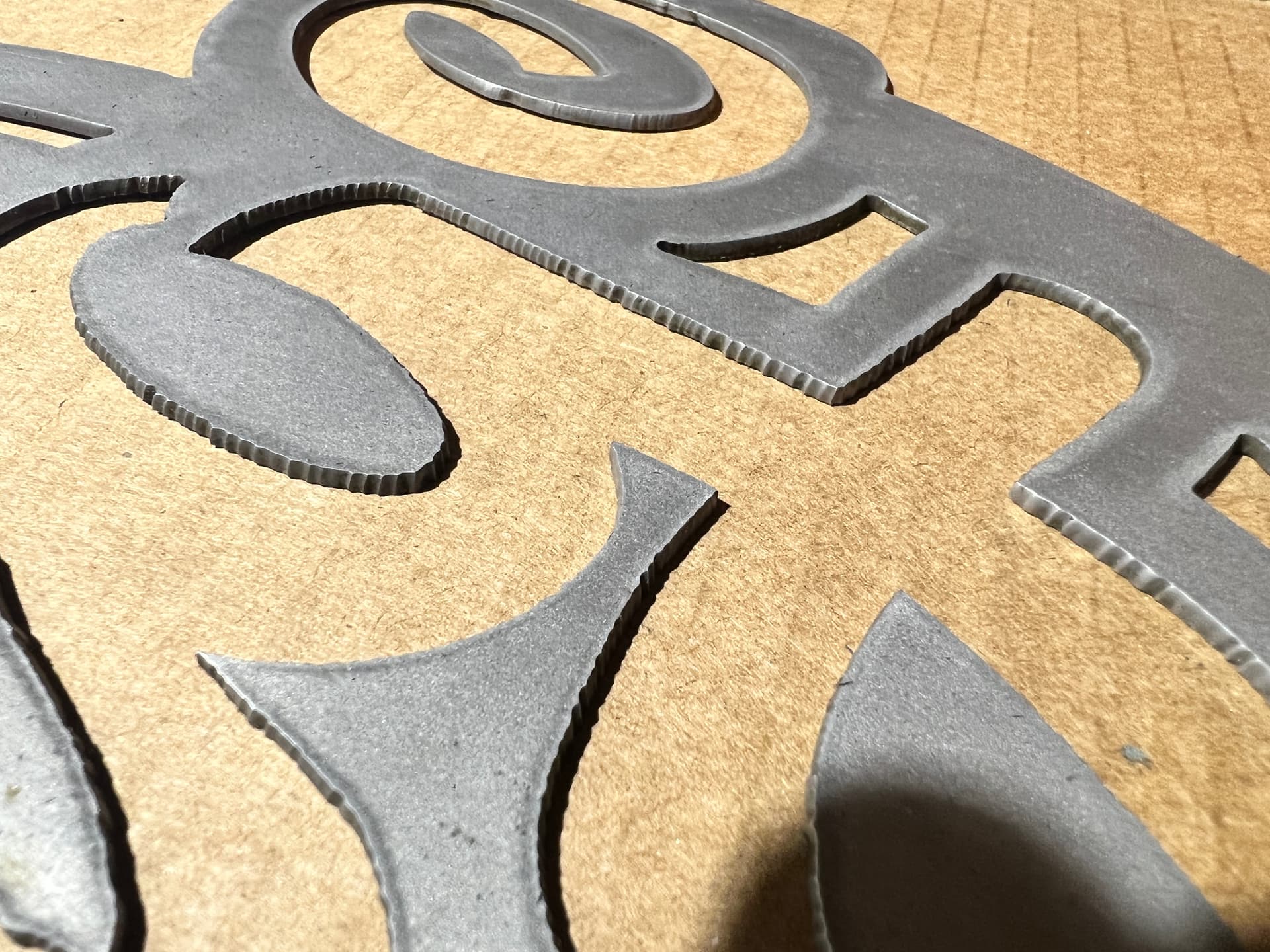

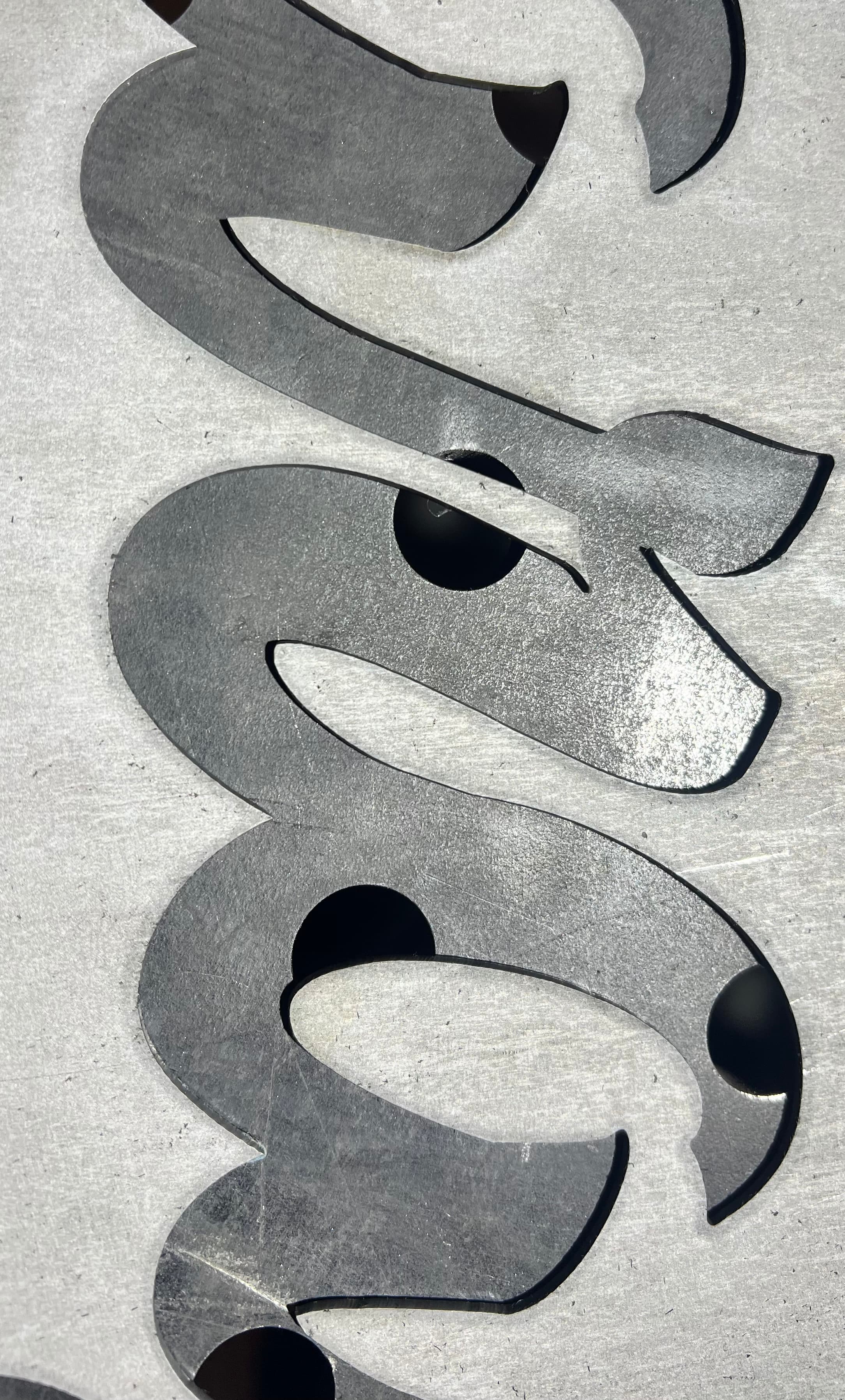

Then whatever this crazy wavy thing is, was supposed to be smooth, nothing like this.

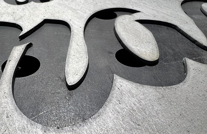

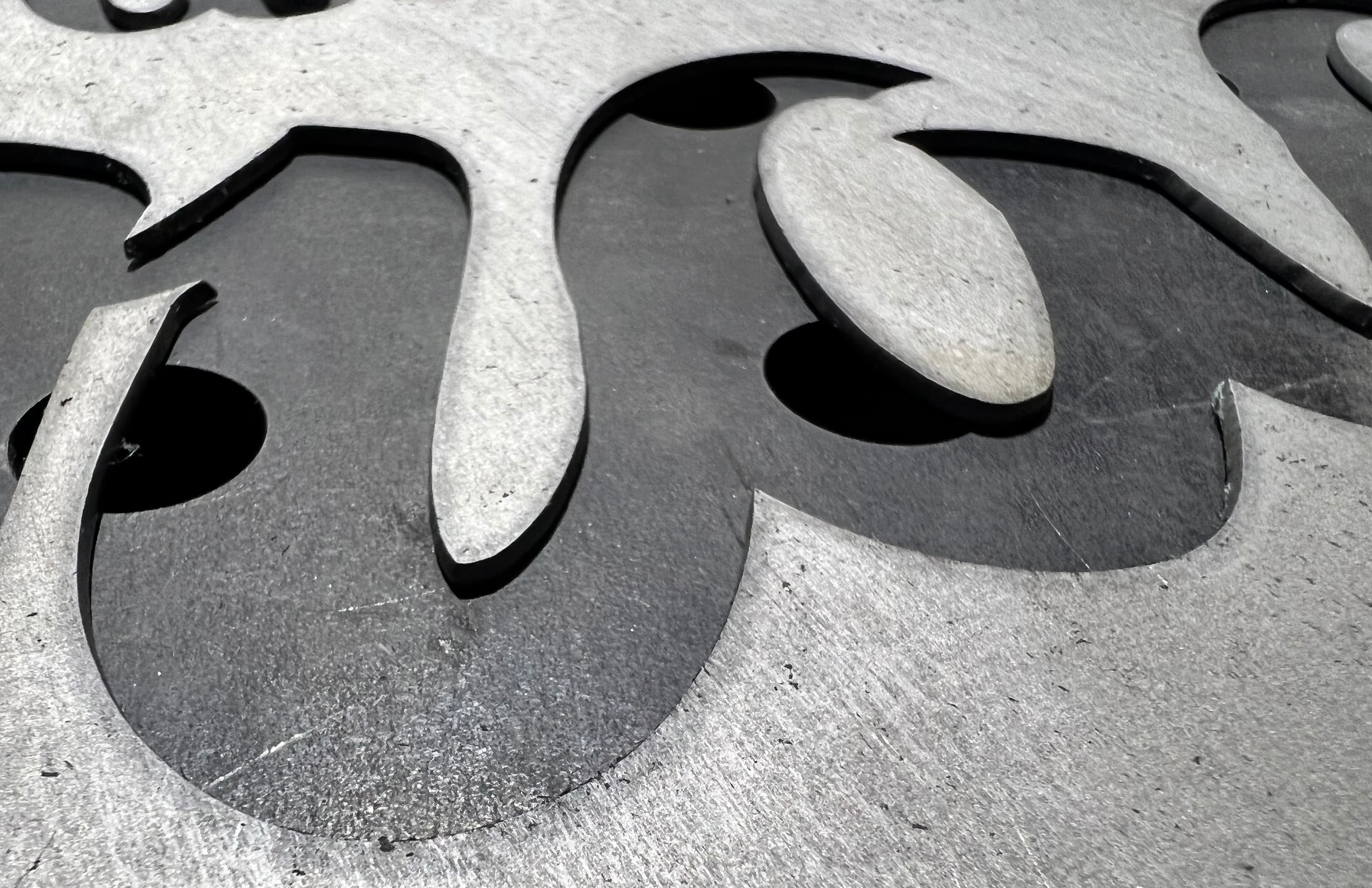

EXAMPLES OF GOOD CUT (done after bad one, with same consumables that were in there, lowered to 140ipm only change made, but I’ve had this happen before while keeping speeds identical)
Soooooo, opinions on a possible cause?

Your z-axis staying steady while cutting ,no bobbing?
I’m wondering if there’s some air delivery problem in the torch itself?
Swirl ring? Debris in the airstream?
I try to watch the Z but I swear it happens every time I’m not staring at it thru my mask lol. Thru my tinted torch glasses I want to say it wasn’t bobbing but without my weld mask I can’t be 100%
I recently found a binding in my z axis from bearings being too snug near cut height, but I readjusted and it now moves freely and without wiggle room. I do think those Z Axis bars aren’t perfectly straight though as the top of the travel it can wiggle a bit but at cut height it’s fine.
Swirl ring wasn’t changed with rest of consumables so it’s possible. I also didn’t change the shield/cap but checked all air holes and they were clear and there’s no damage near nozzle.
I think I have a fresh swirl ring I can toss on.
In terms of debris do you mean like stuff splashing up during cut and onto the torch?
Do you feel it’s an issue with the plasma cutter? That’s my main thing I’m trying to determine if it’s a table issue or a plasma issue, I have a new Hypertherm coming July 28 so if it’s a plasma issue I can rest easier

No in the torch tumble around interrupting the air flow . pulsing it.
Torch air flow issues

Saw tooth cut edges are almost always caused by pulsation in the air flow out of the torch. Many times the pulsing is visible.
As long as the torch isnt dragging on the plate, very unlikely that the issue is with the machine itself. I’d be paying more attention to the torch/consumables/air supply.
Thank you for that input, I think swapping back to the hand torch will be a good idea just to eliminate anything within the torch. I’ve never used the hand torch so all of it is brand new.
You mention pulsing, I think that might describe what I see when it happens it’s not super noticeable but you can also hear it in the sound of the cut. Hard to describe it but I think pulsing might be a way to describe it. I assumed it was an after effect rather than part of the actual issue
I believe my volume of air to the machine is good and my gauge on the plasma doesn’t budge even with compressor running, it can catch up and refill the system even during a cut pretty easily when it kicks in. It’s always 80psi idle and roughly 75psi while cutting. (I know pressure isn’t volume but there’s no flow restrictions either)
