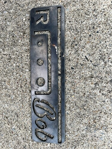

So this is my 4th test cut panel, just dialing in leads to minimize cratering, still a little bit on the “o” but I can probably shift the start point and fix that easily.
This is on regular 45A consumables at 250ipm in this 16G steel.
Also I was worried about the rated Kerf size for this machine being .053 as I felt that was a bit large even for the standard consumables. Dialing in those holes I found them about .02 off each, dropped the kerf to .043 and now each circles tolerance is .01+/-, with small circles cutting at 60% speed. That’s more than good for my needs so not gonna bother dialing in more.

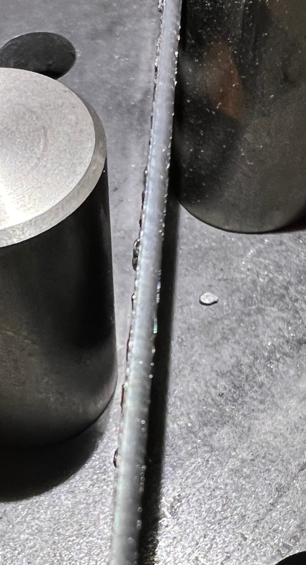

Seems to be doing great, temp hangs at 34-35degrees, cuts have been coming out gorgeous, check out the edge look on my test pieces. Motorguard near the plasma is bone dry still. Good peace of mind even if it didn’t solve my issue

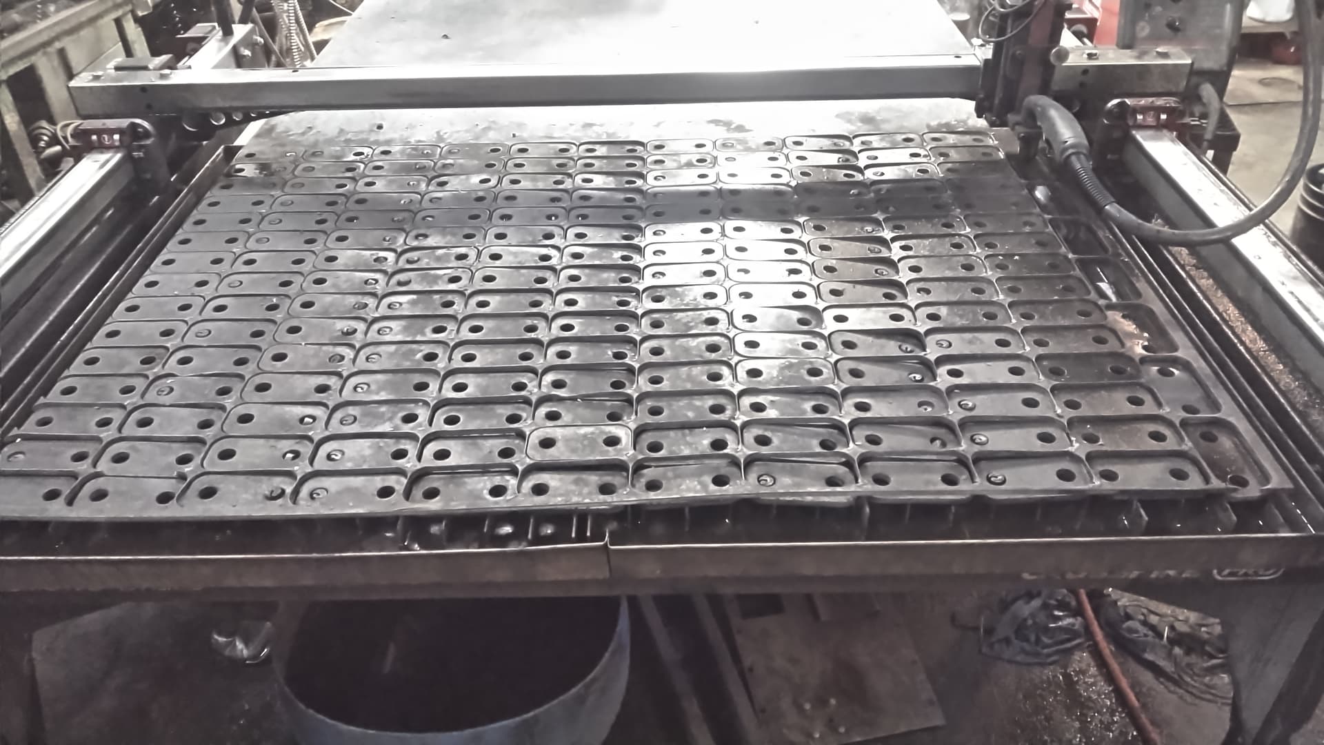

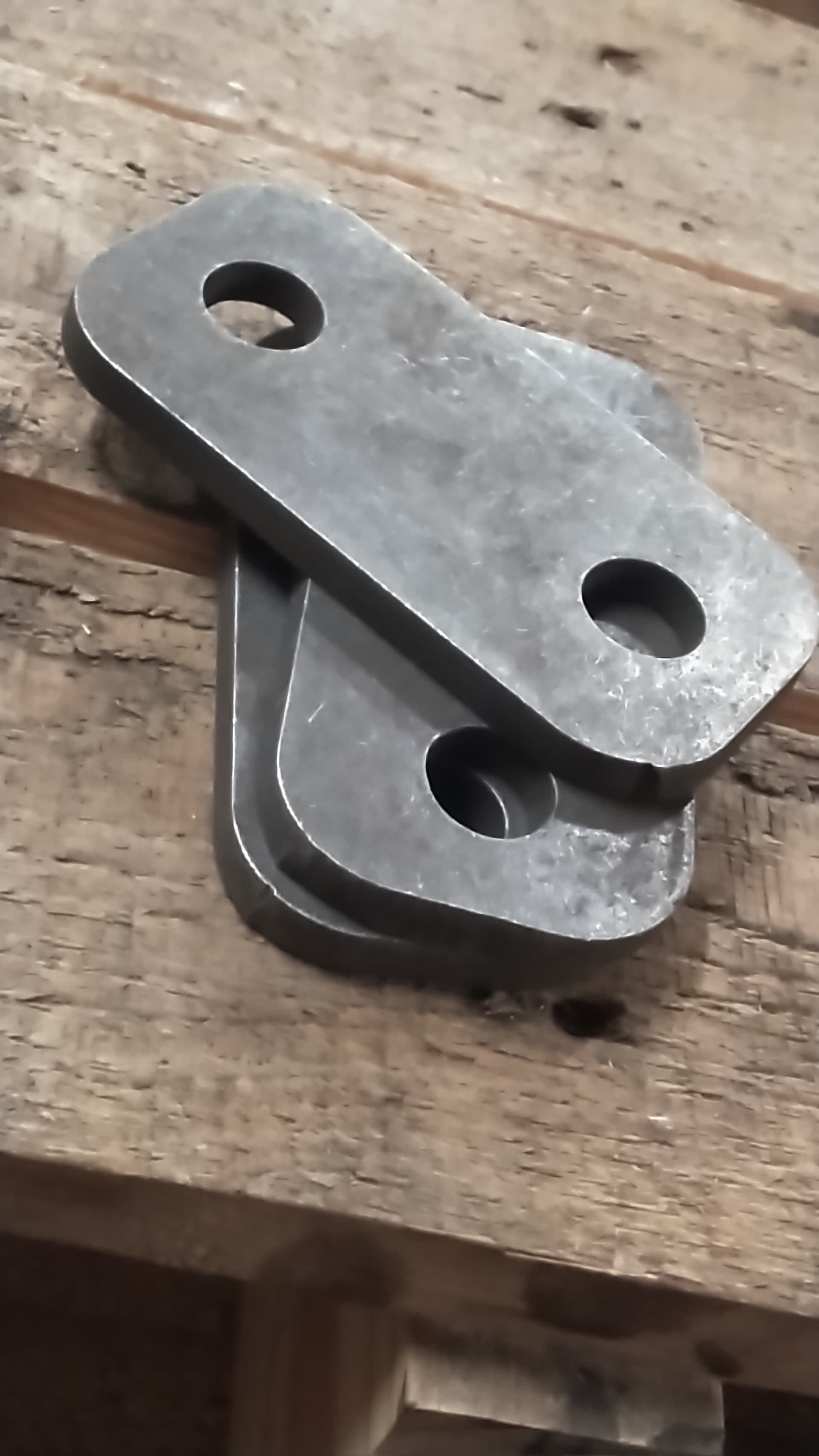

No I do kinda production runs on 1/4. I get 1500 plus pierces dot sure exactly cut time. I make washer for the company I work for.here is a sample picture

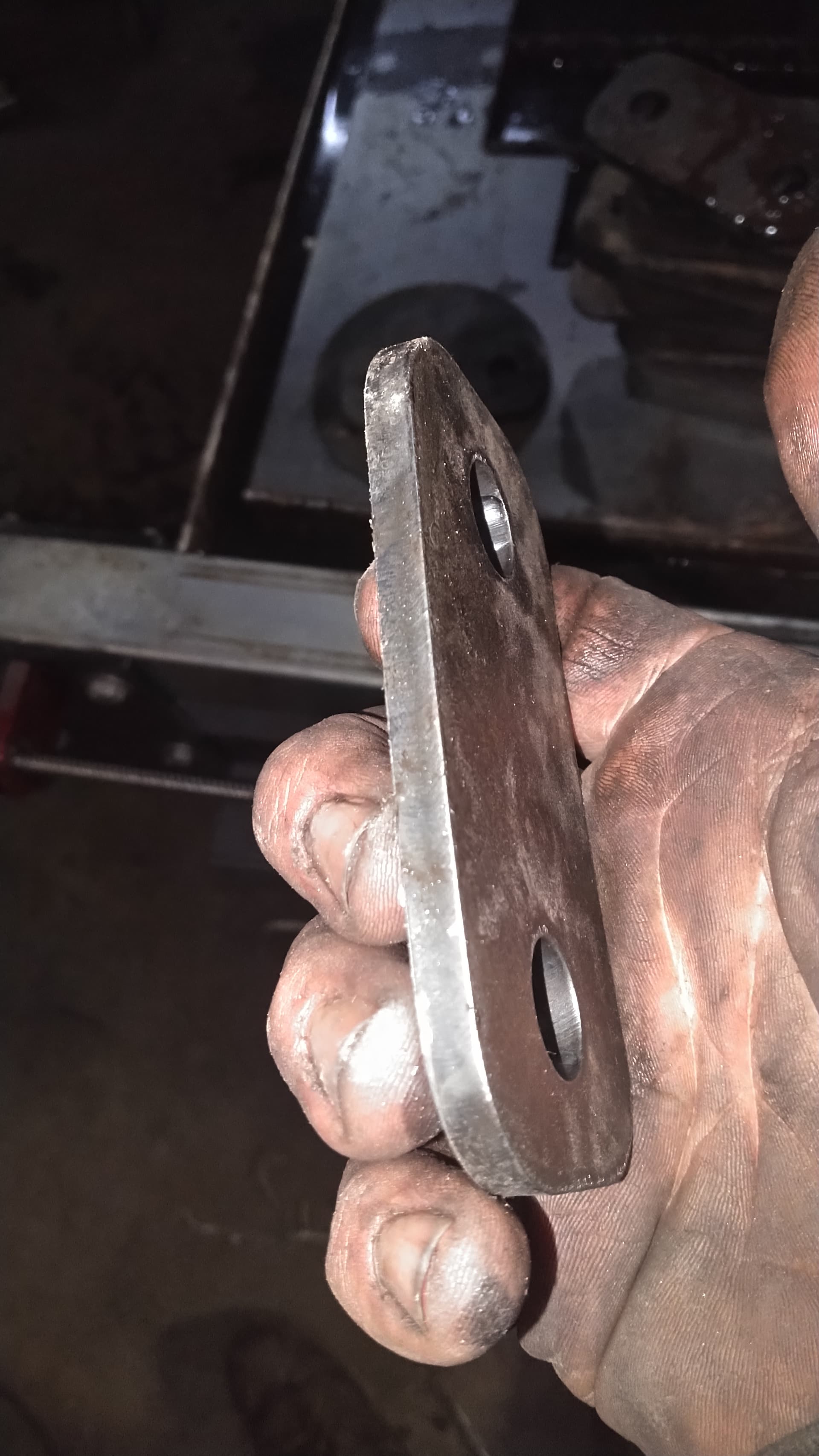

When seeing the washers you cut in 1/4 material, do you get tapered sides? Or are tapered sides not avoidable at this material thickness?

I as satisfied with the taper I get. A plasma will generally cut some sort of taper. These parts doesn’t matter other than looks.

First picture is raw off of the table. I do bulk clean up in a concrete mixer using the waste from the holes as tumbling media.

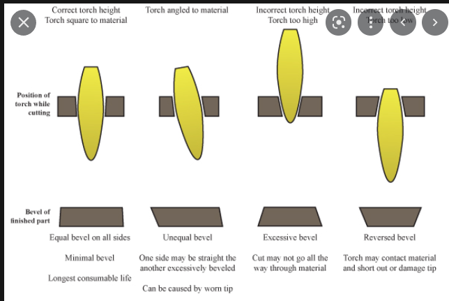

@bender most common issues with bevel are the follwoing…
  • torch is to high or to low…see picture…
  • wrong direction of travel for torch…inside cuts work best with clockwise cut direction…outside works best with outside cuts…
  • also is your torch square to the table,

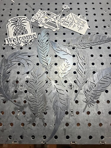

Everything I’ve cut so far with new torch/plasma machine. No jagged edges anywhere, couple learning mistakes, but nothing that isn’t my fault. I’m officially comfortable saying this is solved. Usually I’d get jagged edges on every other cut.
